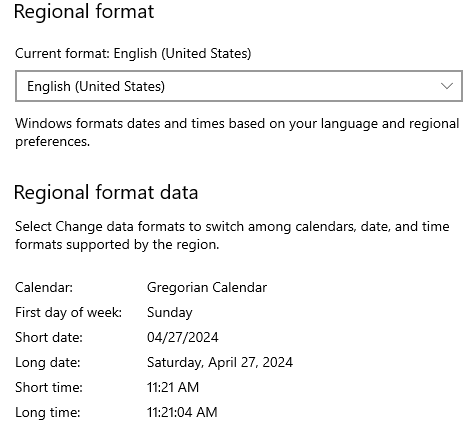

On my Server PC (which houses my media collection and has the installation of My Movies with the API Key I specify/use in CCC on my Desktop PC) I did the following:
Changed the Regional Format to English (US). Set the Short Date to 04/27/2024
Verified that Collection Management showed the Disc Release date as MM/DD/YYYY and then Rebooted the server.
