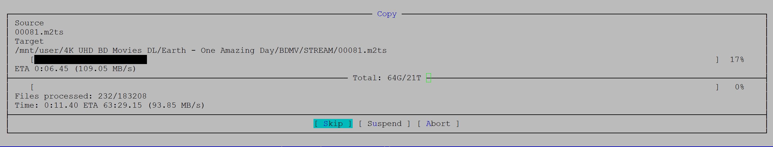

Yes, definitely running with MC, and Paul's help has been invaluable :)
I've just started the migration for the rest of the main share (32TB). MC is predicting over 62 hours, but I reckon it will be a bit less because he's still averaging under 100MB/s as it's just started, it should adjust this under 60 hours once its average has caught up to 110MB/s minimum.
