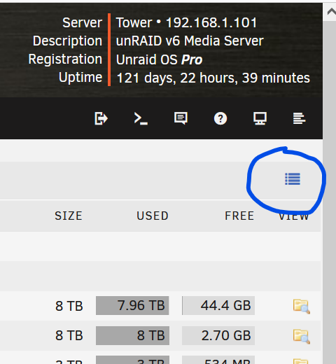

Manni wrote: Thu Jan 20, 2022 5:26 pm 4) Optional, but reset the stats that way you'll see more easily what happens in real-time during the next step (you'll see which disk is being read and the cache being written).
You can also just toggle the stats view between reads/writes and throughput:

Thanks, nice to be able to toggle between R/W and speed. I was only suggesting to reset the stats because it makes it easier to see where there is activity, but I guess using speed is nicer anyway, so I'll use that.

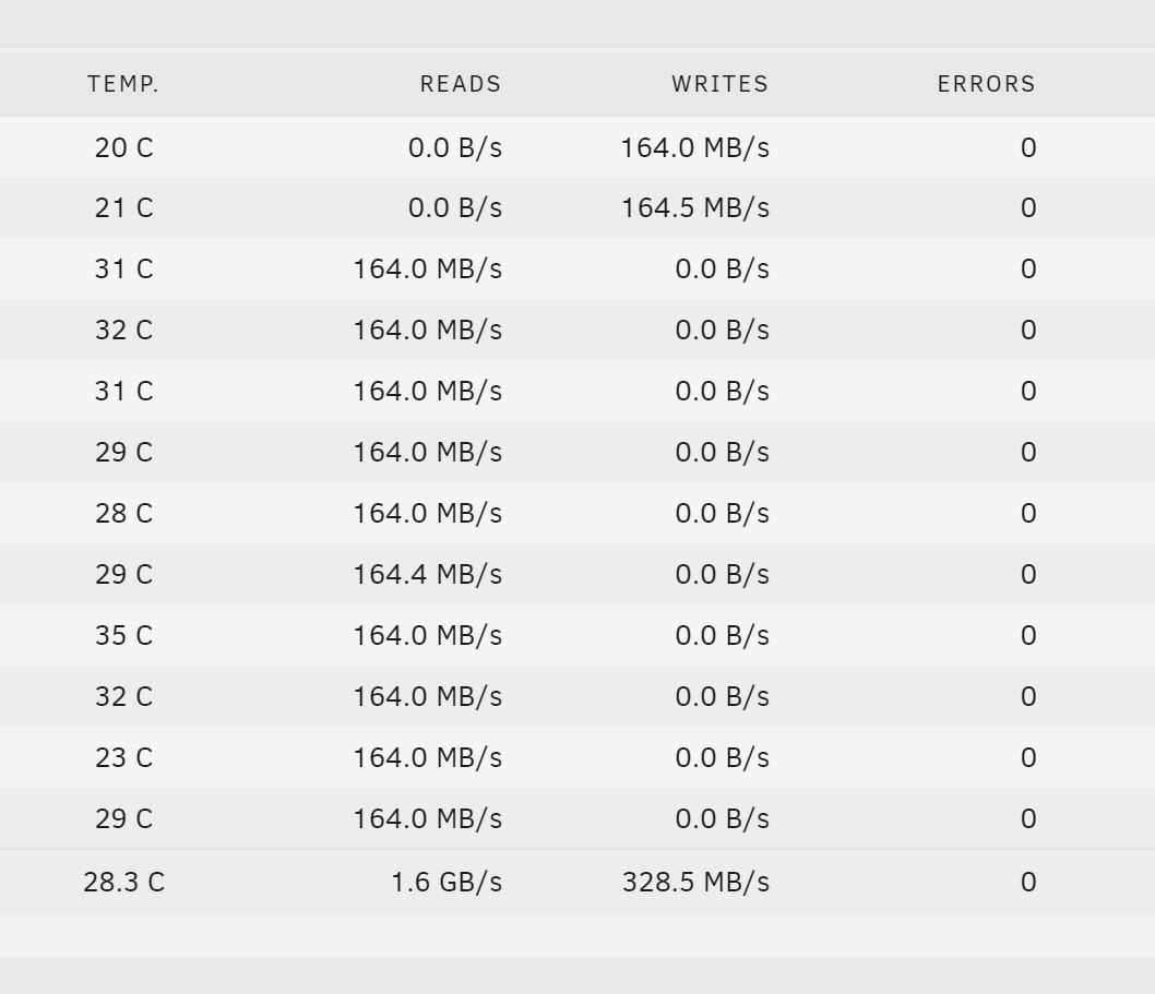

Parity rebuild has started with the two parity drives. As expected, nice to see that there is no performance bottleneck, a nice 1.6GB/s for the 10 drives with 160MB/s per drive. Even with 16 drives, there wouldn't be any bottleneck as we'd be under 4GB/s, the max for this board being 6GB/s. So happy with the 9201-16i for now, especially as all the drives go to sleep now.
The 9305-24i has a 12GB/s bandwidth, so I certainly won't reach that even with 24 drives.

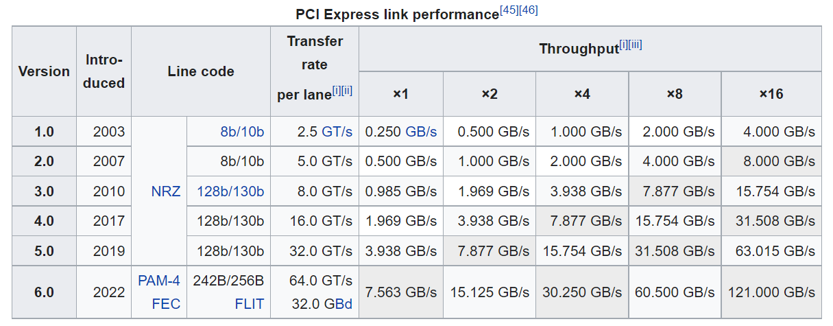

Manni wrote: Thu Jan 20, 2022 8:28 pm The 9305-24i has a 12GB/s bandwidth, so I certainly won't reach that even with 24 drives.
I don't believe that is correct. The 9305-24i has a PCIe 3.0 x 8 connection. Should max out just under 8GB/s:
But your point is still valid, even 24 HDD's won't max that out, as that permits 333 MB/s per drive.

Manni wrote: Fri Jan 21, 2022 1:46 pm They advertise the bandwidth as 12GB/s (that's the official specs)
12 Gb/s SAS-3, not 12 GB/s, so 1.5 GB/s. This is the max speed per SAS-3 drive, but you won't get anywhere near that with the SATA based drives you'll be using. And even if you did have SAS-3 drives, you could only achieve this throughput on up to 4 of them at any one time, before hitting bottlenecks.
Manni wrote: Fri Jan 21, 2022 1:46 pm Anyway, I was using the 12GB/s moniker because the "lower" models are advertised for 6GB/s.
6 Gb/s, not GB/s. Case is important. There are 8 bits in a byte, so 1 GigaBytes/s = 8 Gigabits/s.
It's a ridiculous nomenclature, they really should have used different letters instead of different case to distinguish between (b)its and (B)ytes. Manufacturers seem to enjoy playing this up, though, often touting Gb/s because they can use 8x higher numbers.
To add to the confusion, there are also GibiBytes (GiB) and Gibibits (Gbits), which are very similar, but binary 1024-based instead of metric 1000-based. At least these are more clear, GiB and Gbits are case insensitive, but they look like alternate spellings and typos of GB and Gb, which they are not.
Probably more than you ever wanted to know...
Manni wrote: Fri Jan 21, 2022 1:46 pm However the actual throughput seems to be 6400MB/s, so below the max bandwidth of PCI 3.0 8x:
I wonder if they factored in overhead. A 20% overhead would drop your 8 GB/s down to 6.4GB/s, and from recollection that sounds about right for SAS/SATA.
