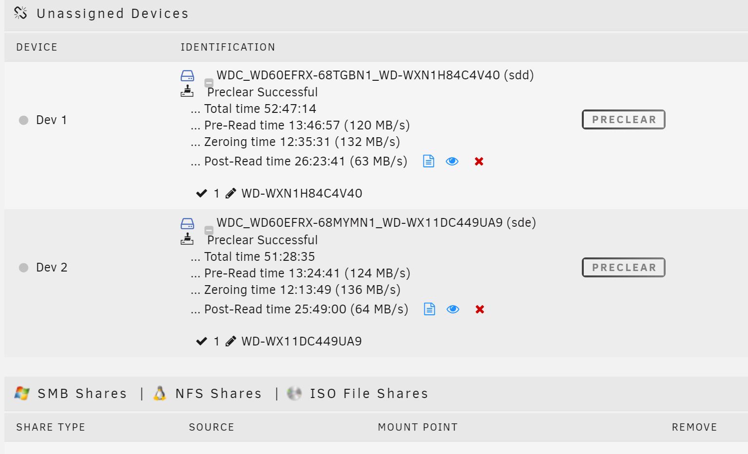

Happy to report that the second Unraid server with the 9305-24i seems to be working fine. I was able to complete two pre-clear on two WD Red 6TB using Joe's script, so this confirm that the issue was due to the fact that the S3 plugin wasn't taking into account the unassigned devices.
I have a weird performance issue though, which is that the post-read it done at half the speed as the pre-read, and I'm not sure why. There is nothing running on that server (no VM, no docker, no share being used) so I don't see why it should pre-read at 124MB/s and post-read at 64MB/s, for both disks.:

Manni wrote: Sun Jan 23, 2022 8:06 pm I don't see why it should pre-read at 124MB/s and post-read at 64MB/s, for both disks.:
From recollection, that's normal. Remember, Joe's script is designed to give your drives a workout, not complete as fast as possible. I think he does something different on the post read.

You're right about the post-read, I think the script checks if the zeros written during the clear are all there, which probably slows it down. I've started the pre-clear of the next two discs and I've selected "fast post-read" in the plugin, so we'll see what the difference is. I'll post the results here.
