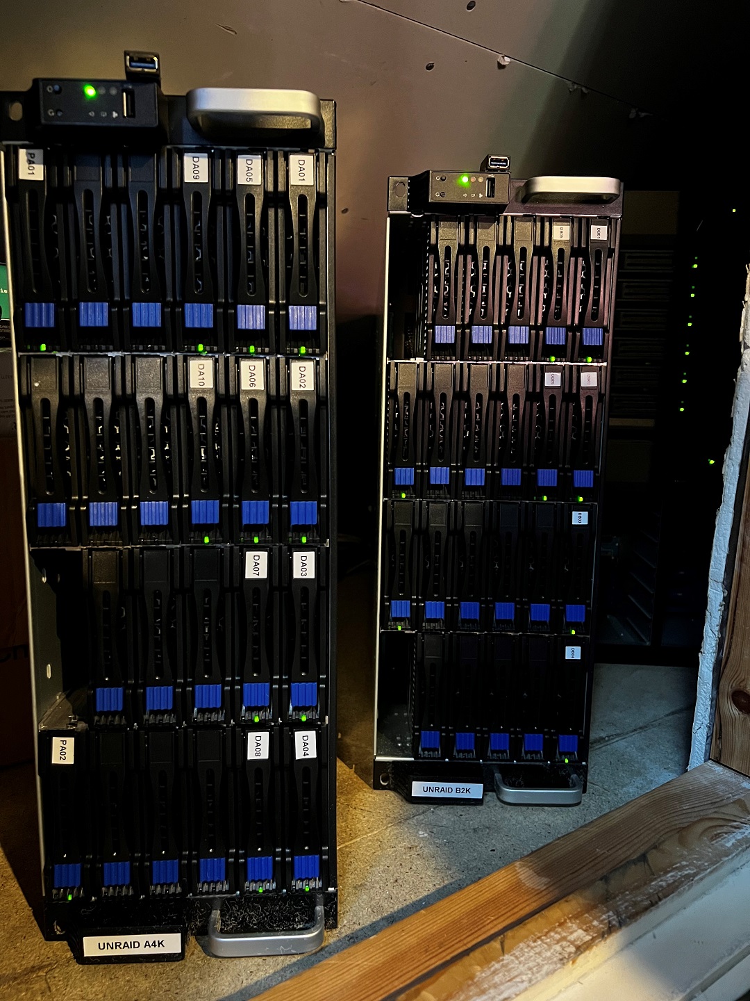

I just wanted to update the thread because I finally received my case and was able to build my Unraid server properly. In fact, I decided to build two, because I found two cases at a decent price.
Here are the beasts:

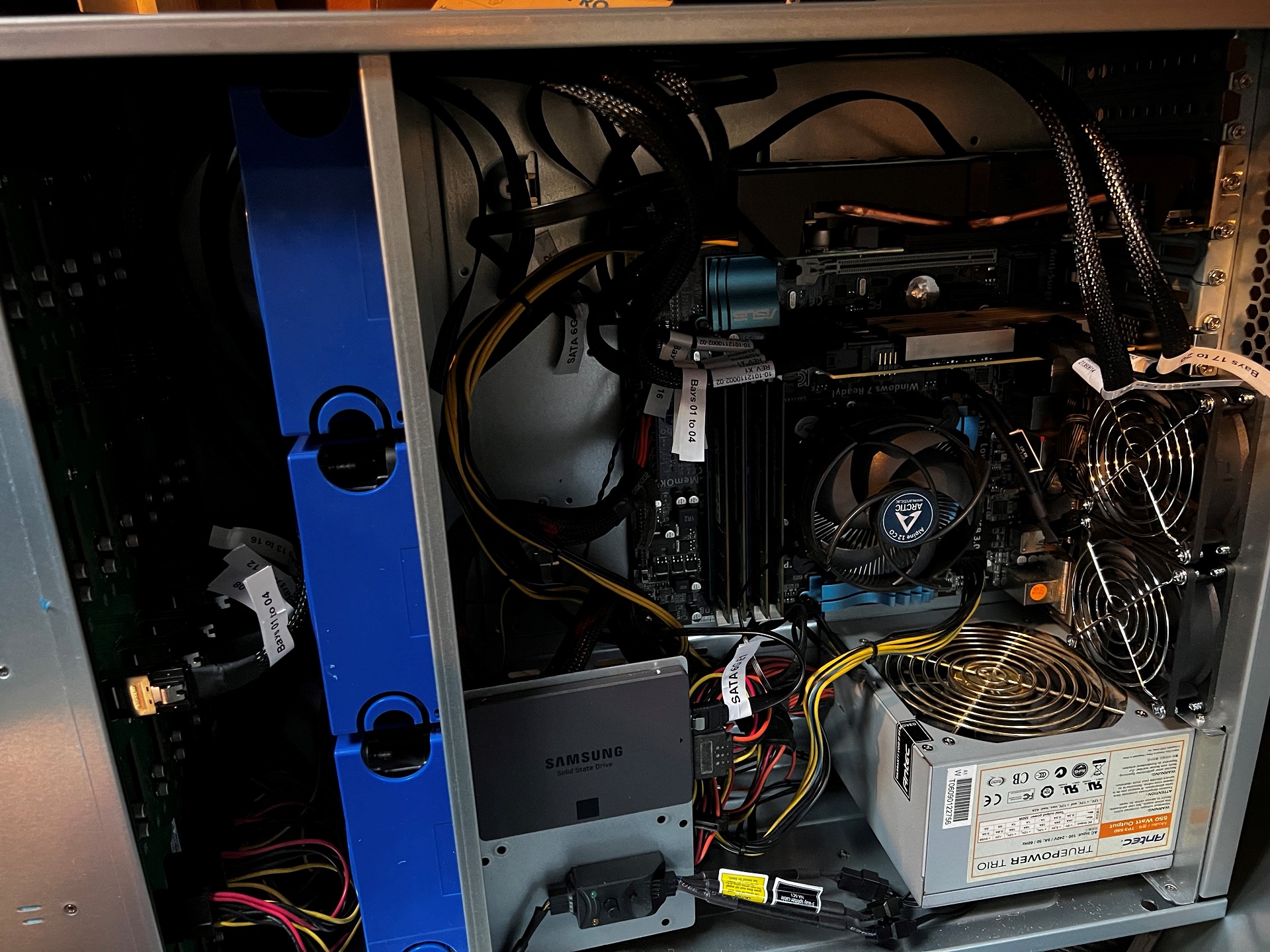

On the left is the server for all my 4K disks, hence called UNR-A4K. That's the 3770K with 16GB RAM, and where I put my Windows VM. That's the one I care about most. It has an LSI 16-port and an 8-port adapters, so 24-port in total. For now I'm only using the 16-port with data disks (I'll try to stay around 14 disks if I can for now) and the 8-port adapter for the two parity disks. Here's the inside:
Inside UNR-A4K.jpg (788.99 KiB) Viewed 8902 times

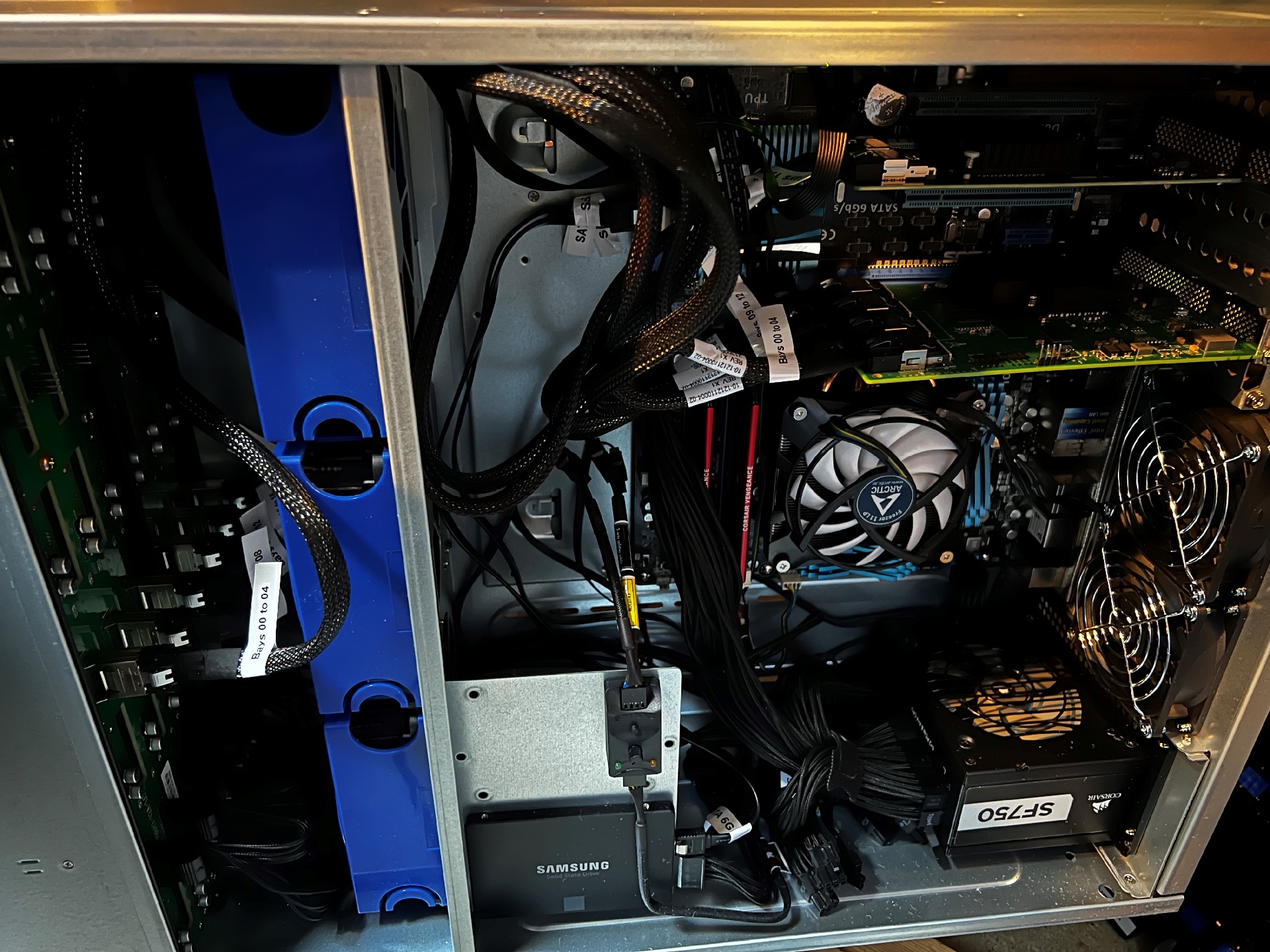

On the right is my server for all my 2K disks, hence the UNR-B2K moniker. It's the 2500K with 16GB RAM. That one has the 9305-24i, also 24-port. Currently I only have 6 drives and no parity as I'm moving content to it, but I plan to have 18-20 data drives and two parity drives when everything is there. No VM, though I could. Here is the inside:
Inside UNR-B2K.jpg (802.48 KiB) Viewed 8902 times
I have a 1TB cache SSD in both. I've also added a Noctua controller to adjust the speed of the chassis fans, because they made as much noise as a jet. Most of the time I need them at about 2/3 of the speed. I also moved the GPU to the slowest PCI slot, that way I can have two controllers in each server both at PCI 2.0 8X. At some point I'll upgrade the B server to PCI 3.0 to lift the PCI bottleneck, but 170MB/s is fine for now. The A server maxes at 250 MB/s for all drives, which is plenty for my drives.
I've also installed a USB 3.0 extension on each so that I can connect both a USB 2.0 and USB 3.0 from the front. Handy if I need to connect an external USB 3.0 drive for example.

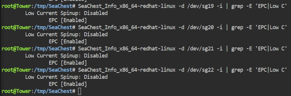

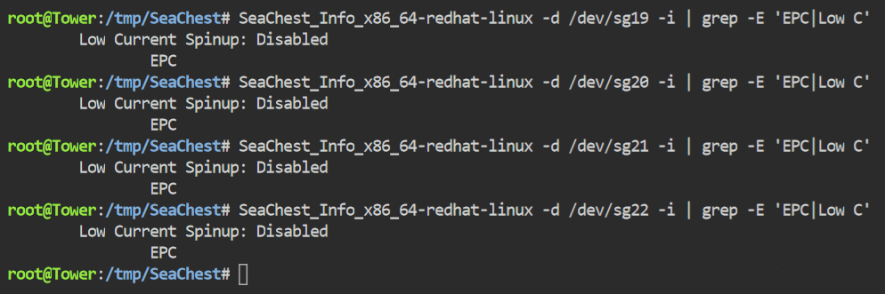

I have 4 Seagate Exos drives, ST8000NM0055-1RM112, installed, drive letters sdt, sdu, sdv, sdw. I used sg_map at the command line to figure out that these correspond to sg19, sg20, sg21, and sg22.
I ran:
SeaChest_Info_x86_64-redhat-linux -d /dev/sg19 -i | grep -E 'EPC|Low C'
to check how sg19 was configured, and repeated on sg20-22:
The guide mentioned that Low Current Spinup should be disabled, but that they weren't sure if it was a required change. Mine were already disabled. EPC was definitely on, so that's my target.

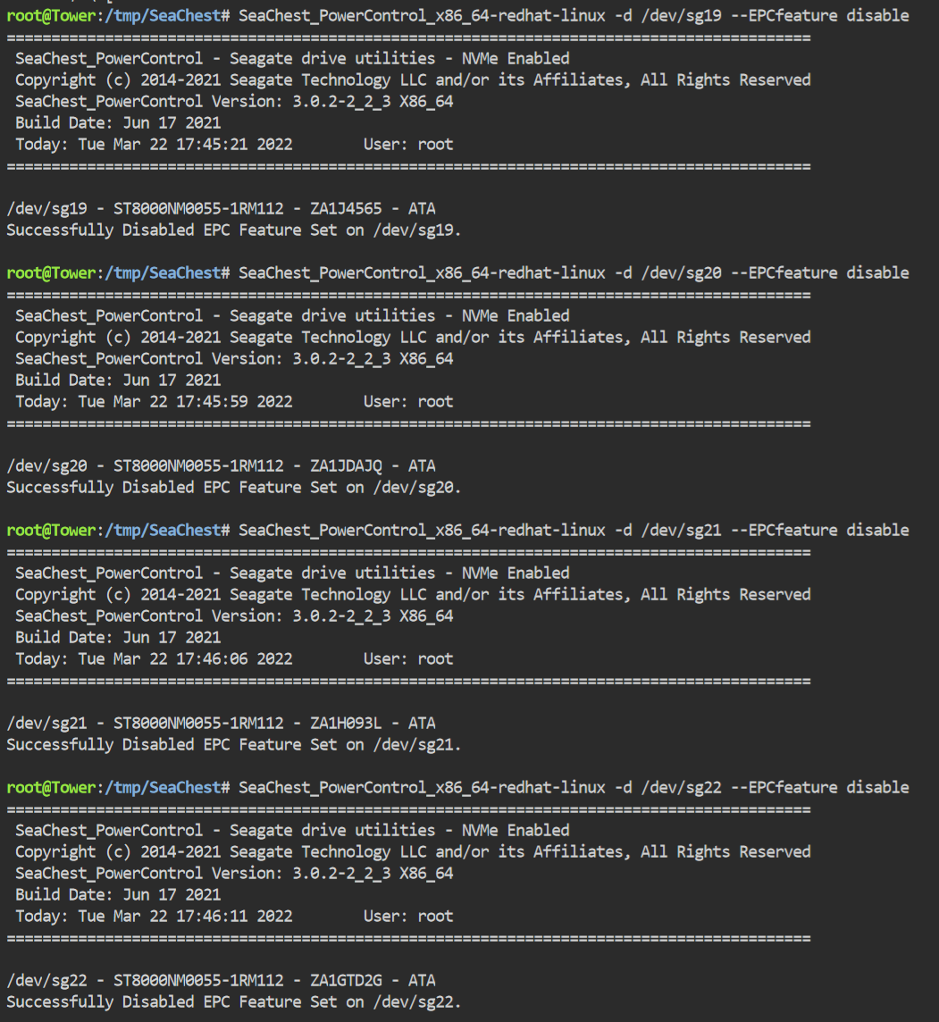

I ran:
SeaChest_PowerControl_x86_64-redhat-linux -d /dev/sg19 --EPCfeature disable
to disable EPC on sg19, and repeated on sg20-22:
I used SeaChest_Info again to check the status, and it looks like everything is working so far, EPC no longer shows [Enabled]:

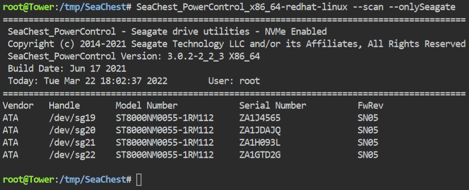

While I was here, I decided to check the firmware of these four drives. All had the same firmware, SN05, and checking Seagate's website I discovered that this was the latest firmware version (almost 4 years old now). I guess I had hoped that perhaps a newer firmware was available that fixed a major bug, but I'm not really surprised at the lack of firmware updates, as I've never heard of anyone updating HD firmware before.
Note that while doing this, I came across a nice command that made it easy to see all of my Seagate drive info at once:
SeaChest_PowerControl_x86_64-redhat-linux --scan --onlySeagate

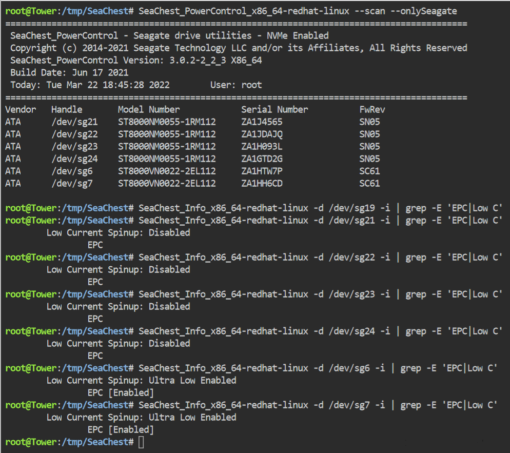

The next step was to shut down the server - completely turning off the power. I let the server have a few minutes of peaceful rest to let the last of the electrons dissipate. Then I powered back on, and during boot up I inserted a couple more pre-cleared Segate drives to see if they needed update.
Once Unraid was back up and running, I repeated the first few steps to run the SeaChest_Info tool again to verify EPC and Low Current Spinup both remained disabled. A minor curveball, the two new drives I had installed changed the sg## values for the all the drives, so I had to grab the new numbers to check the values.
Sure enough, the four drives I had updated still had Low Current Spinup and EPC disabled, yay! The two new drives are a different model, but one I recognize from the Unraid forum thread, so I know it's problematic too, so I decided to go ahead and update them.
I left Low Current Spinup alone, as other users have commented it doesn't seem to make a difference, and only disabled EPC.
