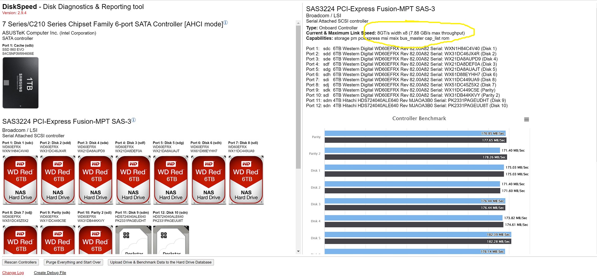

By the way I highly recommend the Speed Disk docker, which can benchmark the speed of individual disks and of the controller, and also detects if the current link is optimal or not. For example, the link with PCI 2.0 was 4GB/s, now I get the full 7.8GB/s:
Disk Speed.JPG (463.64 KiB) Viewed 12538 times
Anyway, I now have a single LSI adapter in my main server, and here is the power use I get after these changes:

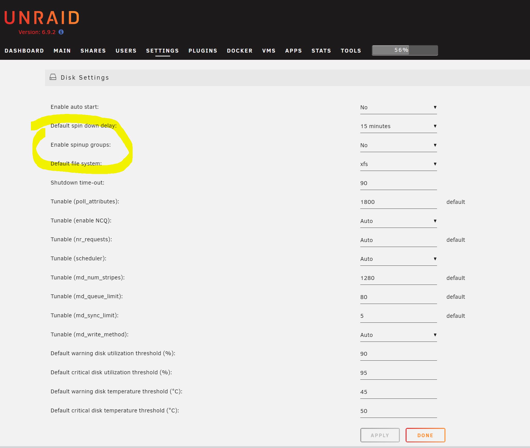

You could probably use your nano-PSU if you define spin-up groups in your disk settings, that way all the drives won't spin up at the same time:
Disk settings.JPG (162.15 KiB) Viewed 12523 times
Easy to try with your current PSU and measure your peak load.

Manni wrote: Fri Mar 25, 2022 4:24 pm You could probably use your nano-PSU if you define spin-up groups in your disk settings, that way all the drives won't spin up at the same time:
From my understanding, that's not what spin-up groups do. Spin-up groups ensure that when 1 drive in a group spins up, all drives in that group spin up. Some have a need for this, but I never found a use for it.
What is needed is a staggered spin-up option, which doesn't exist. When I power on my server, the controller does a staggered spin-up. But when Unraid is running and all drives are asleep, starting a parity check immediately spins up all drives at the same time. Worst case is when the CPU is already heavily loaded from VM activity and a parity check starts.
6-8 years ago I engaged in a discussion on this on the Unraid forums, around the time spin-up groups were introduced. We asked for staggered, but never got it. I could go with a significantly smaller and more efficient PSU if Unraid had staggered spin-up. Seems like such a simple thing to program too.
