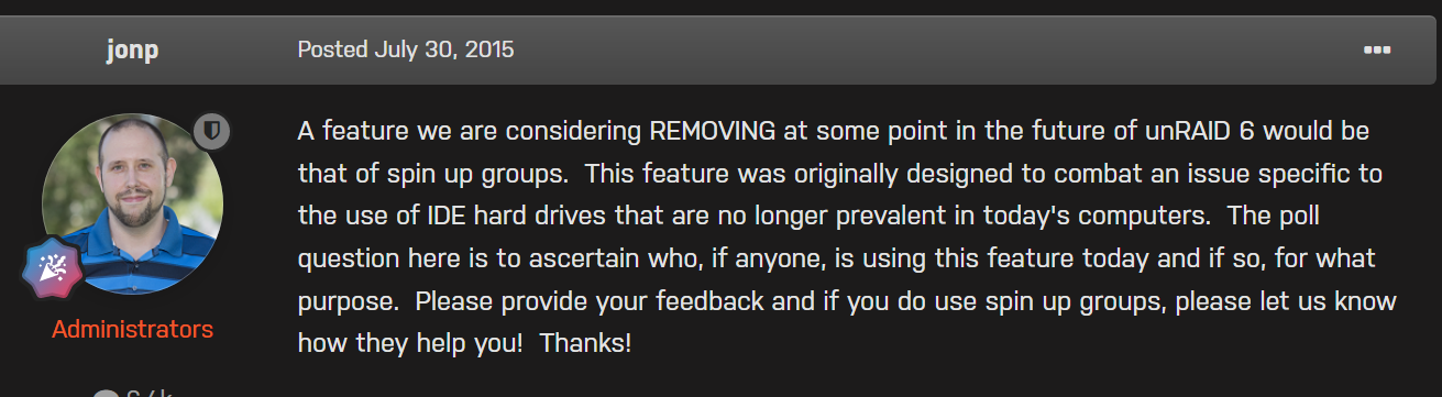

Thanks, it never occurred to me that this didn't mean staggered. Pretty much pointless option as it is then.
Post by Pauven » Fri Mar 25, 2022 4:49 pm
You're not the only one that thinks it's pointless:
It obviously never got removed. Kind of interesting to read some of the use cases people shared that justified its continued existence:
