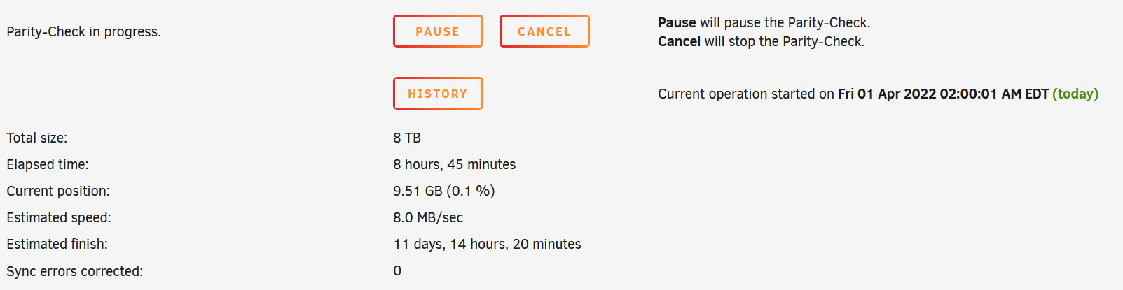

Post by Pauven » Fri Apr 01, 2022 10:52 am
Well, looks like I was a bit too ambitious in my early proclamations of success.
I guess Unraid decided to make an April's Fool of me. It's been running almost 9 hours, and hasn't moved at all in the past couple of hours. It obviously got stuck right at the beginning.
This is just when I first experienced these issues on 6.9.x last year. Back then, the entire GUI would hang in addition to the parity check. This time, the GUI is still mostly responsive, but doesn't show current data. It indicates that drives are all spun up, but drive temps are cool. CPU and MB temps seems frozen, along with fan speeds. The Dashboard doesn't show any info at all. Perhaps only the GUI is not working, not sure if the parity check is still running or not. Need to do some research...
Post by Manni » Fri Apr 01, 2022 12:56 pm
Sorry to hear about that. I had something similar last night, but not during parity sync (that works fine, always), during pre-clear of six disks. I've uninstalled the fine-tune pre-clear plugin, and I'm going to try again. That used to work fine, so not sure what happened, but I had no access at all to the box (GUI, putty) yet the disks being resynced were being written to according to the LEDs. I always ask for an update every 25% of each step (highly recommended) so I let it run for a while, but I didn't get any update so I hard powered off, powered back on, did a parity resync (no error) and now I'm about to try again, but I'll stop the array first so that if there is any crash I don't have to resync parity again.
It's not 6.9.x though, I've been on it from the beginning and never had such an issue, except when I forgot to add unassigned devices to the S3 sleep plugin to prevent it from going to sleep during a preclear, when there was no activity on the array.
