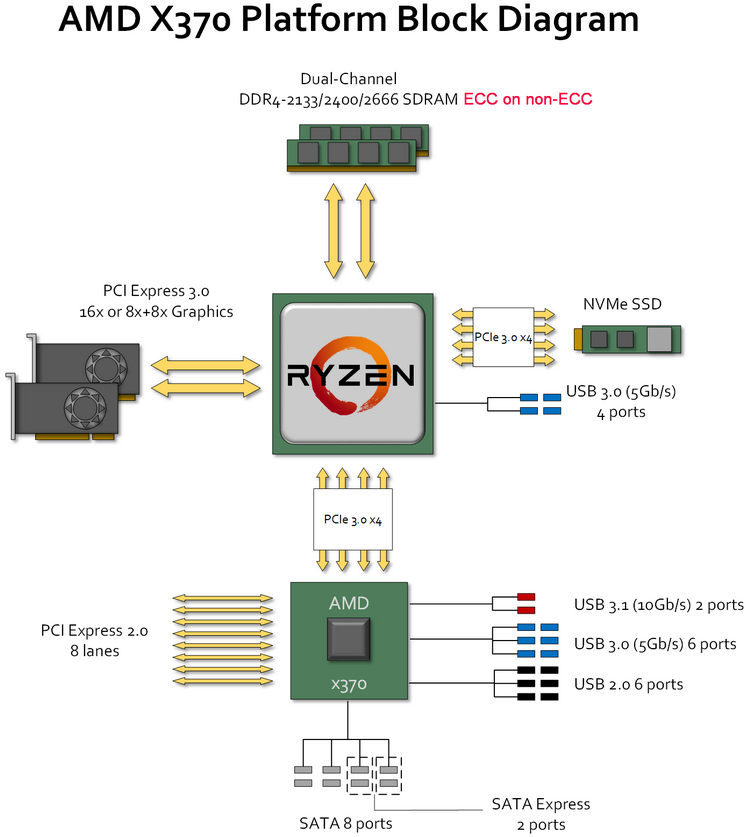

According to the block diagram below, the 9201-8i's will direct connect to the CPU via PCIe 3.0 at 8x each. My cache drive is NVMe, so that's also direct connect to the CPU.
The 8 sata ports are coming from the x370 south bridge. It has a PCIe 3.0 x4 connection, so that's plenty of bandwidth, but it's shared with other devices (USB, other PCIe slots like where my GPU is installed).
But my motherboard also has an Aquantia 5Gb Ethernet port, which I'm using, so that steals some of the bandwidth and I'm not sure from where. If I had to guess, it's using some of the PCI Express 2.0 lanes coming off the southbridge.
For the most part, I don't really see any issue, since I hardly ever use USB and the tiny GPU I have is using just PCIe 2.0 1x. And I don't typically using a lot of networking when a parity check is running. But I've never used these SATA ports before, so I don't know how well they work. Hopefully the x370 doesn't get overworked, and there's no constraints when using all 8 at the same time. I'm thinking I will reserve them for my bottom two drive bay rows. That's where I have my parity drives, but also where I usually keep those 2 open slots, so normally only 6 of 8 drives in use there, so slightly lower total bandwidth requirements.
