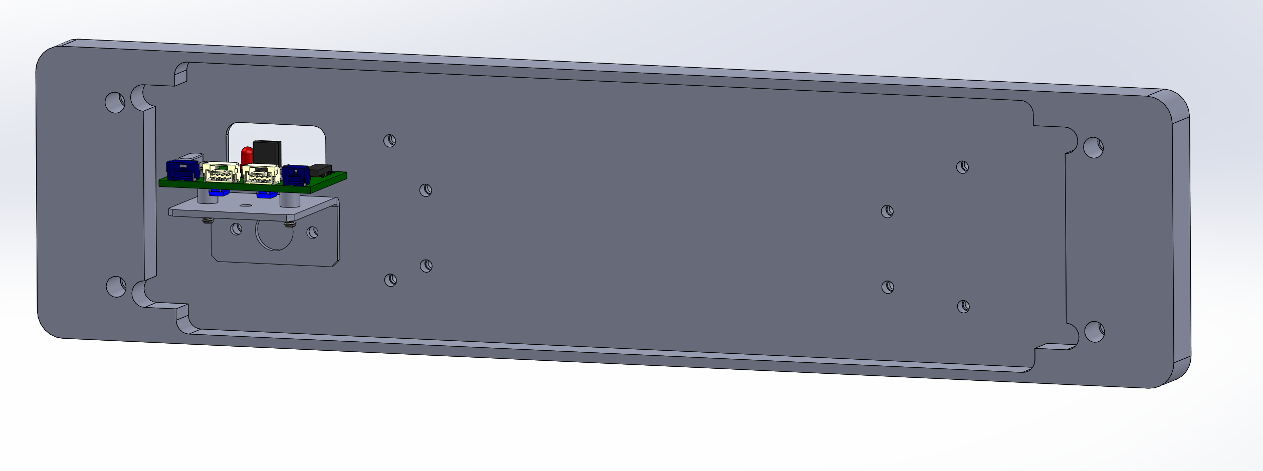

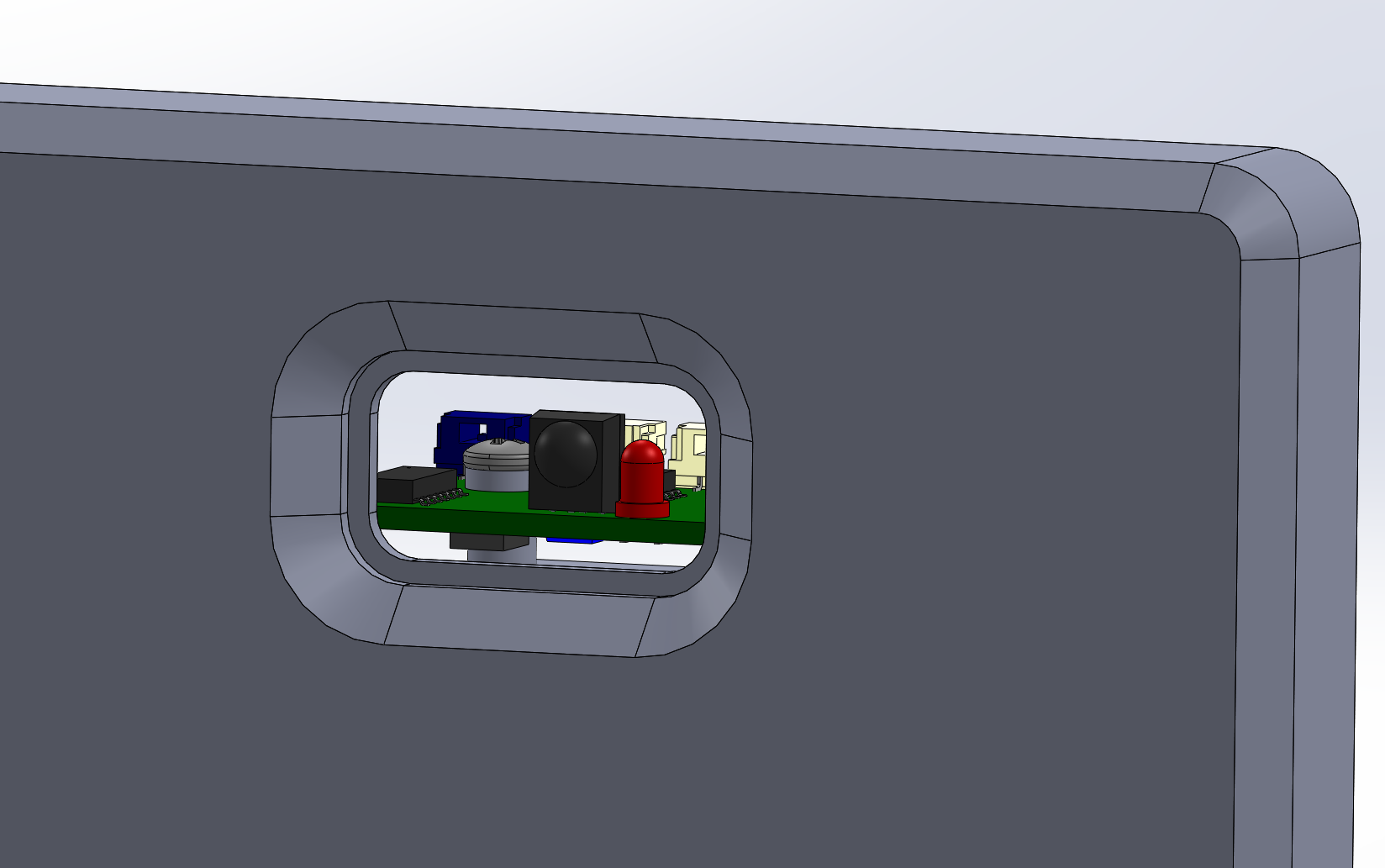

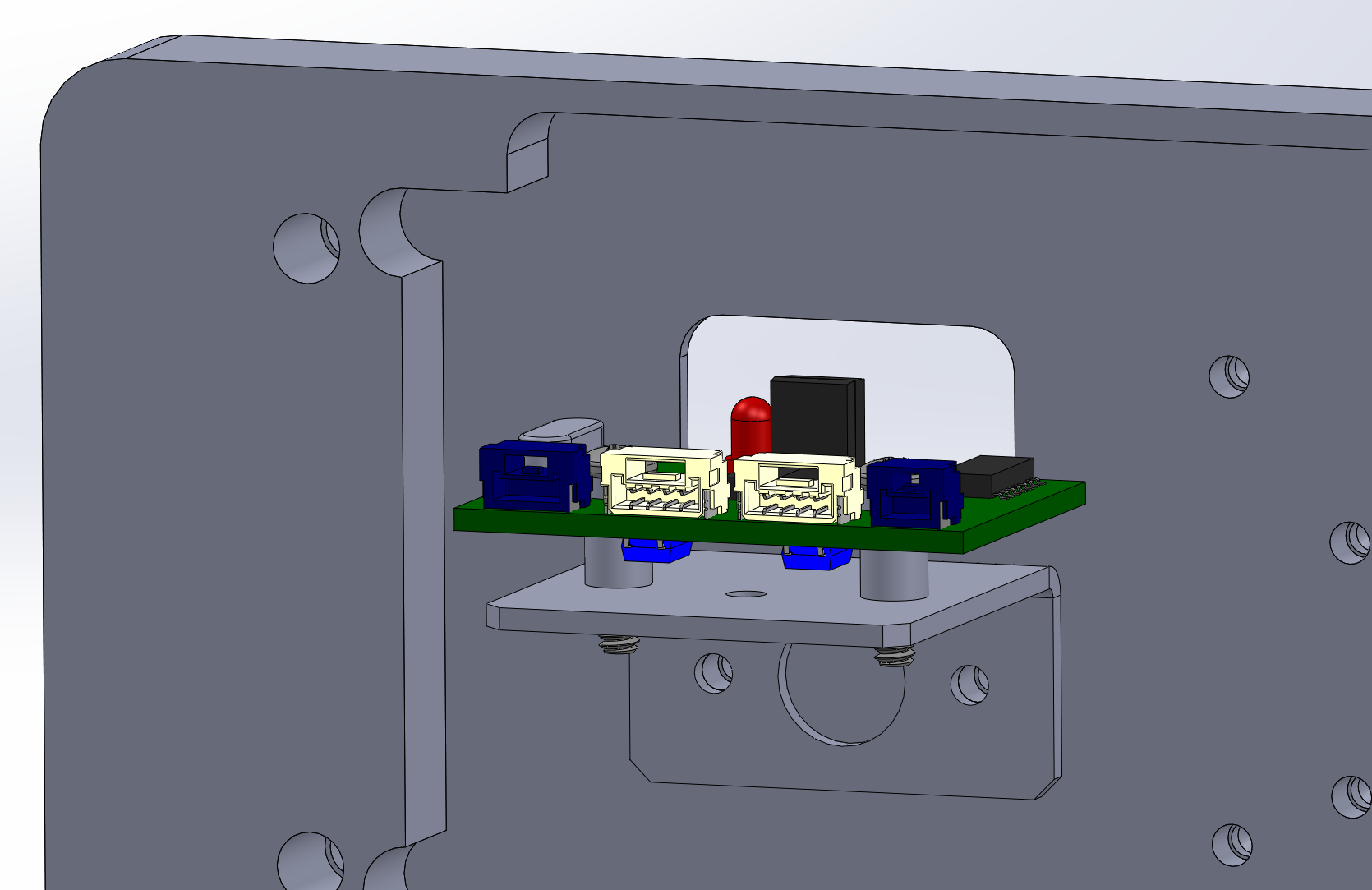

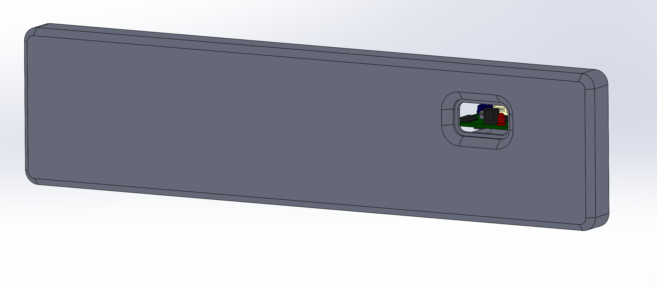

I’ve worked out a design for mounting the inteset ir board internally to the front face plate. This isn’t required for tomorrow’s upgrade as I’ll be using the Microsoft external receiver for the time being. Once it’s done I’ll be able to FINALLY get rid of that awful external receiver. The attached pic show what I’ve done so far. The features are basically there, but I haven’t nailed down its final placement yet. The features are done in context to the ir receiver board/bracket assembly. If I move that assembly, the features will follow it and not loose their definition. I measured the face plate with my measuring tools, so yes it’s very accurate. What you don’t see is the little 3/32” thick acrylic window that will cover the opening. It’s amber colored which is what I could get from McMaster Carr. I’ll probably sand the back side with very fine sand paper to lightly frost it to hide the board a little more. I’m not attached to this color, so if I find some plastic with a dark smoke tint, I’ll use that instead.

Wow, very nice modelling! What software are you using?
I guess that will work, though typically windows are made of IR plastic. That said, my HTPC has just a translucent white window (to blend in with the silver chassis), and the Inteset has worked fined through that. Just make sure that the amber acrylic is not IR filtering - that would block the IR signals.Teddyboy wrote: Fri Apr 09, 2021 2:28 pm What you don’t see is the little 3/32” thick acrylic window that will cover the opening. It’s amber colored which is what I could get from McMaster Carr.

I use Solidworks Which is a mechanical design cad application.
All acrylic is infrared transmitting, but some acrylic material is able to block uv and allow ir to pass through which tends to be a more expensive material and outside of my budget. I can’t get that material in small quantities, so that’s out. I don’t think it will be a problem, but we’ll see how it performs when I get it. We didn’t use ir material in our projects in the past due to cost, and it really didn’t appear to make any difference in performance except increase the cost.

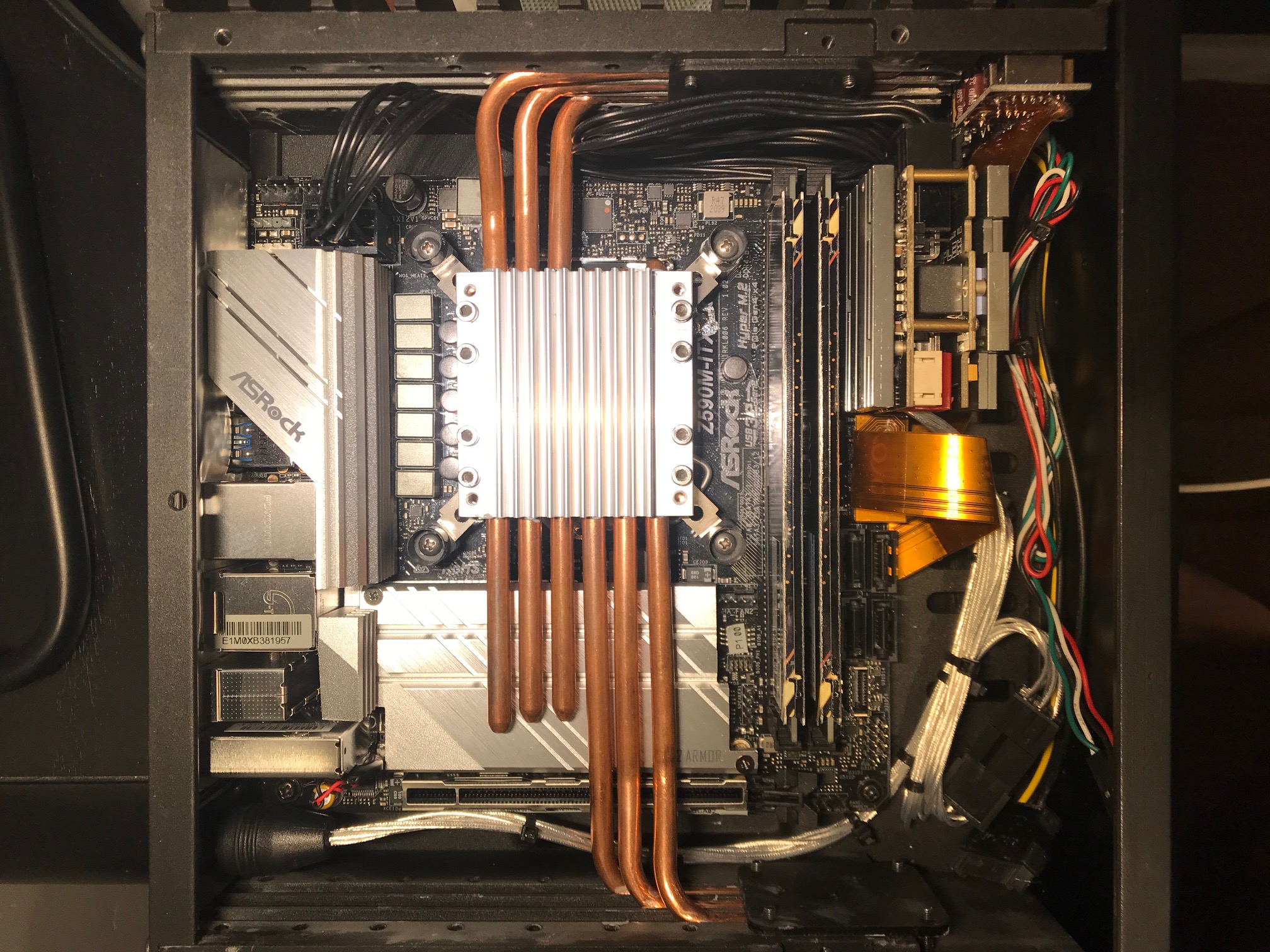

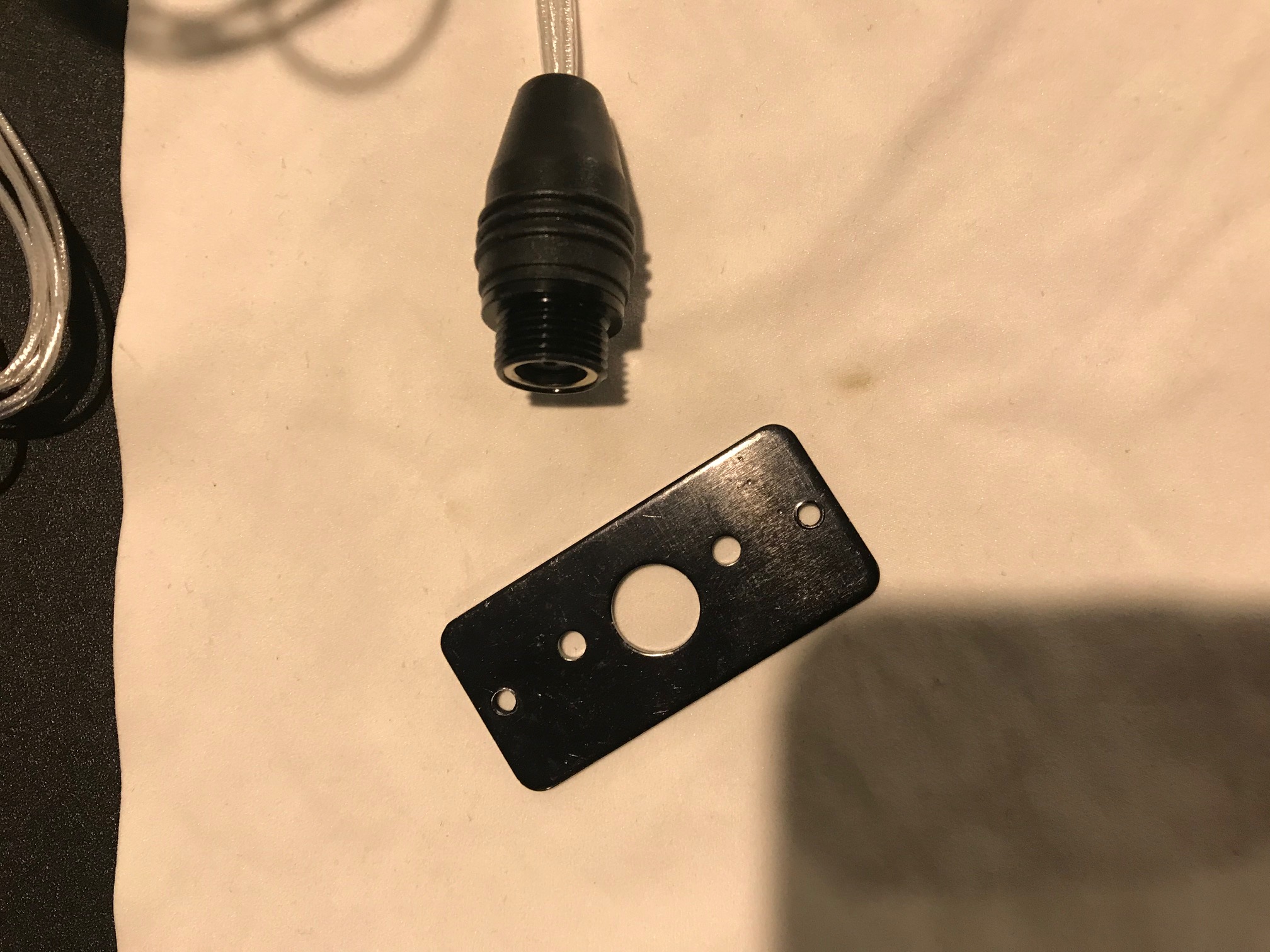

Welp! I spent part of the evening putting it together. Thermal grease just get all over the place! First snag: I made a assumption that the power supply came with the adapter plate. It actually comes with the case. So I went into my storage unit and found it. My storage it very well organized, so it didn’t take much effort to find it. I have a 1st generation case, so naturally the adapter plate doesn’t fit the plug. I drilled it out with a 1/2” drill bit and I was able to assemble it to the plate and mount it to the case.

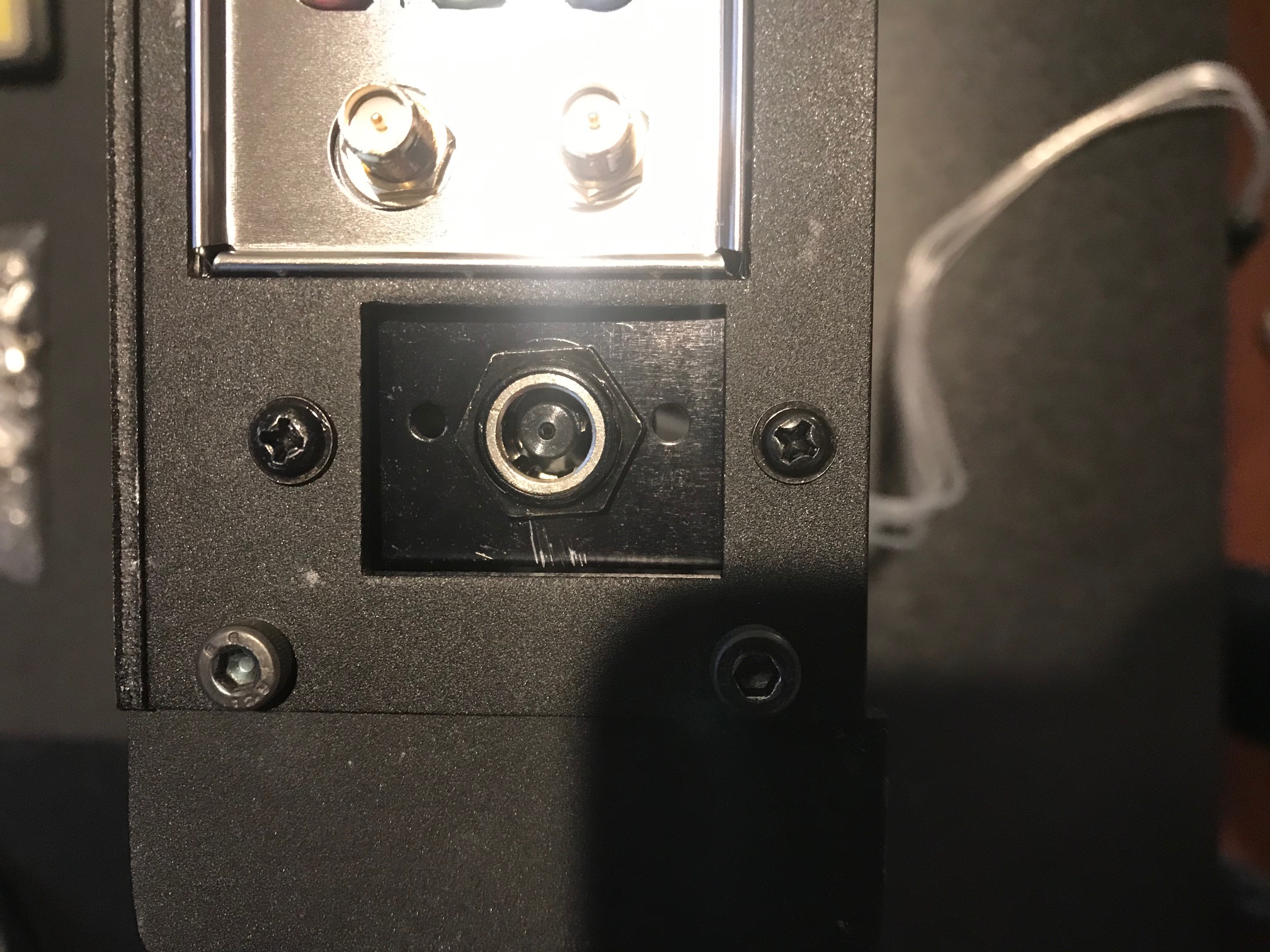

Second snag: AC power adapters jack is the wrong size! The case side female plug is 7.4x5.5mm. The power adapters jack is 5.5x2.5mm! I wasn’t paying attention because it’s stated on the hdplex website what size it is. So that goes back to Amazon and the correct one will arrive tomorrow. The new one has a additional 10 watts of power 130w vs 120w. The really should be plenty of power for the board.
