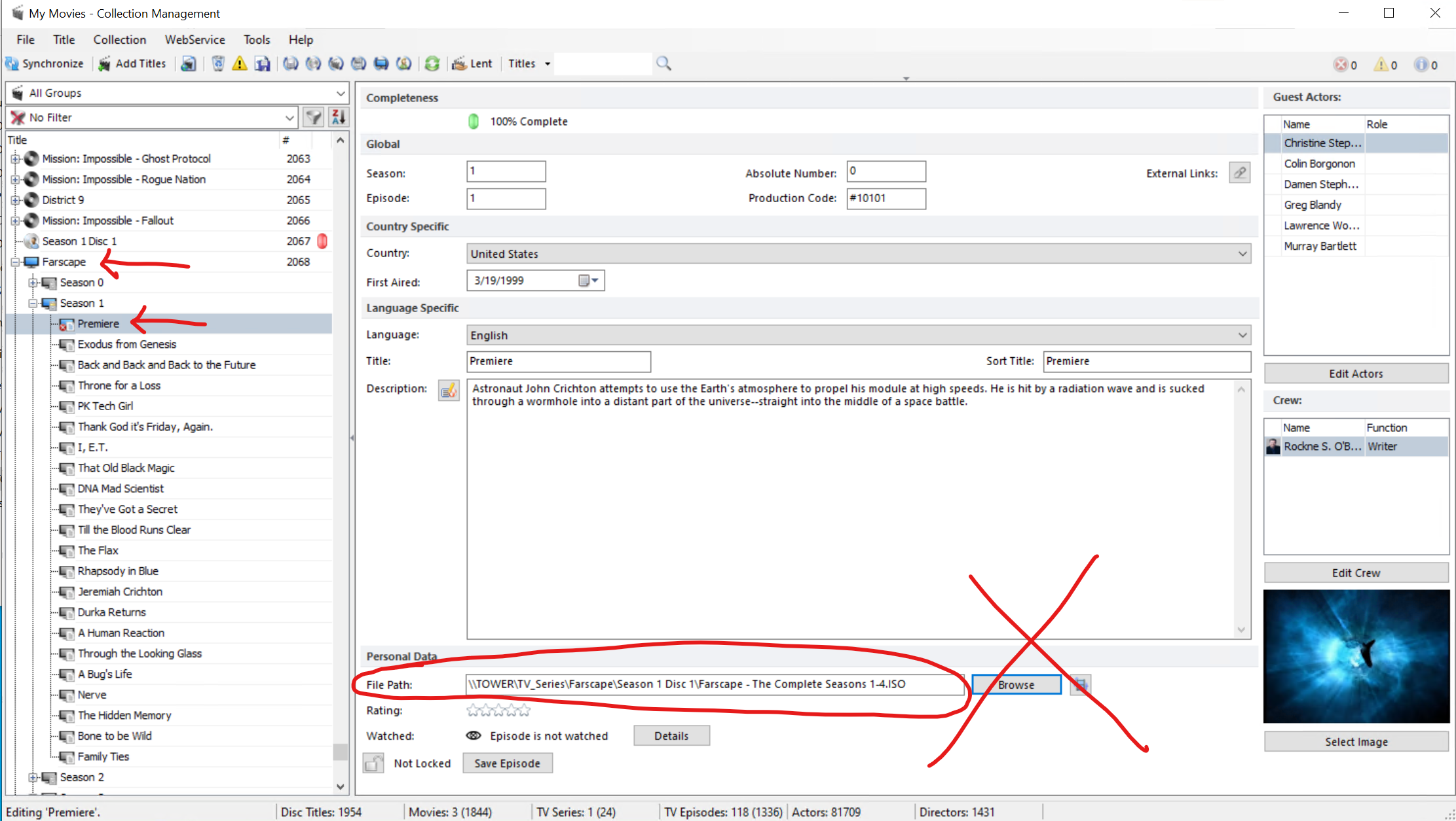

If you look in your My Movies Collection Management, I expect you will currently see something like this:
In the left tree, notice that Farscape has a TV icon beside it. This is for standalone TV Series (not disc based). I've selected S1 E1 Premiere, and in the file path I show an ISO file - THIS IS WRONG. You cannot put an ISO file here, it will not work right.

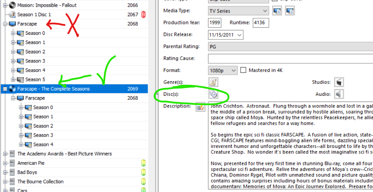

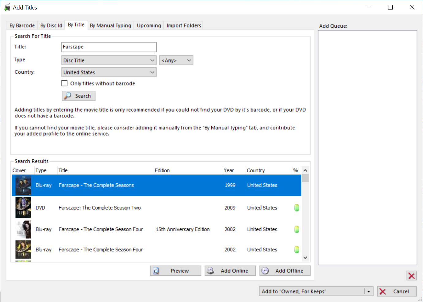

Since you have Disc ISO's, you need to delete Farscape and start over. Click Add Titles, set the "Type" to Disc Titles, and search for Farscape. Since you seem to have "The Complete Seasons", you will probably chose one of those. Add it Online, set it to the Season 1 Disc 1 folder, and Add to "Owned, For Keeps":
After it is added, you will then need to click the Disc(s) button to edit the disc locations for all your ISOs:

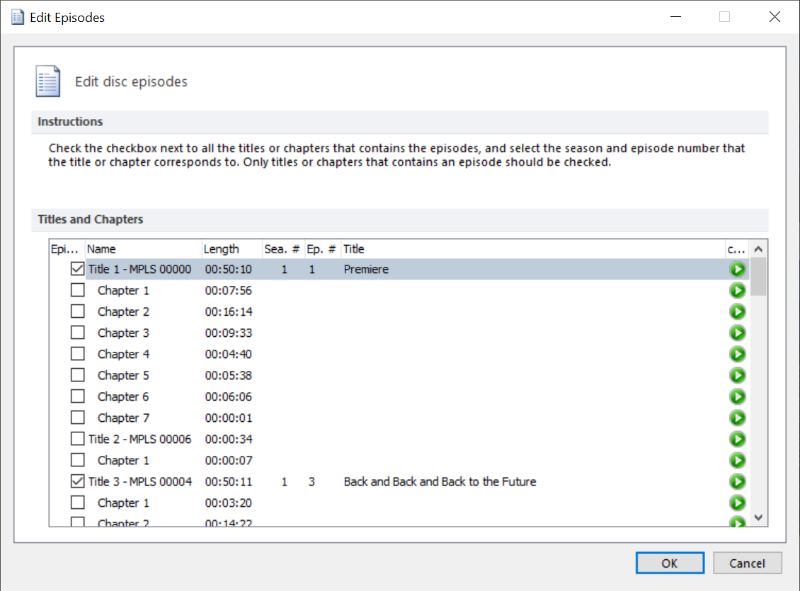

If you want to go the extra step, and have CMC play individual episodes directly off your discs, you need to select the Edit Chapters or Episodes for every disc, and make sure each episode is correctly mapped. Hopefully you have Farscape The Complete Series on Blu-ray, as someone has already contributed the episode mappings for that set:

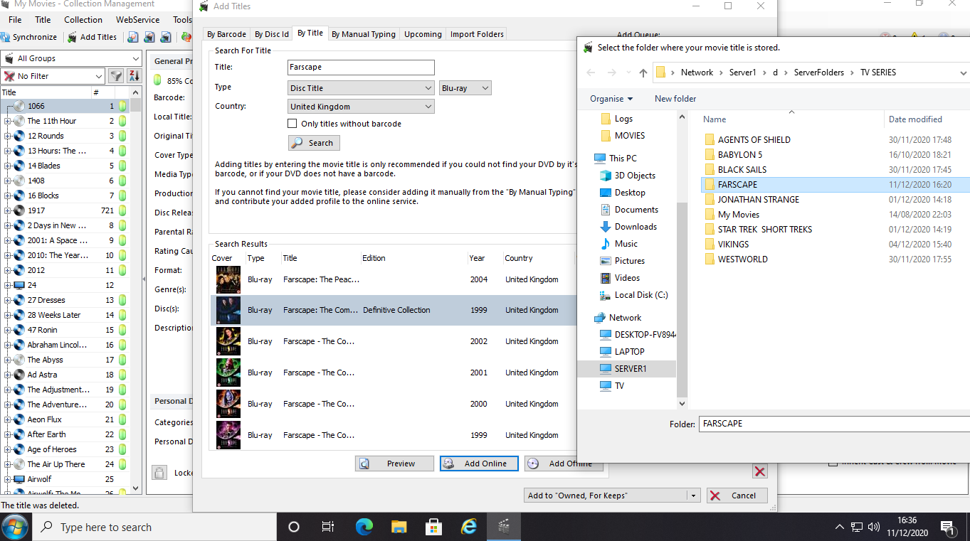

Post by ricardo8369 » Fri Dec 11, 2020 11:39 am
It won't let me do what you say, as it's asking me to add my Farscape folder.
