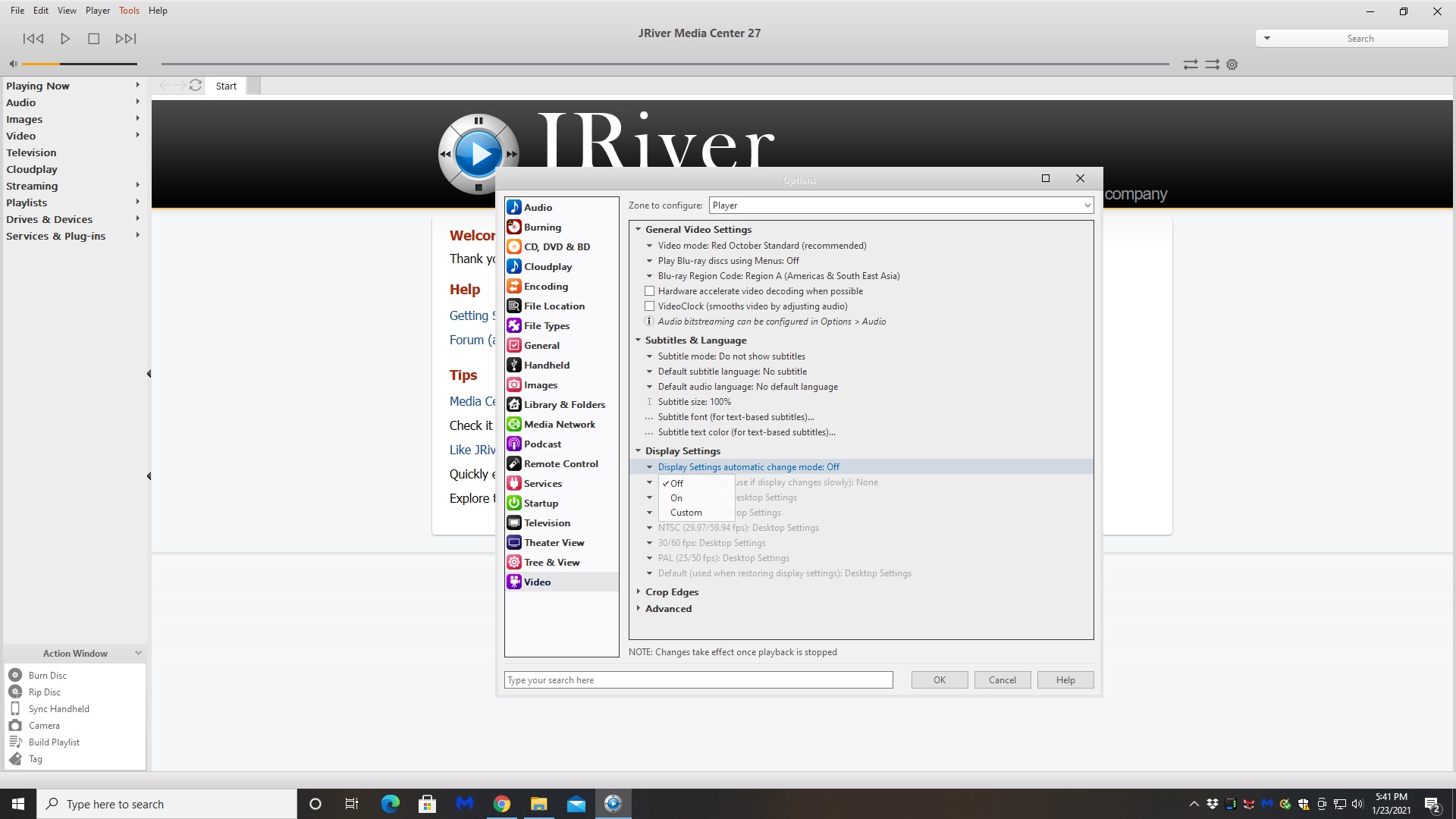

Pauven wrote: Sat Jan 23, 2021 10:56 am EDIT: Sorry, forgot that you mentioned JRiver isn't opening in full-screen. I've noticed that for certain apps, they don't open full-screen at first, but if you toggle them to full-screen, afterwards they open full-screen. Does this work for you?
Teddyboy wrote: Fri Jan 22, 2021 7:40 pm JRiver still does not go full screen. Please take a look at that to make sure that the proper command is being sent to it to make it go full screen. That's not something that I can set in the settings page.
Actually, I believe this is configured in the JRiver settings: https://wiki.jriver.com/index.php/Startup_Settings
From my recollection, other users here, like Jamie, had to configure JRiver to open fullscreen.
Also, I am setting the /Mode flag to Theater, which is what is desired according to other JRiver users like Manni. I can only set one Mode, Theater or Fullscreen, but not both. The last time I was involved in testing was for JRiver 26, I believe, and we also tested with 25. If you are on JRiver 27, or pre-25, it's possible that something is different.
Jamie/Manni, if you see this, please chime in.

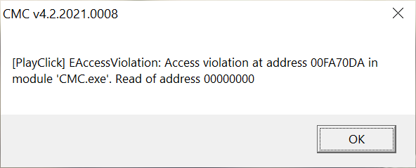

Pauven wrote: Sat Jan 23, 2021 10:47 am
Teddyboy wrote: Fri Jan 22, 2021 7:40 pm The access violation dialog box is not technically a CMC error. It’s actually just complaining that it can’t find a movie to play. I wish that it wouldn't throw me out of the interface with a windows dialog box.
Can you tell me what was wrong about those filepaths? I'd like to recreate what occurred so I can come up with a good solution.
Looks like I was able to recreate it:
I had to jump through some hoops to do it. When I tried to create an invalid path in My Movies, it stopped me. So I had to create a valid path on my server, export the new title with CCC, then shutdown My Moves General Service so it wouldn't make any corrections, and then delete the path on my server.
Which sorta explains why I'd never seen this before...
Re: First Time CCC Install and Run
Post by Jamie » Sat Jan 23, 2021 4:07 pm
Pauven wrote: Sat Jan 23, 2021 3:15 pm
You set the default display option under
View- Display View
close screen and Jriver will remember the setting. I am using media center 26. I did a google search and then saw that Paul had the answer in the post

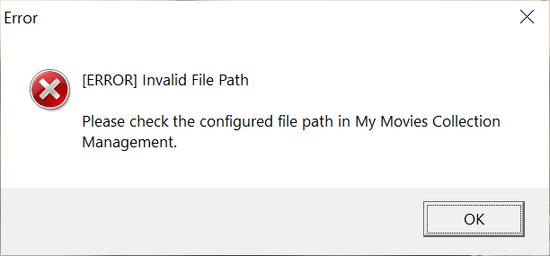

I believe I've resolved the Access Violation error when the file path is bad. There will still be an error displayed, but it will be a managed error now, and will provide helpful guidance that varies based on a few factors. Here's one:
This fix will be in v4.2.
Post by Jamie » Sat Jan 23, 2021 5:48 pm
Here's another option
Post by Teddyboy » Sat Jan 23, 2021 9:42 pm
Jamie wrote: Sat Jan 23, 2021 4:07 pm
View- Display View
How odd. I did set that many moons ago. I didn't think of verifying it. I've been using MC25 for quite some time now. No clue why it would change back to standard view. It works now. Thanks Jamie for the reminder. :)

Post by Teddyboy » Sat Jan 23, 2021 9:47 pm
Pauven wrote: Sat Jan 23, 2021 5:37 pm I believe I've resolved the Access Violation error when the file path is bad. There will still be an error displayed, but it will be a managed error now, and will provide helpful guidance that varies based on a few factors. Here's one:
That's it!
