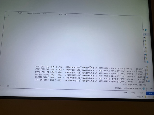

Cleaned meta data in CME and Exported new data with CME. Probably should have just did the meta data and not covers though. It exported correctly with 1828 titles in 3 hrs with no errors. Synced with CMC_CME in about 5 min with correct number of titles and another 10min for .jpg sync. Received the same error about invalid code execution. Movies play and everything seems to be operating correctly.
CMC Sync Error.jpg (71.53 KiB) Viewed 12108 times
Exported with CCC and it reported correctly with number of titles in 2 hours 40 minutes with no errors. Makes me wonder about my restore though. Seems to be operating slower and pausing. The last export I did completed in 45 minutes, so it makes me think there is something going on behind the scenes somewhere. I checked the wrong box during restore and wrote only differences in the restore instead of full restore. Been seeing a few bugs I don’t like. Might have to do this all over again. Will talk to you about that possibility at a later date.
Synced with CMC_CCC too quickly to worry about time, jpg took about 30 seconds, with no errors and correct movies. Still have debugging on so received the same error about accessing CMC_MovieDB.xml.

robert5733 wrote: Tue Aug 15, 2023 7:31 pm Received the same error about invalid code execution.
Thanks for sharing. That error message rang a bell for me, so I went back into my code to check it out. It happens in a weird scenario where the My Movies XML data says there's episode data, but the already processed CMC data disagrees and says there's no episode data. At the time I wrote that error message, I was confused how this was occurring, so more than anything that error message is a placeholder to remind me to fix this scenario. Out of sight out of mind, I totally forgot about this. After looking at it again, I'm still confused, my code definitely looks broken there, and the solution isn't obvious... Hmmm...

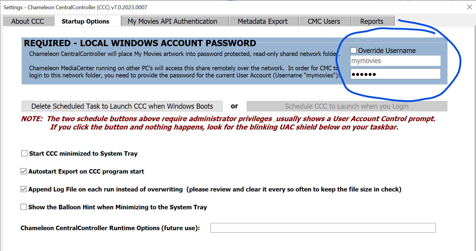

Just wanted to post an update for syncing a second computer. Had to fight with it for a bit, but got it working. Here's what I found.
Initially I couldn't connect to either CCC or the Netshare folder. I could see the Netshare folder in Explorer, but got a message that I didn't have permission. Played around with the permissions for awhile, so not sure what I did before the working result, but here's what I did. In change advanced sharing I turned on file sharing for public, private and guest networks(because my network is unknown by not being connected to internet, can't choose one to configure, did them all) and turned off password protected sharing. Right clicked Netshare, properties, and went to sharing, advanced sharing and made sure share this folder was enabled, back to sharing, share and added Everyone group and changed to read/write and selected share. Connection established and good to go.
Then came CCC conection. READ THE INSTRUCTIONS. Nope thought I had it handled and changed all kind of permissions and shared the folder and played with all kinds of settings(tried to remember evrything I did and set it all back as best I could) still no connection. Decided it was time to see what I could find in the forums and came across the directions. FIREWALL. Disabled the firewall and viola, connection. Followed the directions for windows defender firewall and enabled both instances of CCC, selected both public and private(because network is unknown) enabled firewall and baboom. Everything connects, did a sync and everything is working as designed.

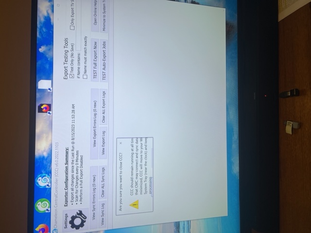

Now for the only problem I encountered. I'm connected by HDMI to a 4k TV(on server PC). When trying to close CCC it pops open the message/dialogue box asking to close or minimize CCC. I have done this enough times to know the choices but can only see the top most part of the selection.
Searched the internet and seems to be a problem with 4k in many programs. Connected to another TV and a monitor and had no problems on them, it is only the 4k TV.
Tried all kinds of fixes with resolution, text size and many other things. Played with CCC settings compatibility, and came up with a solution that worked. Right clicking CCC, properties, change high dpi settings, enabled "override high dpi scaling behavior" and selected "system under scaling performed by. I can now get the entire box.

Regarding the network share connectivity issue, I'm wondering if you didn't miss a step. It would have been easy to miss as I think it was optional for your single PC solution, but now that you're trying to connect remotely, it's not optional. In CCC > Settings > Startup Options, you need to make sure the Username and Password for the Local Windows Account is configured:
By default, the Username will self populate using the account you are currently logged in with. If for some reason you want it to use a different account, then you would click the Override checkbox and then replace the Username.
The info you type here is sent to CMC when CMC syncs to CCC. This permits CMC to then access the shared network folder, since it should be accessible using these same credentials.
Thanks for letting me know about the scaling issue on the minimize prompt, I'll check that out.

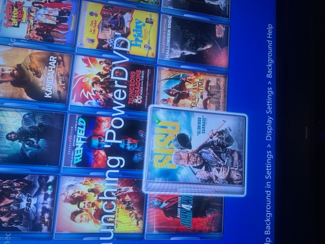

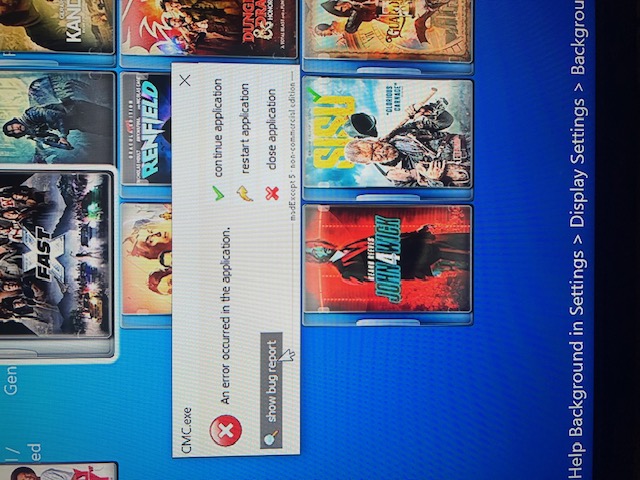

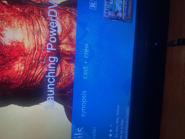

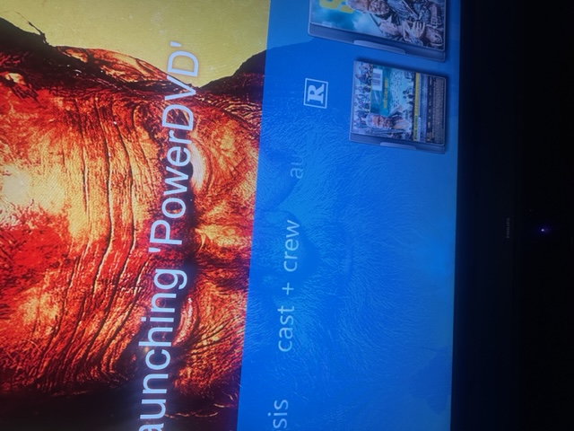

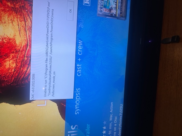

Never ending... had it all set up with no problems, watched movies cleaned and synced music played music no problems. Go to watch a movie tonight and "unable to run powerdvd"
Tried looking through logs and can't find anything. The path to powerdvd is correct and I can open pdvdlp.exe from that folder in explorer. I can navigate to the folder and see the files in the folder. Ran the check path in CCC and it says all paths are fine.
I select play and see the overlay to launch powerdvd, then get the error can't launch, close the error and launching powerdvd stays on screen, go back to main menu and launching powerdvd is still on screen briefly and disappears.
playclick log says everything is fine but there is no powerdvd launching.
