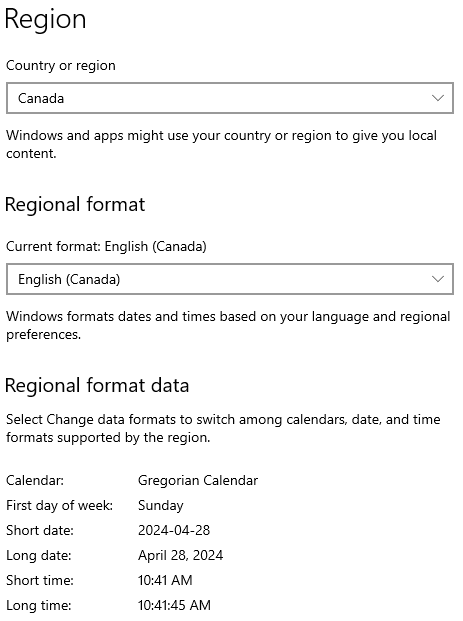

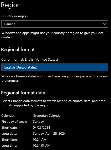

The question I wanted to ask is what you want me to do with my Regional Format settings... should I put them all back to how they were at the start of this troubleshooting? I've gathered from what you've said prior that my CCC Desktop PC can be whatever I want, so during my testing I've put it back to the original settings as you saw from my screenshots above. My understanding from what you've said is that the only PC that matters for the XML data and CMC's Disc Release date display is the PC that CCC points to, which is running My Movies and providing the API Key. So on the MM API Key machine, do you want me to set the Regional Format section back to the original Canadian settings I had with a Short Date of YYYY-MM-DD, or does it need to stay as shown above with the English (United States) options and MM/DD/YYYY Short Date?

Since the region changes we both attempted had zero impact on the MM API data, my recommendation is to set them to whatever you prefer. CCC and CMC currently do not utilize these Windows settings, so it doesn't affect my software.

I have not yet changed the Regional Format on that PC yet - it's still set to US with Short Date MM/DD/YYYY.
You're saying now that really doesn't matter, but I wanted to provide full disclosure as those dates above are clearly showing MM/DD/YYYY too.

I now changed the MM Server/API Key machine back to English Canada with 2024-04-28 showing as the Short Date.
Refreshed that URL you had me load and I don't see any difference:

So it would seem you're correct that there is no bearing on your software.

Thanks for doing that test. I didn't see any change on my end either, even with it set to YYYY-MM-DD, the API still output MM/DD/YYYY.
The good news is that I won't have to make any code changes to handle this area, since for once My Movies is being consistent. I had been wondering why you didn't complain about changes not being picked up (that's what these dates control), but since the dates were in MM/DD/YYYY that means it was working for you all along.

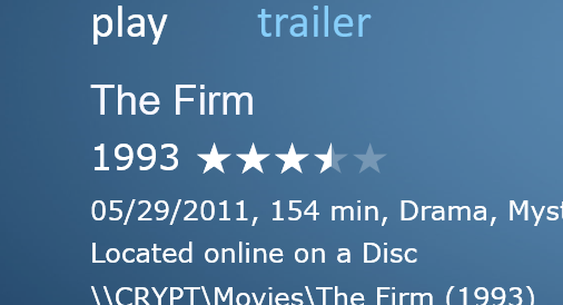

Started CMC 7.1. Did a Full Export with "the firm" in the filter field. Launched CMC and...
You figured it out!
I guess now it's time for another Full Export with no filters. :)
