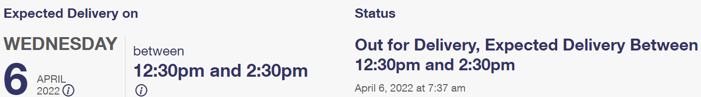

Over the past year and a half, I've come to distrust the USPS shipping estimates. Often it would take an extra week or two beyond the estimate.
Fingers crossed that they've dealt with the issues, as I might actually get my new Dell H310's today:
Not too bad for shipping coast to coast. Amazon already delivered the two reverse breakout cables on Monday, so I might be able to get the server back up and running today if the USPS delivers (haha, delivers...).
