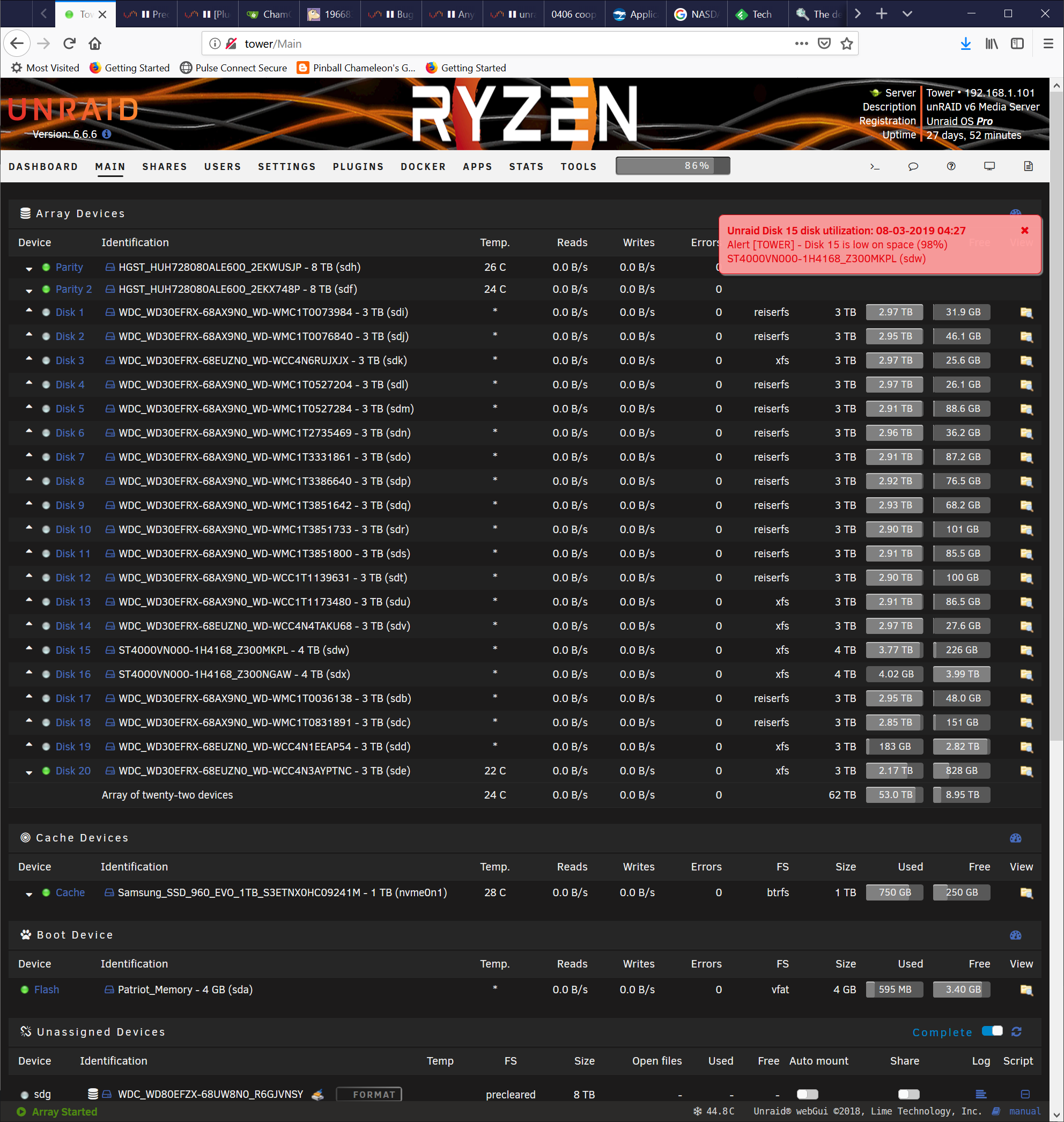

Since we've discussed Unraid's ability to use all of your available space, I wanted to share this pop-up alert I got today in Unraid.
In the top right, you'll see the red alert box informing me that Disk 15 is low on space (98% utilization). I also get an email with the same info - Unraid is very helpful.
Yesterday I copied 3 Blu-rays out to my TV_Series share (via the Cache) and overnight the Mover relocated them to Disk 15, prompting the alert. I think usage actually decreased a bit after the alert, as current usage is closer to 95%. I've noticed that during copies from the Cache that utilization is sometimes reported higher than the final result - not sure why, maybe temp files.
If you look at my Disk 15 row, you'll see that I've used 3.77 TB of this 4 TB disk, and that there are still 226 GB free. Based upon my settings for Blu-rays (min space 180GB) and DVD's/TV_Series (min space 100GB), I can expect that Unraid will continue sending even more data to this drive. By the time it hits the 100GB or less mark, Unraid will have used about 98% of this drive with zero intervention from me, and zero errors.
And as I explained before, I can manually copy some more data directly to that drive to further fill it up, it just won't happen automatically through my configured Shares.

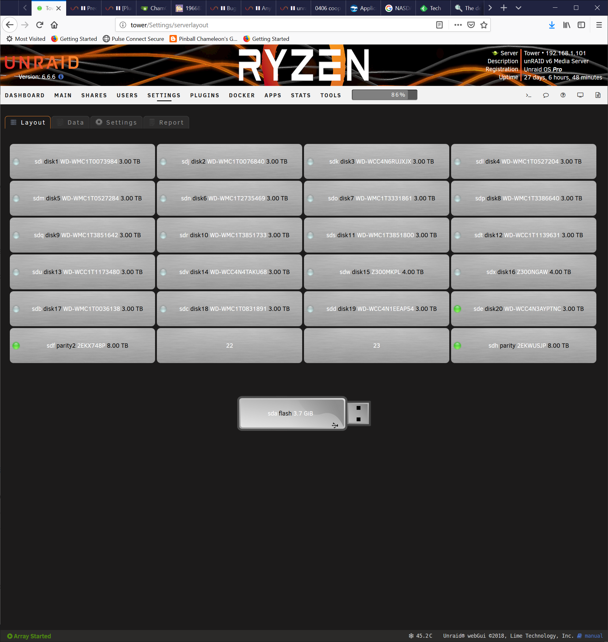

Post by Jamie » Fri Mar 08, 2019 3:31 pm
This might be a stupid question but I'll ask it any way. On the xcase drive bays how does the numbering go? Top to bottom and right to left? How do you attach the drive to the MB sata controller and controller cards to ensure that the numbering system is correct. How can I be sure during my installation that drive 15 is where I expect it to be? Any gotchas I should me aware of?
Post by Pauven » Fri Mar 08, 2019 6:39 pm
I think that is a great question.
First, it should be said that Unraid itself won't care if you randomly connect the drive bays in any which order. You plug in a drive, Unraid assigns a drive letter to it, and makes it available to use. Then you assign a drive (not a slot, but a drive) to a Disk # (not a letter, but a number) or Parity or Cache. You can then pull out the drive, pop it in another slot, and back in the day with only 1 drive parity, it wouldn't even care that you moved the drive to a new slot. Each drive has an ID (model + serial #) as you can in my screenshot above, so Unraid knows if you relocated a drive, and remembers what role that drive has.
Now, with 2 parity drives, I think that moving a drive to another slot invalidates parity, so you would have to rebuild the parity, but Unraid can still track that you moved the drive. I could be wrong about this invalidating parity, however, so take this with a dash of salt. But in general I don't recommend willy nilly moving drives around to different slots with dual parity in play.
When you connect the LSI controller to a backplane, each cable will connect to one row of 4 drives, and it will assign drive letters in order from left to right.
For example, if your flash drive is sda, then the controller might assign sdb, sdc, sdd, and sde for a row of drives.
At one point, I made sure that sdb, sdc, sdd, and sde were my top row. But looking at my screenshot, I can see that is no longer the case, as somehow they are now my 5th row. To be honest, this can change from boot to boot, depending upon which controller jumps in line first during the boot registration process. It really doesn't matter. Unraid maps a drive ID to a Disk #, regardless of what drive letter it is assigned.
What I do know for sure is that Drive 1-4 is my top row. You can assign any drive to any Disk #, so that is how I really keep track of it. I have my top physical row assigned as drives 1-4, they just happen to be drive letters sdi, sdj, sdk, and sdl.
So Unraid doesn't care, and while it would be nice if my top row was sdb-sde, as you can see it doesn't really matter. What matters is that I assigned my physical top row to Drives 1-4. Just an FYI, I keep my two parity drives in the bottom left and bottom right, so slot 21 and slot 24 if you want to think of it that way. I keep slots 22 and 23 unused in the array, and instead use them for pre-clearing new drives.
While it is purely optional (like I said, it doesn't matter if sdg is in slot 15 or 22 or 8 or 3), you may want to take extra care when you plug in the 8 SATA ports from the motherboard into the backplane. Because you have to plug into all 8 ports individually, you might do so in a way that gets those drive letters out of order (i.e. d,f,e,b,c,i,h,g instead of b,c,d,e,f,g,h,i). The only way you will know is to plug them all in during assembly, boot up, install a drive, and see what drive letter each slot comes up as.
You can hotplug drives with Unraid, so you can use one drive and plug it into each slot one by one, and see what drive letter it registers. If you don't like the drive letter a slot uses, then powerdown and move your cables around - that's your only method of control. To me, I like to know that each row gets assigned a drive letter from left to right in increasing sequence - makes for easier troubleshooting, but again this doesn't matter, it's just me being overly controlling about things that matter to me, but not to Unraid.
Keep in mind that your boot drive (the USB flash) will most likely show up as sda, or the very first drive letter, so you likely won't be able to get your slots to be sda-sdx, at best you can do sdb-sdy. But since you will also have 2 cache drives, and they will be plugged into the motherboard sata ports, they will show up somewhere in the middle. Also, you'll find it hard to control how Linux likes to assign drive letters. It may assign sda to the flash, then sdb-sdg to the 6 main motherboard SATA ports, then sgh-sdo to the first LSI controller, then sdp-sds to the other 4 motherboard SATA ports, then sdt-sdaa (sdaa is the drive letter AFTER sdz) to the other LSI controller.
So don't fret too much on trying to achieve the perfect drive letter order. Instead, focus on mapping a physical drive slot to the same numbered slot and drive #.
What will probably be of great interest to you is a Server Layout plugin that I use:
This is a really good plugin for multiple reasons. The main one is that it lets me track where all my drives are, in a layout that represents my physical case. So you see I have Disk 1 in the top left of row 1, Disk 20 in the bottom right of row 5, and my parity drives in the bottom corners. I like to keep my parity drives in the bottom row, as they get used the most of any drive, and putting them in the bottom means they get less heat applied to them from neighboring drives - at least that is my theory.
The Server Layout plugin allows me to assign a Drive ID to a Tray #. So I take my drive in the top left tray, ID WD-WMC1T00073984, and I assign it to Disk 1 in my Array, and Tray 1 in my Server Layout plugin. The fact that this is drive letter sdi doesn't matter. I know that Disk 1 is always my top left tray, and the Tray 1 is also my top left tray.
It takes a few minutes of management, but it really is not a big deal. Usually, once you set this up once, it pretty much takes care of itself.
The other nice thing about the Server Layout plugin is that you can track drive info, like when you bought it and from where, the warranty, how much you paid, the date it was first installed, the firmware, and more. So anytime you swap out a drive, you go to the Server Layout plugin, enter any info you want to track, and assign it to the virtual tray #.
