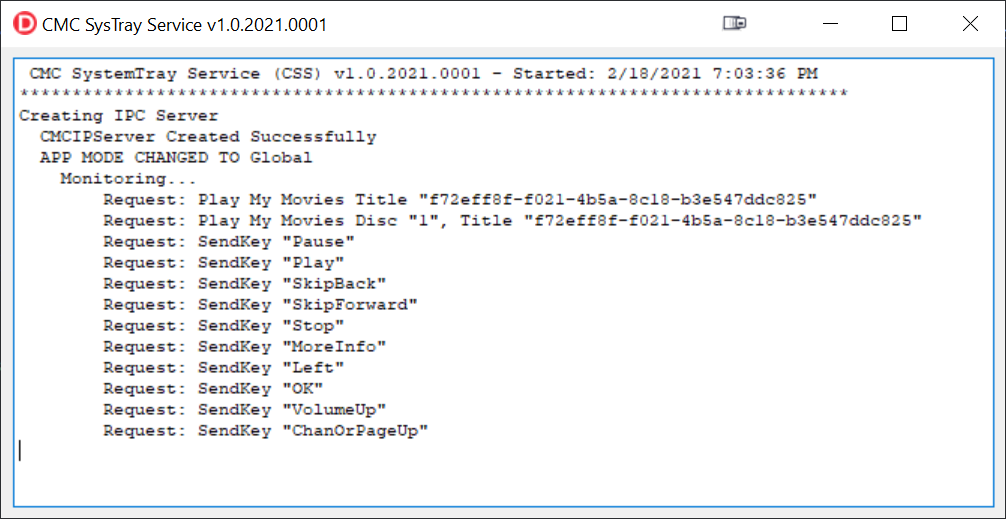

I've got the My Movies mobile Android app successfully communicating with the new CMC SysTray Service:
As in my earlier research, the Android app still crashes on the response to the request to "Play My Movies Disc". EDIT: I just tested, and the iOS app does not crash, instead it opens the Remote Control panel, but that's not actually working with my SysTray app yet. But as you can see, there's already enough info to initiate playback in CMC by that stage.

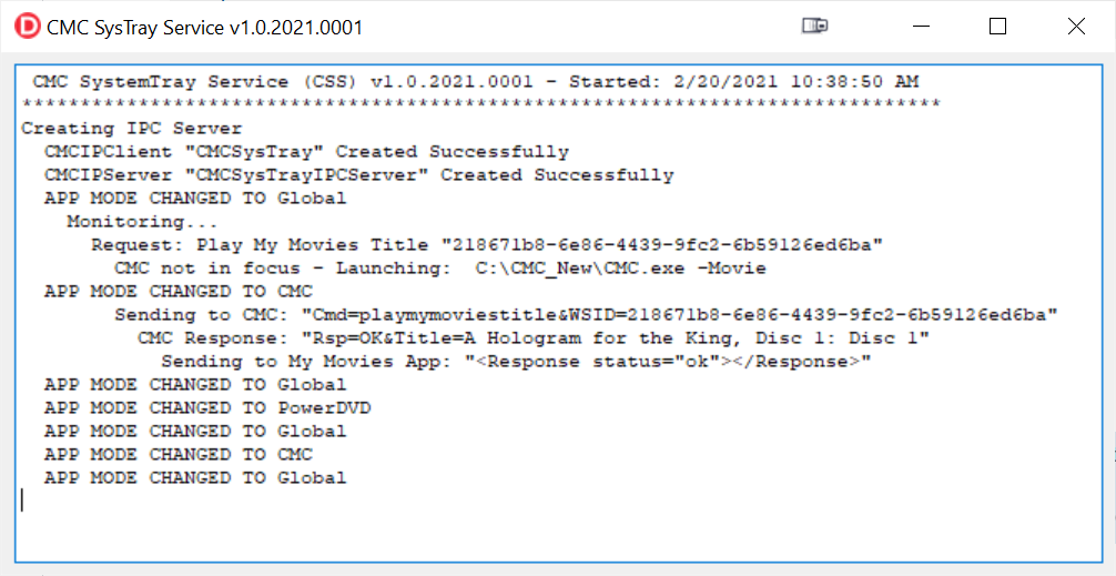

Progress has been great. Not only have I worked out the playback bugs, but I have it so that the SysTray app will launch CMC if it isn't already running and then start playback.
I also updated the SysTray app to constantly monitor what app has focus. Previously it was only checking if you touched a remote button, but now with being able to send commands from the My Movies app, I changed this to constantly monitor by checking twice a second. I think this works better in general.
In the test below, CMC was not running when I select to play "A Hologram for the King", which only has 1 disc. The CMC_SysTray app saw that CMC didn't have focus and launched it, then sent the request. As the movie only had a single disc, CMC started playback immediately, and that result was passed back to the CMC_SysTray app, which in turn passed it back to the My Movies Android app (which promptly crashed! Brian is aware now).
What you can't see in the screenshot is how all this looks in CMC - I think it is pretty slick. CMC will change to the Movie Library if it is in the Music Library, will change the Media Type filter to All Titles, and apply the "Show Everything" hotkey to ensure that all titles are displayed. It will then navigate to the selected title and begin playback, which shows the Movie's FanArt while the ISO is loading. Later, when you return from watching the movie, CMC is focused on the movie you just watched, as if you had manually navigated there. I never saw this feature in WMC, so I'm not sure if I've simply reached WMC's capabilities or exceeded it, but I dare say that what CMC is doing is near perfect. I do need to test with some box-set titles, as that might trip up the auto-navigation step - I probably need to navigate the Box Set instead, and even open it up.
