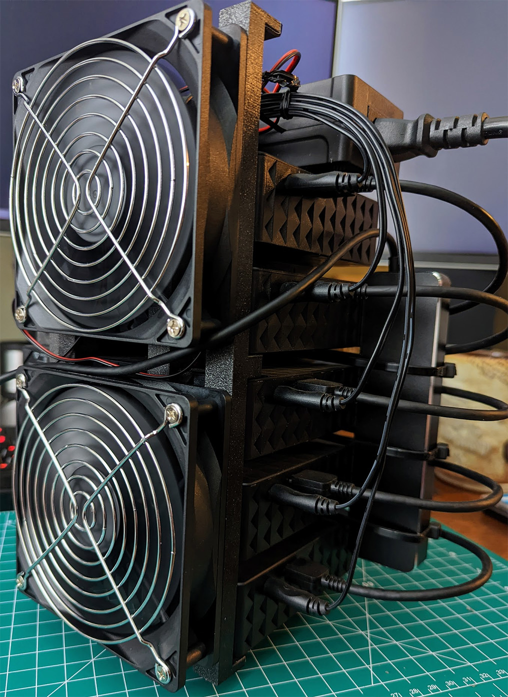

I decided to upgrade the cooling on my DIY USB HDD caddy. Up until now I've been running with an old freebie Enermax 120mm fan - it was an emergency fix I had rigged up when I realized drive temps were too high during the original backup which ran constantly for over a week. I basically had just dangled the fan in front of the drives to get some air movement, and it worked well enough that I used this makeshift solution for a bit too long.
I'm a huge fan (haha) of Noctua fans, and originally planned to use a pair of them, but I couldn't find non-PWM 120mm Noctua fans in my desired RPM range that run on 12v. While looking, I came across these Pano-Mounts 120mm fans that run on 12v, spin at a nice 1600 RPM, use just a simple 2-wire connection, and are supposedly quiet. For under $14 for a 2-pack, they seemed perfect.
https://www.amazon.com/gp/product/B07D4 ... =UTF8&th=1
These fans only draw 0.25A each, so 6W for the pair meant they wouldn't put much of a drain on my shared 12V power supply.
HDD Caddy Fans 1.jpg (490.12 KiB) Viewed 32094 times

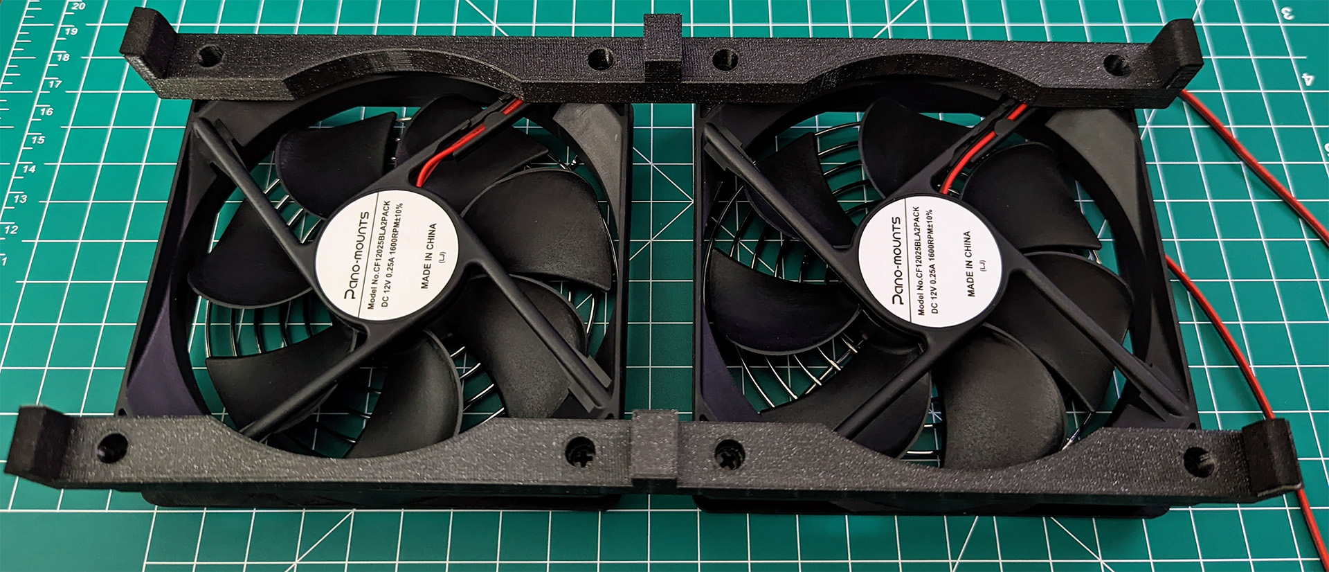

I spent a few minutes in Tinkercad and came up with a fan mount rail. 3 hours of printing later, and I was almost done. This is about $1.70 in plastic filament, so my total cooling upgrade cost is just under $16.
HDD Caddy Fans 2.jpg (441.75 KiB) Viewed 32094 times
The rail pegs slot between the drives with a friction fit, so assembly was LEGO simple. I went ahead and sized it so that the fans will cool 6 drives, since I'll be adding a 6th drive in the coming months.

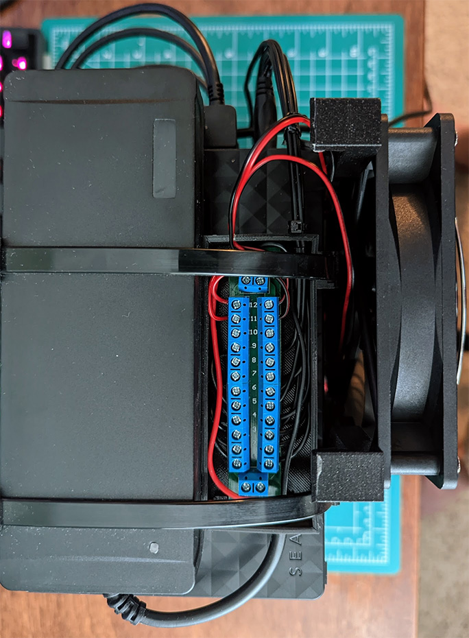

To power the fans, I simply connected them to the power distribution bus I used to share the 12V power with each of the drives. I have this bus mounted in a small 3D printed case on the top of the stack.
HDD Caddy Power Bus.jpg (218.39 KiB) Viewed 32094 times
I'm incredibly impressed at the finished product. The fans are fairly quiet, and produce much stronger airflow than the low-end Enermax I was previously using. I'll need to observe temps on the next backup to see how much of an improvement these make, but I wouldn't be surprised to see 5-10 degree drops.

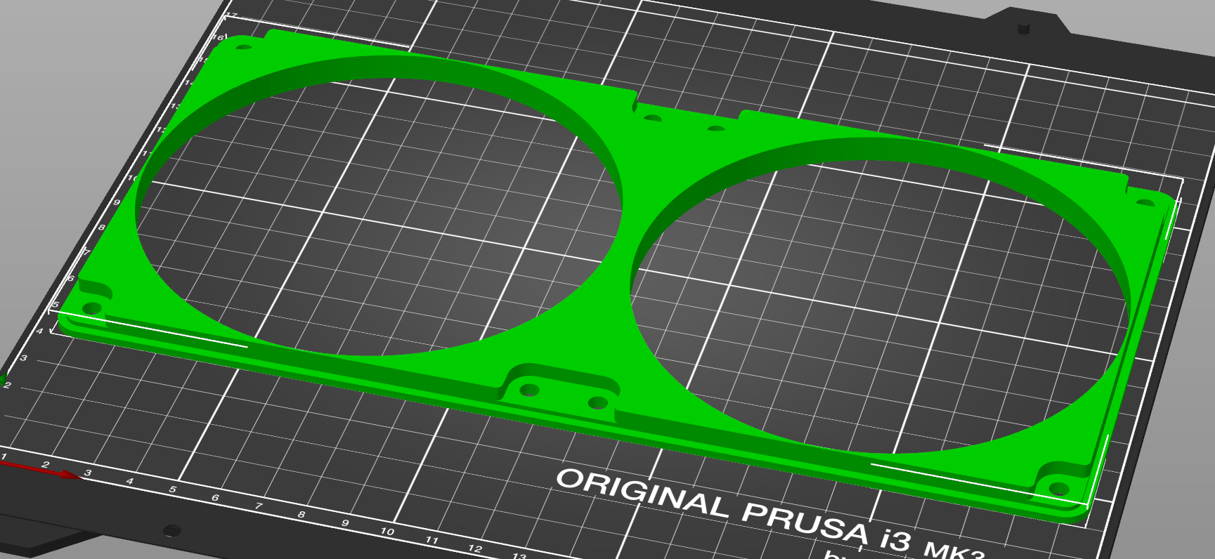

Anyway, I couldn't help myself. I got curious what a 3D printed enclosure might look like, and if it would even be printable. I'm about halfway done with the design. Still have to figure out the top and back panels, plus ventilation.
It looks like it would be barely printable on my Prusa i3 Mk2.5, which has a max width of 250mm. I've designed it for 7 drives with 7mm of space between them, plus the two 120mm fans, and the front & back panels are 241mm high. If I squeeze an 8th drive in there, the space between would cut in half to about 3.5mm, which is a little skimpy for my preferences, plus I already have the 7-port USB hub. Air will flow on all 6 sides of each drive.
Currently the design is just 6 sides. The left/right sides would bolt to the HDD's, and the front/back/top/bottom would bolt to each other and to the sides. The sides/top/bottom are just 2mm thick, but they have 3 large ribs running through them for plenty of strength. I'm planning to put a carrying handle on the top, but I'll have to be careful about the design as the finished assembly should weigh around 15 lbs.
I'm hoping to get most of the wiring inside the enclosure. I'll have to disassemble one of my current USB drives to figure out how much space the internal circuitry consumes. Still trying to decide if I actually want to print this before disassembling one of the enclosures.
The front panel would take 3 hours to print and cost $1.65. The bottom will take 5 hours to print and cost $2.60, and I figure the top will be the same. Each side will take 10 hours to print and cost $5.00. I'm guessing the back will take around 4 hours to print and cost around $2.00. All together I'm looking at about $18-$20 in cost and about 37 hours of printing. Of course, design mistakes and failed prints will further drive up the costs.
But for less than $25, I'm seriously thinking of doing it. It should provide significantly better cooling, and a smaller overall size compared to my current stack.

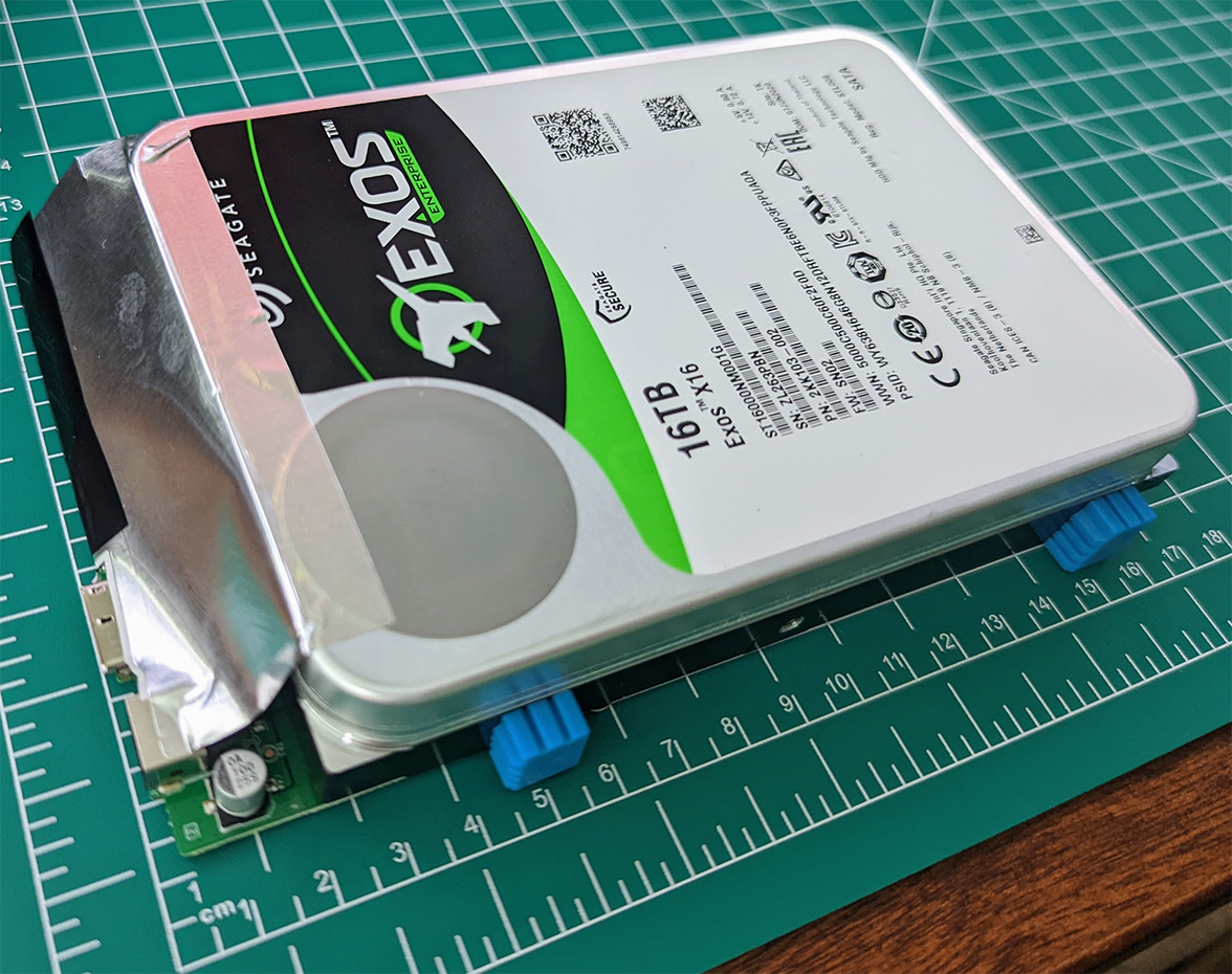

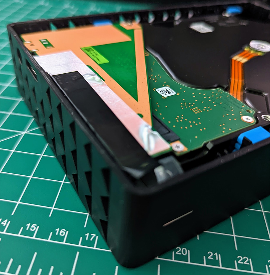

I decided to keep pursuing designing my own backup pool HDD caddy, so I went ahead and decased (aka "shucked") one of my Seagate USB drives. It was a little tough to open, but with enough prying I succeeded. My first surprise what that the USB adapter extends beneath the drive - that's the coppery triangle PCB in the pic below:
Seagate HDD 1.jpg (218.64 KiB) Viewed 32100 times
It makes sense now that I see it, but I had been doing all my design work assuming the drive height was the standard 26.1mm, and this little board adds another 1.5mm of thickness. This solidified my choice to only do 7 drives with 7mm spacing between them, instead of 8 drives with 3.5mm of spacing, as that 3.5mm gap would get reduced to just 2mm because of this board. As-is, I don't actually have 7mm of spacing for air to flow, this adapter board reduces it to 5.5mm.
My second surprise is that the drive is an Exos Enterprise model, very similar to the 8TB drives I've been using recently in my Unraid server. I was expecting 5400RPM desktop class drives, amazingly these are 7200. I guess this explains the excessive heat output.
Seagate HDD 2.jpg (360.98 KiB) Viewed 32100 times
Those little blue feet are the silicone-like mounting pads, which absorb some vibration, and the drive simply rests freely inside the enclosure. My caddy design doesn't permit using these, such a shame, because I need the securely mount the caddy panels to the drives in an exoskeleton style assembly. But none of my Unraid server's drives have vibration mounts, so I'm not too concerned about losing them here.

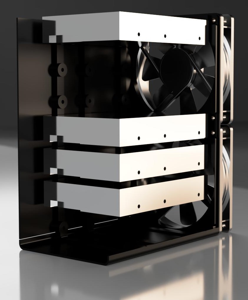

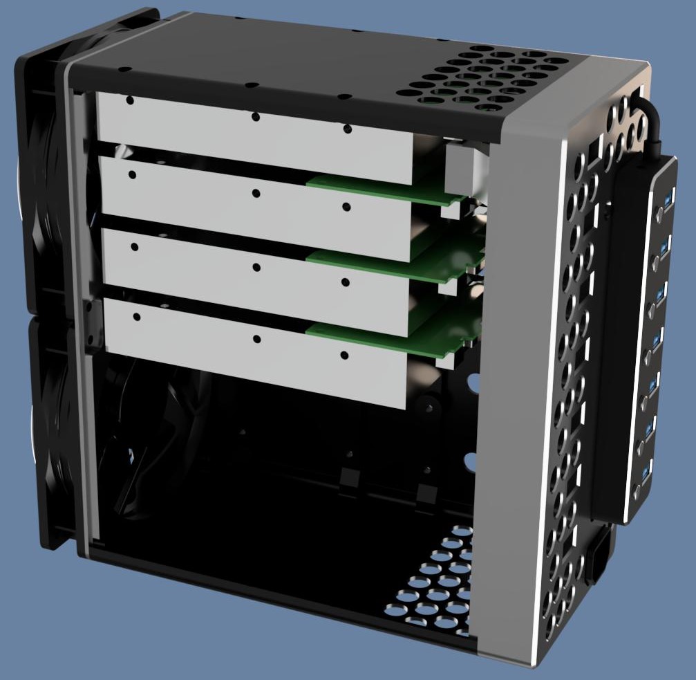

While trying to fit everything inside the caddy, some of the panels ended up growing in size. At one point, some of them were actually too big to print on my printer. So I had to resize a few parts to make it printable again. I also had to get a right-angle adapter for the power supply brick so that the power cord connects from the back, as there just wasn't enough room otherwise.
Here's a render of the current design, about 97% done. I'm actually thinking of printing in these colors, black and silver, as it looks spiffy to me in the render:
I calculated the open area of the two 120mm intake fans (18,260mm2), and then added 181 little 11mm exhaust holes all over the opposite end of the case, on the top, bottom, both sides and the back. By adding up all the openings, and reducing for blockage, I figure that exhaust openings total the same 18,260mm2, so exhaust shouldn't be a bottleneck.
Not sure that this matters, though, as I also added up the air passages around the drives, and that's only around 4,700mm2, just 25% of the inlet/exhaust openings. I never did make it through fluid dynamics in college, and don't have the software needed to model the airflow behavior, but I think the air will speed up as it squeezes through the drives, then slow down again upon exit.
Regardless, this is significantly better than trying to blow air through the USB enclosures, as there is only about 600mm2 worth of intake/exhaust openings on those little plastic boxes.
All that remains to be done on the design is to add a handle on top, and some screw mounts to connect the silver cover to the rest of the caddy.

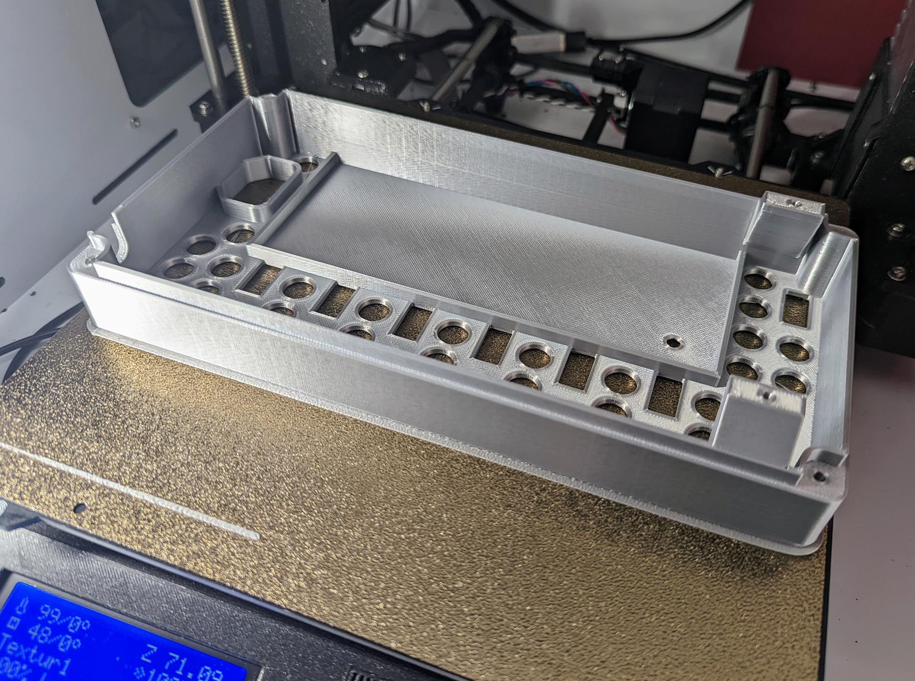

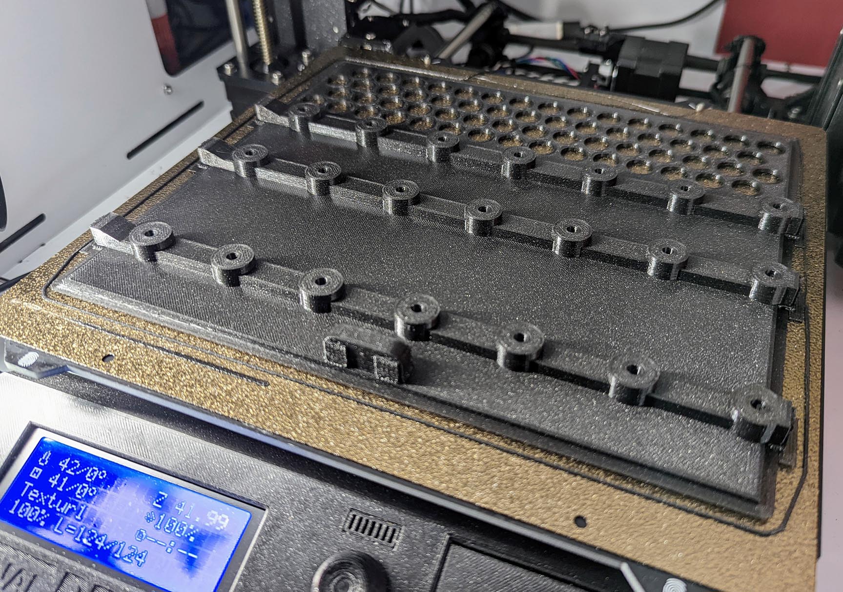

I went ahead and printed one of the large sides, to see if this project even seemed feasible. As you can see, this panel takes up almost the entirety of the available space on the build plate:
HDD Caddy Side Print.jpg (522.88 KiB) Viewed 32048 times
I was really worried about warping for such a large print, but was pleasantly surprised when it finished nearly perfectly. I was game to try more.

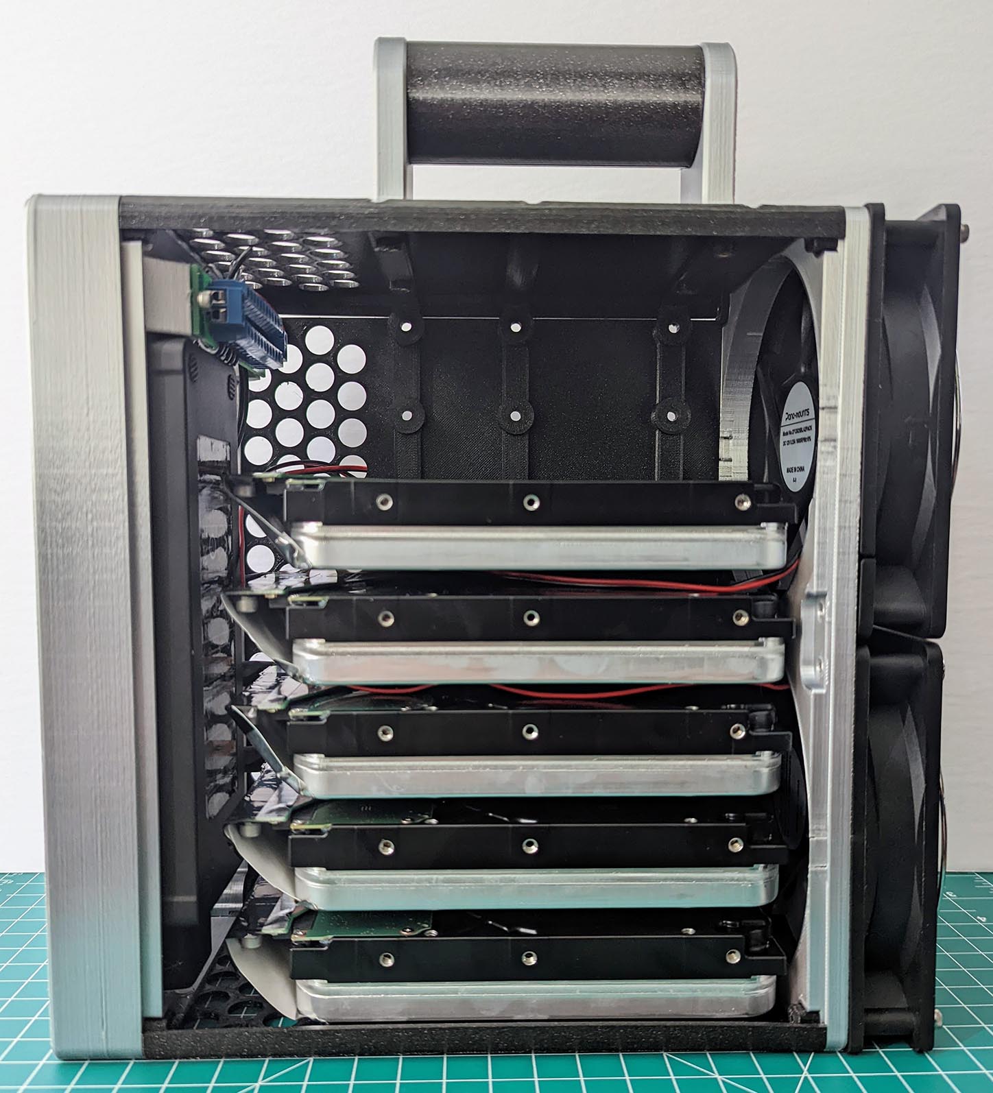

I may have over-engineered this case. I was expecting it to feel flimsy, but this feels like a solid, commercial product once assembled. Here in this assembly test, you can see it securely supporting all of the HDD's even with one side removed:

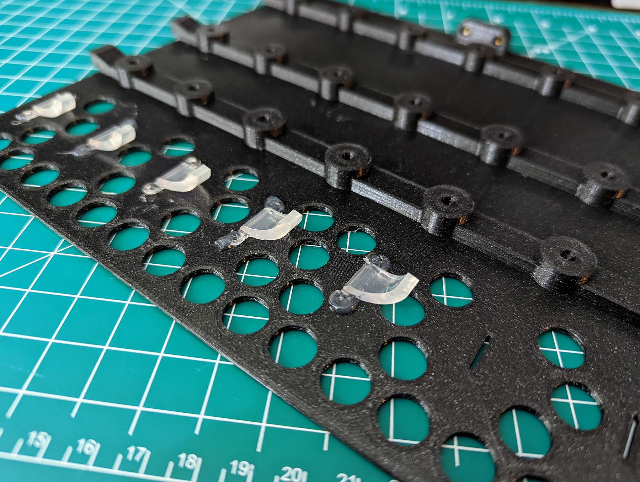

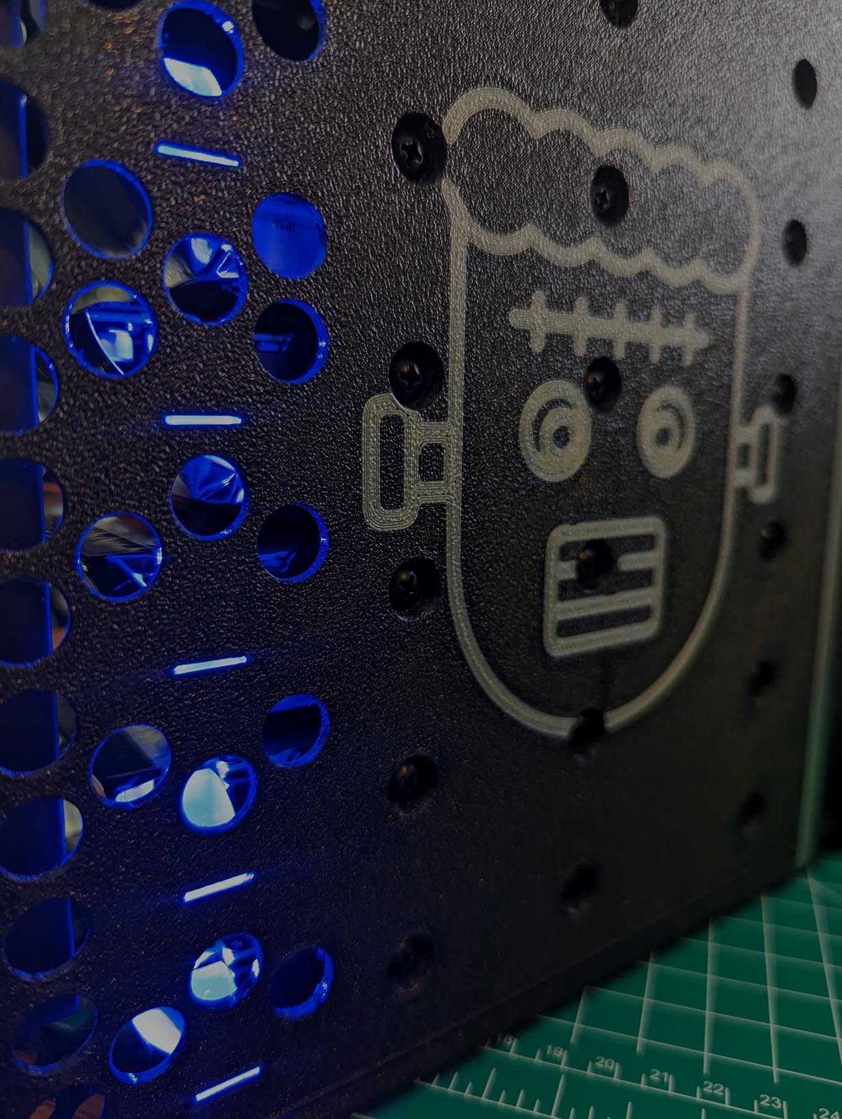

The original Seagate drive enclosures have a status light on the side, for which a simple light pipe transmits the blue LED light from the USB adapter board. I scavenged these light pipes and re-used them with a few dabs of hot glue:
HDD Caddy Light Pipes.jpg (504.1 KiB) Viewed 32048 times
The light pipes work perfectly, just as well as in the original Seagate enclosures, but my extra cooling holes create a much more dramatic light show. Additionally, I leaned a new printing trick to print a logo in a different color - in this case a Frankenstein's Monster icon so I will remember this is my Frankenstore pool:
HDD Caddy Light Pipe Test.jpg (351.88 KiB) Viewed 32048 times

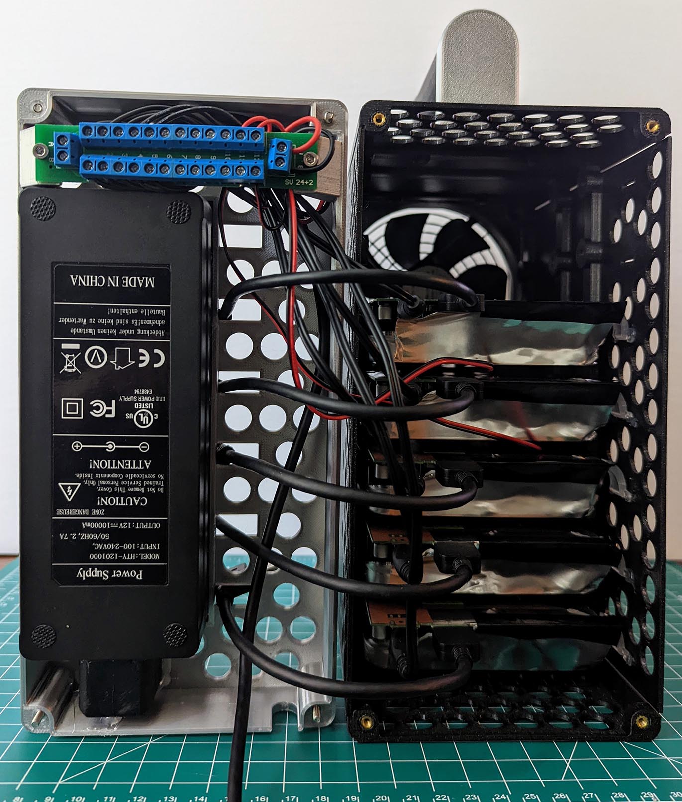

The wiring is easier than before - I just remove the back cover and have easy access to wire up the 12v power plugs and plug in the USB cables. Here you can also see the heat-set brass inserts I used - you use a soldering iron to melt these into printed holes, and they make for a super strong and reliable screw mount:
HDD Caddy Wiring.jpg (369.51 KiB) Viewed 32048 times

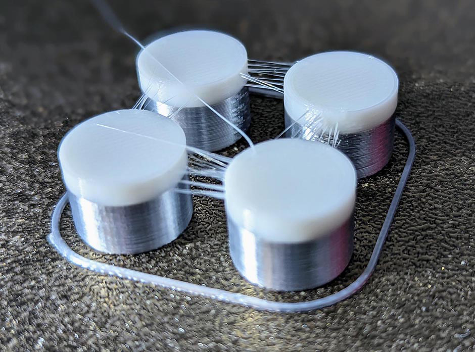

I didn't actually model the feet. I use PrusaSlicer to prepare all my prints, and it has built-in capability to create simple shapes. So I created a simple cylinder, and then configured a filament color change 3mm from the top. When the printer prompted for the next color, I swapped in some TPU flexible filament to act as vibration absorbing pads. This is one of my favorite tricks with 3D printing, to combine different materials into a cohesive part:

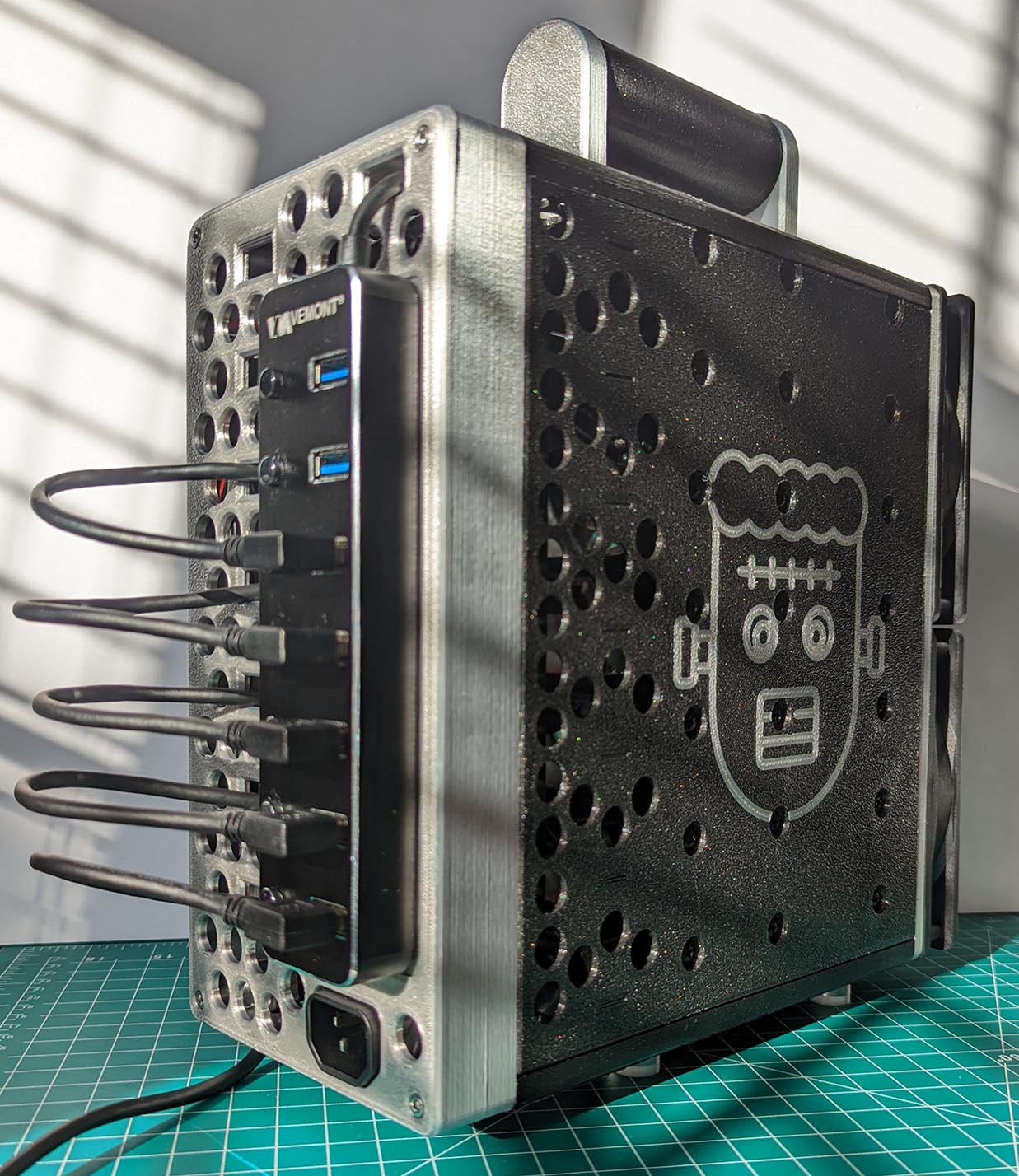

All done, it was about 70 hours of constant printing, though because everything printed so well I didn't have to baby sit it. Total cost for plastic was around $25, and the various screws (70) and heat-set inserts (28) added another $15 to the bill, so this is a $40 case.
I did use hot-glue for some of the assembly. In addition to the light pipes, the feet, rear USB hub, and power supply are all hot-glued into place. Fingers crossed none of those parts fail.
A couple times in project I had minor regrets, as it started to feel like a lot of effort for what would ultimately be very similar to my existing caddy stack. But with the project now complete, I'm ecstatic on the final result:
HDD Caddy Final Back.jpg (364.76 KiB) Viewed 32048 times
One of my favorite features is the handle. I was finding my previous HDD stack a chore to move around. This new handle solution is super strong and makes moving the array around a breeze. I'd estimate it currently weighs around 15-20 lbs, and will gain another 3 pounds when the final two drives are added.
HDD Caddy Final Front.jpg (489.12 KiB) Viewed 32048 times
But the best part is the enhanced cooling. With my original stack of these HDD's in the stock enclosure, temps quickly climbed towards 60°C. The cheap Enermax fan I used to keep temps somewhat in check could only manage 45-48°C. I never tested the new dual Pana-Mount fans that I added a week ago, but was expecting them to keep temps in the 30's.
But in this new chassis, temps are staying basically at ambient, 24°C, during an entire backup. I never even saw it rise a single degree! Amazing.
