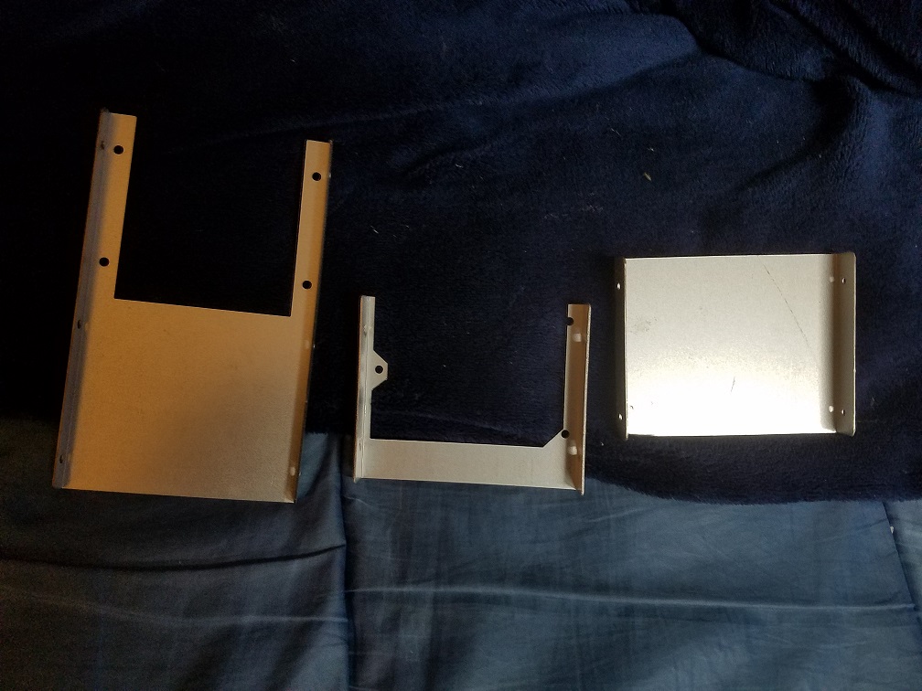

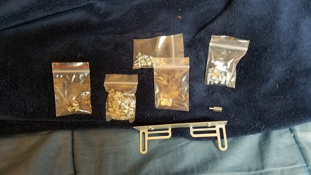

Paul, I am a little confused concerning what the extra brackets shown in the 2 attached photos are used for and whether the removed screw in one picture is the posts for the Motherboard?

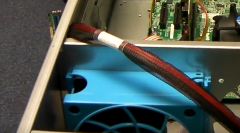

I watched the video, plus the part II video, and he shows something that you should NOT do:
Notice how he runs the SAS cables over the fan divider, do NOT do this. There should be a gasket on the top panel that aligns with this divider, and it forces all air to pull through the front drives, through the fans, and out the back. If you run the cables over the top, you will interfere with the gasket, and your air flow will short-circuit, reducing your cooling performance.
Notice in the picture that there are cable passthroughs at the far left and right side of the fan divider frame. Run all cables through these.

At least one of those brackets should be for the power supply. The case comes pre-installed for an ATX power supply (which is what you should have bought). There are also server type power supplies, in single or dual (redundant) configuration. I think two of the brackets are for different power supplies.
That third bracket does look like a drive tray. As I recall, there may be a spot for an extra internal drive on the other wall near the power supply. Perhaps that is it?
Yes, the removed screw is a motherboard post.

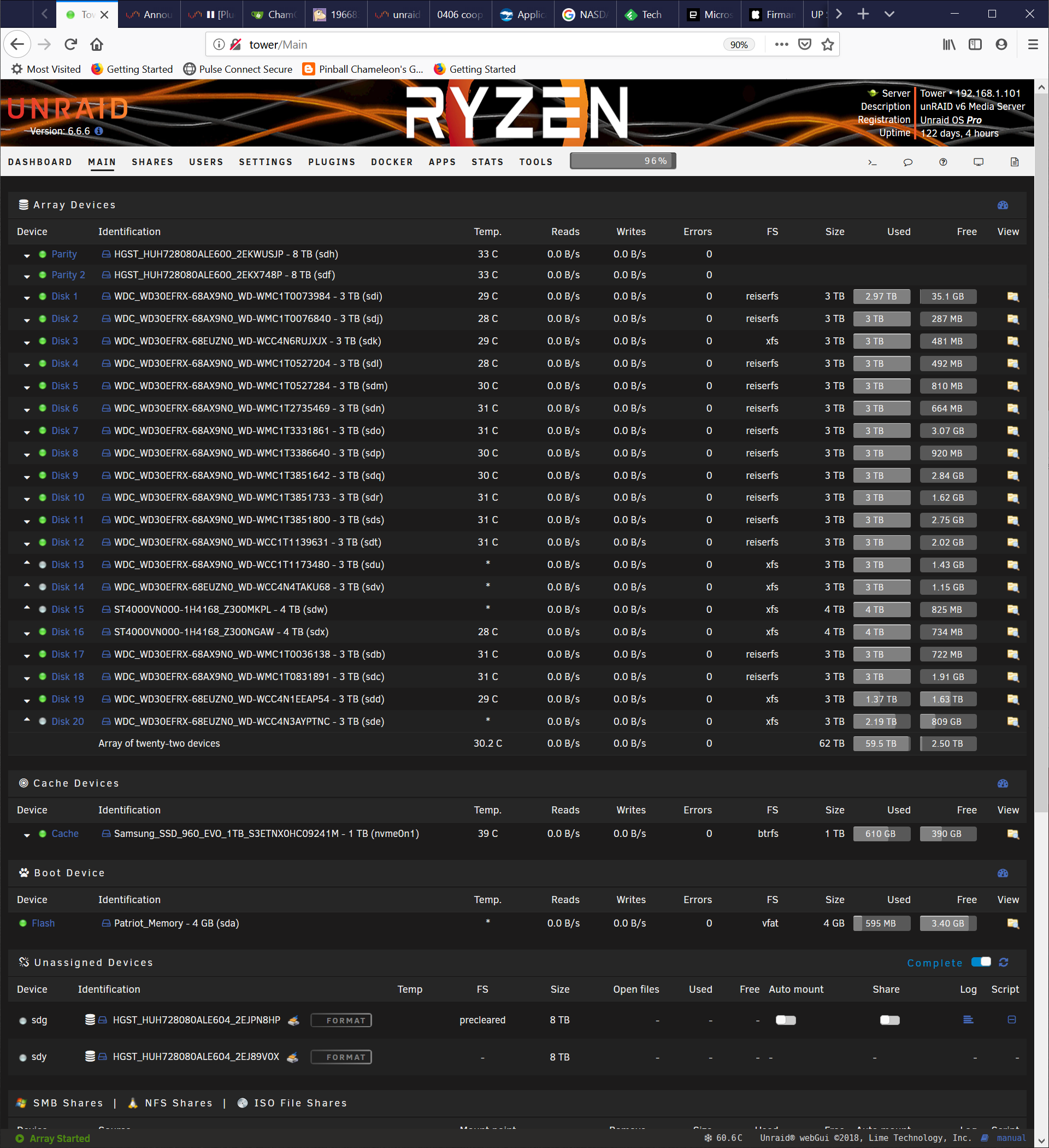

I know it has been a while, but I wanted to follow up on this post with an update. Last week I noticed that almost all of my drives had dropped below 100GB free, and that I was essentially writing all new rips to Disk 19. The space available on most disks was in the 80-100 GB range, per my share restrictions. I also had several boxes of DVD's that I'd yet to rip in storage, and thought it was finally time to rip them and fill up the nooks and crannies of my left over disk space.
It's been a 5 day ripping marathon, and I'm down to the last handful of DVD's, but the results speak for themselves. I first ripped some large 4K UHD's or Blu-rays directly to a disk to take up the bulk of the space, then filled in whatever remained with DVD's. It was a methodical process, and I used a spreadsheet to record the size of various DVD's before ripping, and made decisions on which drives to write to before ripping.
Notice that disks 2-18 are all at or below 3 GB free, and add those up and you barely reach 20 GB of total free space across those 17 drives.
I'm leaving extra space on Disk 1 for my music collection that lives there. Disk 19 is where new rips are currently writing. And Disk 20 is reserved for my various home PC backups.
My goal was to leave 1-3 GB free per disk, though I wasn't afraid to drop below 1GB. I really didn't want to drop below 500 MB, though as you can see for disk 2 I did some bad math and got down to 287 MB. I don't want to go any lower than that, as I like to leave room for metadata and I like to have a safety buffer so I don't run out of disk space.
And everything works fine.
At the bottom of the image you can see I have a couple 'Unassigned Devices', a pair of 8 TB drives that I've already pre-cleared. Once I finish filling up Disk 19, I will swap those drives in to replace a couple 3 TB drives and get a nice 10 TB space upgrade.
After the space is upgraded, I'll take the 3TB drives that I pulled and pre-clear them again, and keep them as emergency spares in case of a drive failure.
