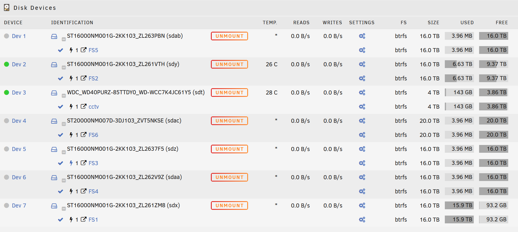

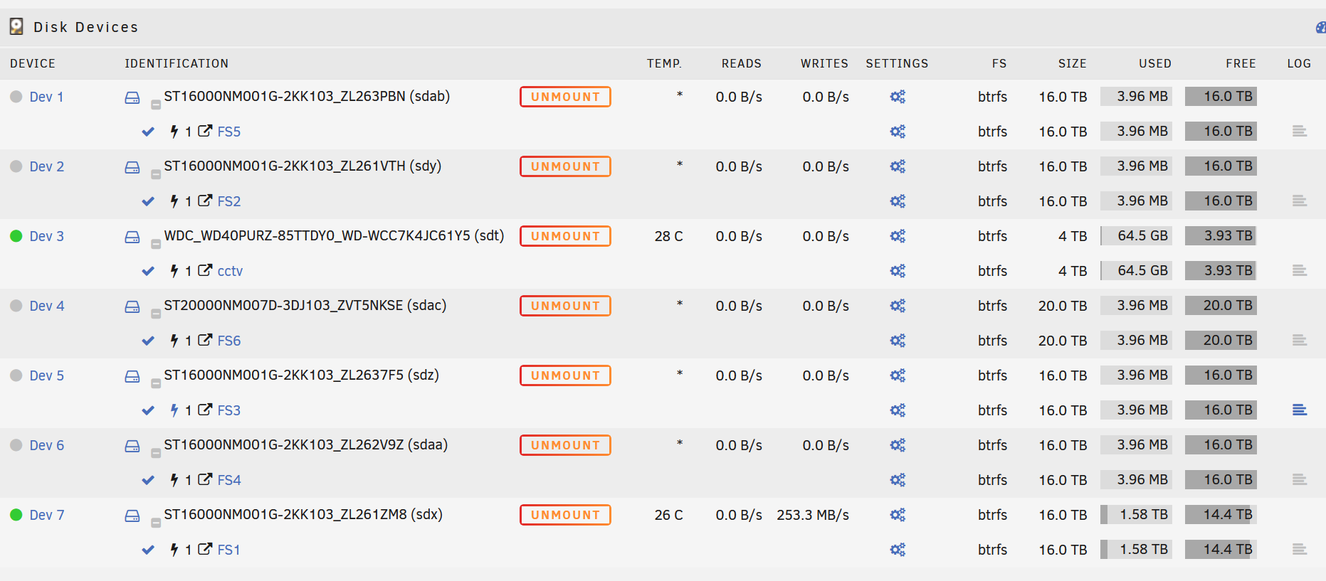

Step 6:
Check for successful mounting with "df -BM -H". I also piped through grep to filter on /mnt/disks/F so I could see just the 6 drives and MergerFS fused Frankenstore paths:
root@Tower:~# df -BM -H | grep /mnt/disks/F
/dev/sdx1        17T  4.0M   16T   1% /mnt/disks/FS1
/dev/sdy1        17T  4.0M   16T   1% /mnt/disks/FS2
/dev/sdz1        17T  4.0M   16T   1% /mnt/disks/FS3
/dev/sdab1       17T  4.0M   16T   1% /mnt/disks/FS5
/dev/sdac1       21T  4.0M   20T   1% /mnt/disks/FS6
/dev/sdaa1       17T  4.0M   16T   1% /mnt/disks/FS4
Frankenstore    101T   24M  100T   1% /mnt/disks/Frankenstore
Here I can see the new 100TB Frankenstore fused partition mounted at /mnt/disks/Frankenstore. Looking inside, I see my previously created target backup directories for each of my shares:

Step 7:
Run modified backup job. I created a script last year (on the first page of this thread) but it doesn't work correctly with this backup strategy.
ISSUE: When running RSYNC, it created all directories in a folder before processing files/folders in each subdirectory. For example, when backing up the 4K share, it first created all 56 movie folders on drive FS1 before copying a single file. At some point, the drive will fill up with data, and may have empty directories that weren't copied to that drive, and worse may cause errors as the epff option will tell MergerFS to copy files to existing paths first, so this will cause an error.
The solution is a custom wrapper around the RSYNC process that manually creates each directory just before copying the files into it.
For full credit, the bash script below came from: https://github.com/ashishpandey/scaffol ... /mirror.sh
However, I did make one change, adding the "--archive" parameter on the rsync command line, since I wanted that option in my backup to preserve metadata as much as possible. Save the code below into a new file named "mirror.sh" and save it in the same directory with your backup job script:

UPDATE:
The backup is about 2.5 hours into the weeklong job, and I'm super happy about the progress.
First, all of the data is writing to FS1, perfect:
/dev/sdx1        17T  1.6T   15T  10% /mnt/disks/FS1
Frankenstore    101T  1.6T   99T   2% /mnt/disks/Frankenstore
Even better, something I've never seen happen in my backups before, the other 5 drives have spun down! (ignore the 4TB cctv drive, that's not part of this backup array)
I guess I always thought the drives remained spun up in Unassigned Devices regardless of activity, and it never occurred to me that the previous BTRFS pool backup was incorrectly writing across all drives, keeping them spun up.
With the new MergerFS pool, the idle drives are able to spin down, though the active drive does seem to be a touch warmer than before - but I think that's just because it's seeing more constant write activity, and 26C is still really cool as far as drive temps go.
The next big milestone will probably be tomorrow afternoon, when the first drive should fill up with about 90GB of space remaining and roll over to the 2nd drive.

The backup job is continuing, though there has been a hiccup.
My backup job processes each of my shares independently, 4K, Blu-Rays, DVDs, and finally TV_Series. 4K completed without any issues, and because I only have about 10TB of 4K content, it all fit onto the first backup disk, FS1.
The vast majority of my content is in Blu-Rays, around 64TB worth, so it will - or perhaps should - span 5 drives, from FS1 to FS5. This did not happen, though. I watched with intent as FS1 dropped to around 100GB free, since that was the minimum free space limit I had configured in MergerFS, and since it was copying Blu-Rays I figured actual free space left would likely be somewhere in the 53GB to 100GB range. Sure enough, it dropped to 93.2GB, at which point the processing seemed to hang for a while, and all write activity stopped.
A few minutes later, notifications popped up that the Blu-Rays backup had completed (hah! far from it, though, since it left off in the B's), and the DVDs backup had commenced. I checked, and DVDs were being backup up to the second drive, FS2. Since then, DVDs have completed and TV_Series is currently progressing, still writing to FS2. Combined, I have about 14TB of data in DVDs and TV_Series, so this will all fit on FS2 and should complete without issue.
For whatever reason, writing did not roll over from FS1 to FS2 smoothly during the Blu-Rays backup. I've checked my backup log, and no error was recorded, it simply stopped midway on the title "Brooklyn", and jumped to doing the DVDs share with no helpful information on what transpired.
Looking in the Brooklyn backup folder, I can tell it is incomplete, there are several files that were not copied after the main ISO file pushed FS1 below the 100GB min free space limit. I'm not entirely surprised that Brooklyn failed to finish, but I though that the remaining Blu-Rays would have processed beginning on the next drive, FS2. I think the error on Brooklyn was somehow catastrophic to the RSYNC process, possibly even due to the extra logic in the new Mirror.sh script, and so the entire Blu-Rays backup step aborted.
I will say I was already expecting some kind of issue at the drive transition, and there's an option setting in MergerFS that I thought might be needed:
  • moveonenospc=BOOL|POLICY: When enabled if a write fails with ENOSPC (no space left on device) or EDQUOT (disk quota exceeded) the policy selected will run to find a new location for the file. An attempt to move the file to that branch will occur (keeping all metadata possible) and if successful the original is unlinked and the write retried. (default: false, true = mfs)
A branch in MergerFS is a filepath on a specific disk, so a new branch here would have been the same filepath but on a different disk. "ENOSPC" seems to be shorthand for Error: No Space, which I figured would happen. MoveOnENoSpc, or Move On Error: No Space sounds like it would have retried writing the file to the next drive, FS2. I'm not sure if it would move the entire folder (which would be nice) or simply split the folder across to the next drive and continue writing files there. By default, MoveOnENoSpc is disabled, and I had thought about enabling it for this first test, but decided I wanted to see what would happen with more default settings.
After the TV_Series backup completes, I'll make the change and try again. And because RSYNC processes the delta between source and target, it should pick up right where it left off, on the Brooklyn title.
One of the nice things about how MergerFS is working with 6 independent drives is that I can see drive activity and space utilization of each drive in the Unraid GUI, something that wasn't available in the BTRFS pool:
You can see that FS1 (at the bottom of the list) is full to 15.9GB and has spun down, and that FS2 (2nd in the list) is approaching 7TB written, so TV_Series has another 7TB or so to go before it completes sometime tonight. You can also see the other 4 FS# drives are sleeping and empty.
In spite of the drive transition hiccup, I'm super pleased with the new solution. Fingers crossed that enabling MoveOnENoSpc solves that issue.
