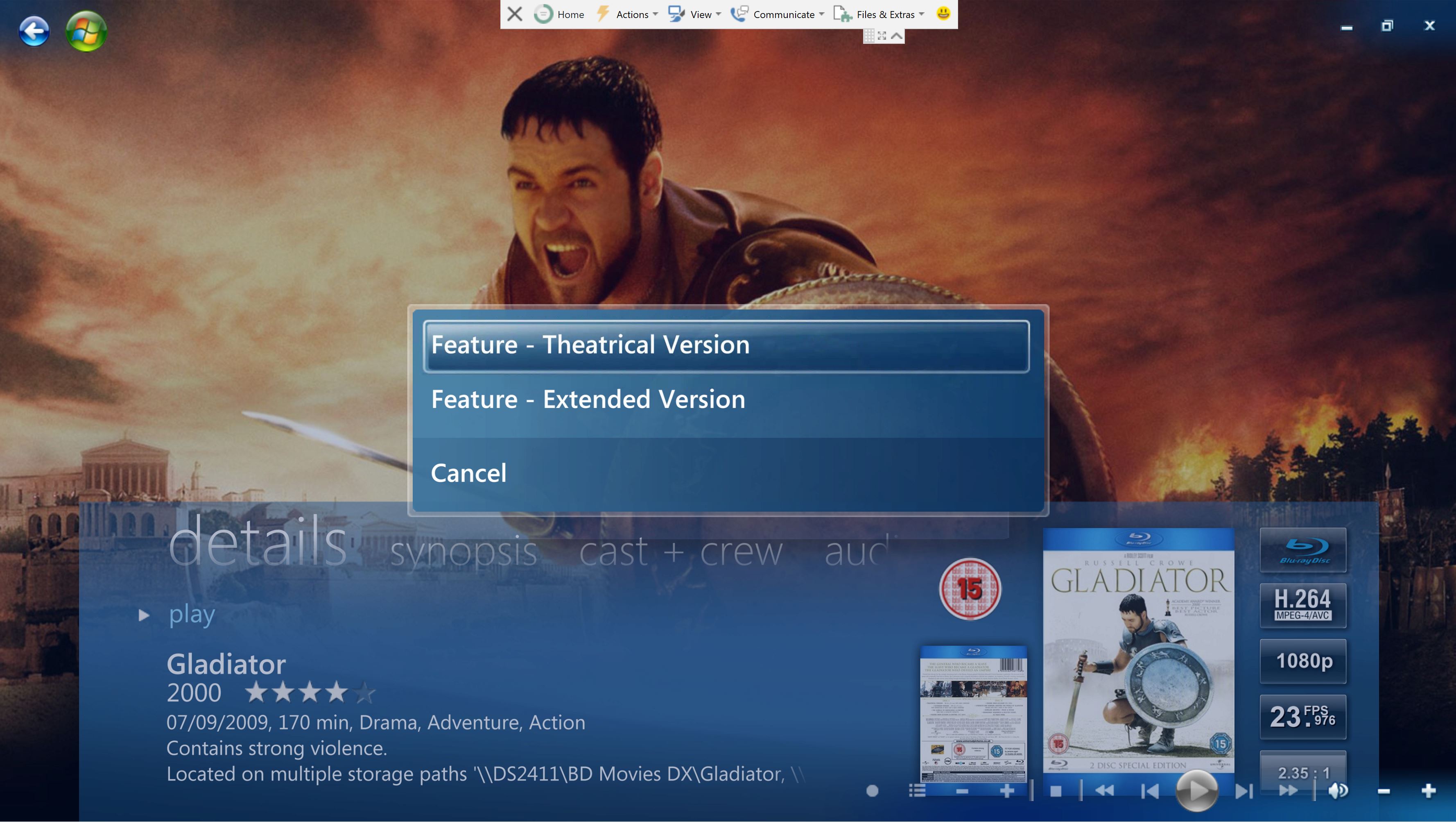

Just to show how you set it up:
and what it looks like when playing:
Re: Limiting export to some shares
That's exactly what I needed, thank you. I also found this gem in the xml file:
