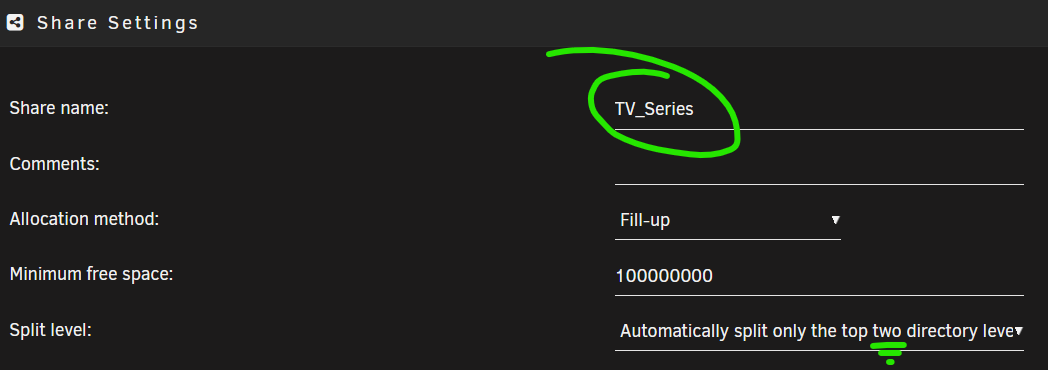

Second, I should point out that another reason I split my discs into 4 different shares (4K, Blu-rays, DVDs, TV_Series) is that I can have different share settings for each. For TV_Series, I split at the top two levels, for the others the top level:
The reason I split TV_Series at the top two directory levels is because I group all the seasons into a parent folder named for the show, which allows me to keep seasons together, but the series itself may be spread across multiple drives. It you weren't planning on keeping your TV Series on a separate share, you probably want to reconsider for this reason alone. The big problem with TV Series is that I'm often adding seasons for on-going shows (i.e. Veep, Homeland), so it might be years apart between adding seasons, and it's unlikely there is still room on the drive where the previous season was saved. While I want all the discs for that season to remain together, I fully expect that different seasons will end up on different drives. A split level of two, for my particular folder structure, works perfectly.
All my movies split at the top level directory, which basically means that once the movie folder is created (i.e. \\Tower\Blu-rays\Shawshank Redemption\, then everything written to that folder will always stay together on the same drive - which works great for the metadata files that get written sometimes months/years after the ISO. Note that this isn't an Unraid requirement - Shares transparently merge the contents from multiple drives into a single Share directory - but rather my own OCD that drives me to use this configuration.
Third, you can change the split level at any time, it doesn't have to remain static. It doesn't affect what was already copied, only newly written files. For the type of copy you are doing, from an external source much larger than your drives into a Share that spans multiple drives, you may need to crank up the split level to three, four, or five, or even that catch-all option of "Automatically split any directory as required". Once your copy is done, you can go back to your target split level for future additions.
It might be that you need to temporarily use a split level of three for your TV Series, and a split level of two for your movies, and that you would need to copy them separately after first setting the split level in prep for each copy session.
