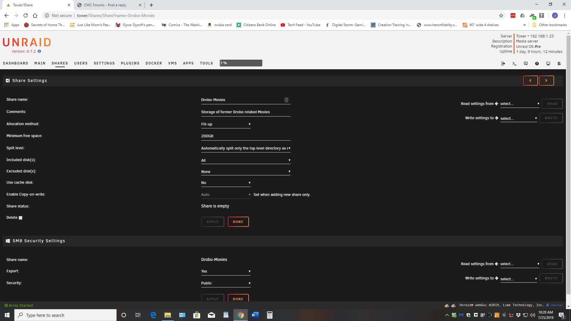

Here is my share setup. Also can you change a share name after there are files in the share? I might want to rename this share later.

I am using a share mymovies here.
I think that for now I just want to have the files/folders split at the top level movie/boxset/tvshow folder. Like this.

\\tower\mymovies\2001 A Space Odyssey\ <--Split at top one directory level
\\tower\mymovies\Game of Thrones\GOT Season 1\GOT Season 1 Disk 1\ <--Split at top two directory levels
\\tower\mymovies\Harry Potter\Harry Potter and the Sorcerers Stone\ <--Your choice, split at top two directory levels for carefree handling, or split at top one level if you really want to keep all movies on the same drive (but be prepared for manual effort to make this happen)
There is no difference in split for ISO vs. Folder - the directory levels count from the left, not the right.
I'm not sure if you can rename a share later - I think the answer is yes. You should try now before you get too far into it. Worst case, you could take a few manual steps to rename a share later, though I think the GUI will handle this scenario okay.
