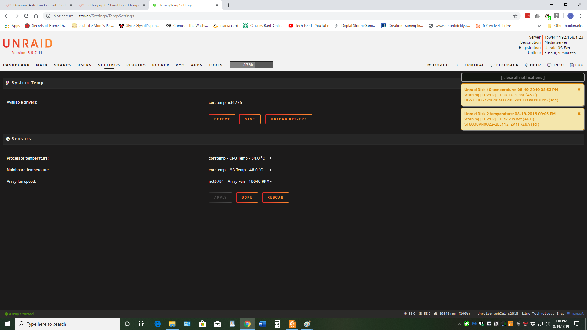

The Dynamix system temperature control is needed too. I set the temperature and fan settings as shown below. I started the array and within a minute the temperatures climbed to 46 - 47 degrees C. I did not hear the drive speed ramp up like I expected. The fans seem pretty quiet. I expected to hear them wale. The array fans, 3 of them, are connected by a 3 way cable splitter to one slot. They made a large amount of noise when I was putting things together but when I was ready for unraid things quieted down a lot. I have 2 fans in the back, 1 CPU fan, and the 3 for the array.

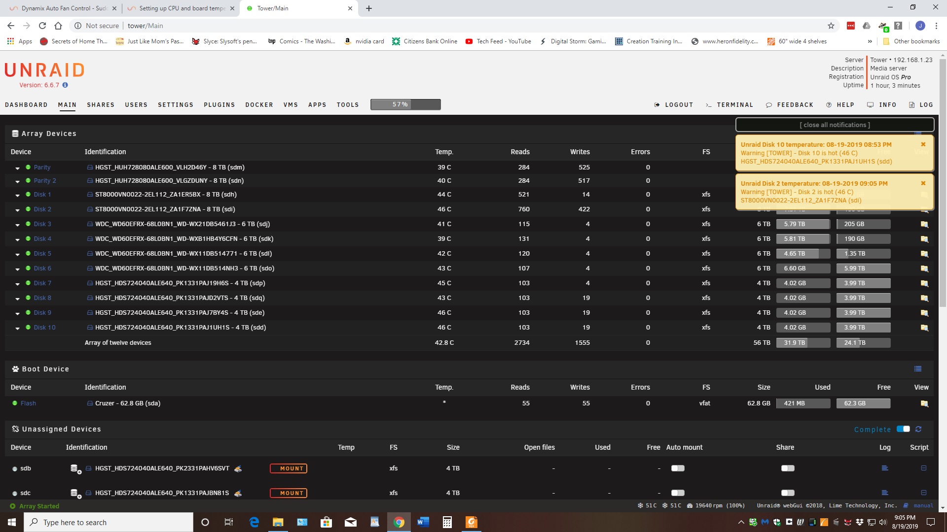

Things seemed to be fine today until I added 4 - 4tb drives to the array and added 4 more unassigned drives to be precleared. I started the preclear as before and the temperature readings soared. I canceled the preclears before starting the temperature investigation.
Here are the temperatures for the drives.
Hot drives.jpg (376.75 KiB) Viewed 14993 times

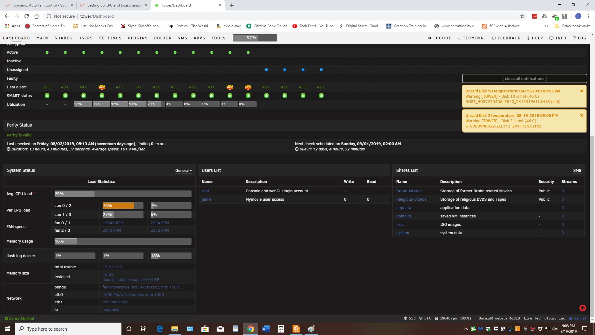

Here are the fan speeds. Maybe give up on the splitter for the 3 fans in the array. Their reporting a pretty high speed that is the combination of the 3 fans.
Fan speed.jpg (335.26 KiB) Viewed 14993 times
Here are the temperature settings.

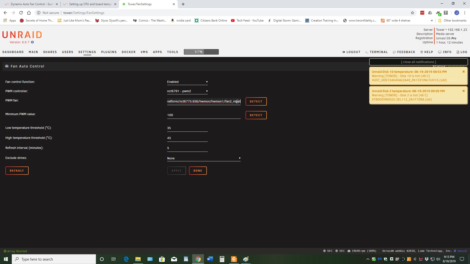

Here are the fan settings

Fan control.jpg (218.52 KiB) Viewed 14993 times

Sounds like you don't have the sensors and fan control set up properly. Sometimes you have to play around with the drivers and the selected sensors.
I'm confused by the splitter. I thought the case had three large fans and one fan speed header that you connect directly to the motherboard. You didn't connect that with a splitter to any other fans, did you? It needs a direct connection.
Full speed on the fan control is 255, in case you were wondering. They should get just as loud as during the boot. Your description sounds like they aren't reaching full speed
