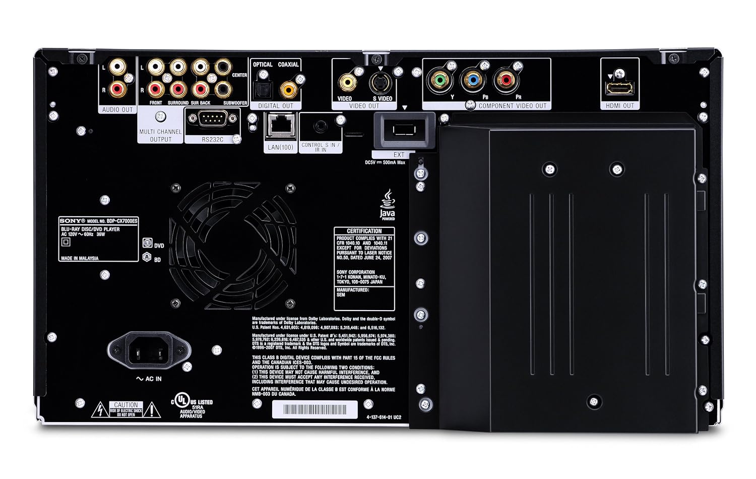

I found a picture of the back of that super expensive Sony 400 disc changer. I see the HDMI out, and the RS-232 for the PC to control it. I don't see any kind of video-in for a passthrough. I also don't think you can pass the video signal from the changer through the PC (HDCP would break).
I suppose if you had CMC running on one screen, and the changer hooked up to another screen, then this makes sense. But that begs for the CMC screen to be something like an iPad or tablet, no?

Isn't the disk changer the input to the PC which displays to the tv. How does wmc center do it through the mymovies plugin? Does wmc just act as a remote control?
I see a LAN and possible a USB port. Could this be the connection to the PC? I think that the RS232's are used to connect multiple changers. I will can discuss this offline if you want. No need to muck up the forum with some of my thoughts on this matter.

I think we need someone with one of these to chime in on how they work. My impression is that MMCM just works as a remote control.
If there was a USB port, I don't see why you would need the RS-232 serial port to control it, though I could be wrong.
The fact that it has audio and video out tells me that this is basically just a stand-alone Blu-ray player that hooks directly to a TV/AV Receiver, and just happens to hold 400 discs, and can accept external control via RS-232 from various HT control devices, including PC's.
