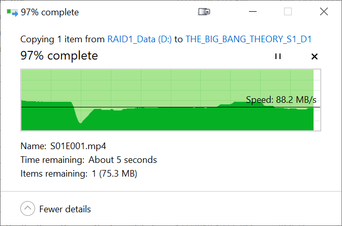

As a test, I just copied a 3.4GB MP4 directly to my array, bypassing the cache. The was a 15 second delay during which the copy was 'Calculating', then it took off at 120 MB/s and ran strong for a while, then dropped all the way down to 20 MB/s, then climbed back up into the 70-90 MB/s range for the rest of the copy.
Total duration was around 60-70 seconds.
Including that original 15 second delay, average copy speed was about 50-55 MB/s. Without that delay, the sustained throughput was 62-76 MB/s. This copy was to one of my older WD Red 3TB 5400 RPM drives. Copying to a 7200 RPM 8TB drive would be quicker as those drives are a lot faster.

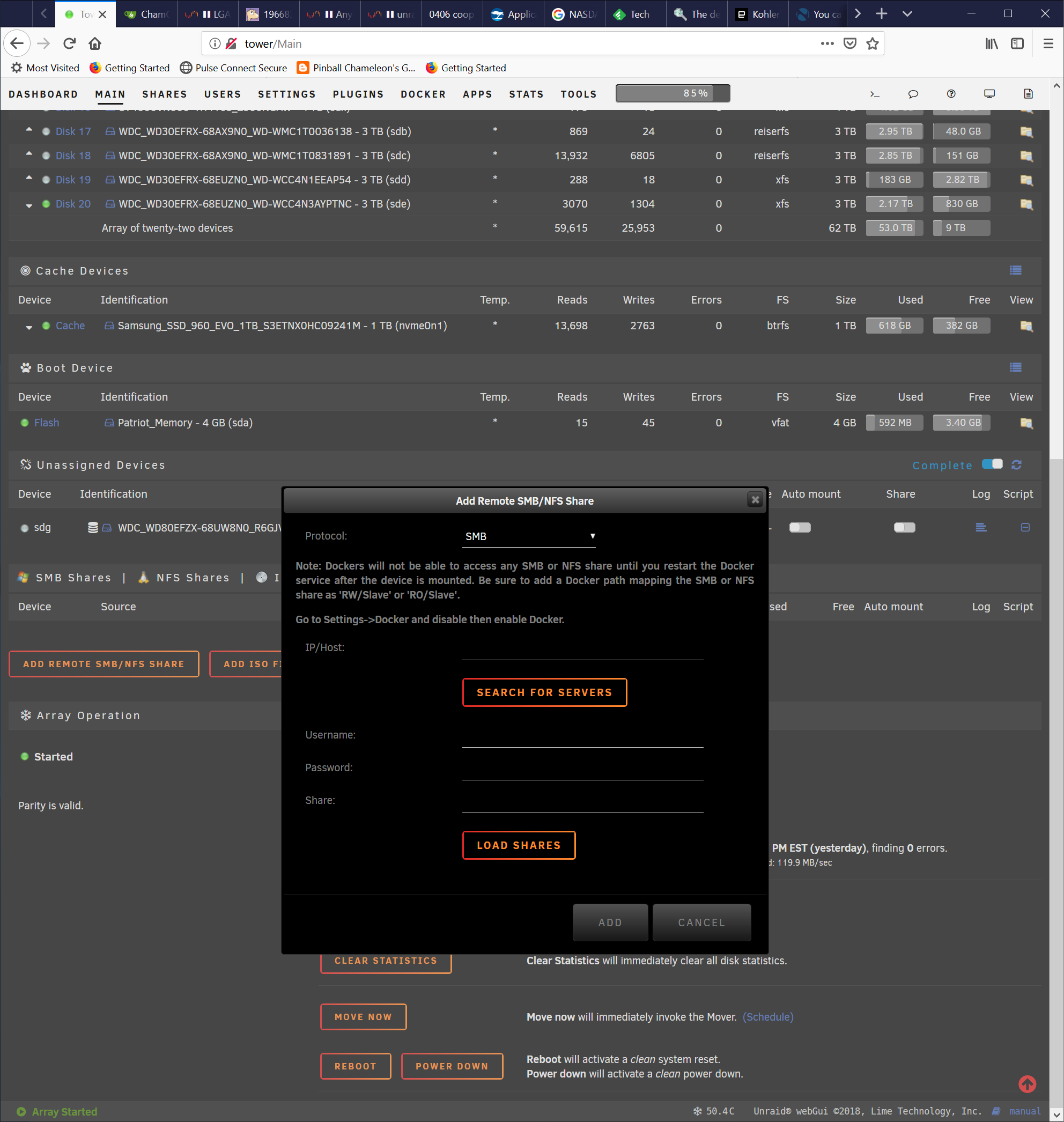

So I already figured out how to connect the Drobo directly to the Unraid server - surprisingly easy!
There's a plugin called "Unassigned Devices", and I already had it installed. The only reason I've ever used it is so I can see any extra HDD's I have in the server that I did not include in my array. Here's a screenshot, and in the middle you will see Unassigned Devices and I have one drive, Device sdg which is my WD Red 8TB drive that I have precleared (that post is coming...).
Right below that line you see SMB Shares | NFS Shares | ISO File Shares, and the button I highlighted for "ADD REMOTE SMB/NFS SHARE". That buttons been there for a long time, I've just never paid any attention to it. It's part of the Unassigned Devices plugin. Apparently you can add a direct connection to either an SMB or an NFS network share. Here's a screenshot showing the parameters you can provide for SMB:
Since I don't have a network enabled Drobo, I'm stuck at this point. After you connect it, presumable you should be able to directly copy from your Drobo to your Unraid server. Not sure "how" you would do that copy just yet, still looking at options for initiating and controlling the copy, though the leading candidate is the Krusader Docker. Command line is always an option, though I find that a pain for copies. Midnight Commander (MC at the command line) is included with Unraid, and might prove to be a good solution too.

Essentially, you would first install the Unassigned Devices plugin, then add the remote SMB share to a Drobo, then install and log into the Krusader Docker, which will give you a drag and drop style GUI to move files from point A to point B. Your files would go straight from the Drobo to the Unraid server.
You might be able to optimize your network path between them so that the rest of your home network isn't saturated while these two devices talk to each other. As long as you can have a single switch with both the Drobo and the Unraid server connected directly into it, their traffic shouldn't affect the rest of your network.
Here's the webpage on Krusader so you can read more about it: https://krusader.org/
It seems like it would have some options to do file comparisons to ensure you get a good copy.

Fortunately I have a netgear GB router sitting around doing nothing so I could take each drobo and hook it up to that router in the laundry room to the unraid server. So I could just dedicate that router to this task without affecting the rest of the network. The unraid server would have it's own dedicated LAN.
I can also copy all the folders in one try for each drobo, if you think that it would serve me well to do it all in one fell swoop.
