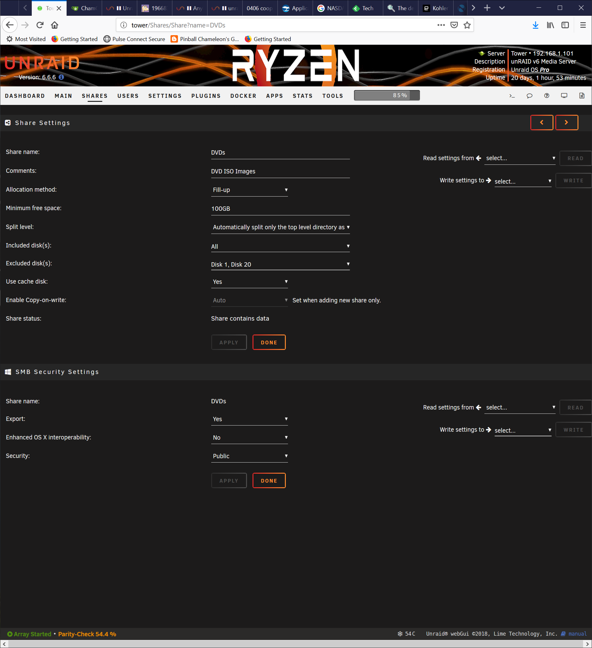

There are also quite a few parameters you can define for shares. Things like assigning or excluding drives from a share, minimum free-space, and the fill-up method.
For my Blu-Rays share, I include All disks, but exclude Disk 20, which I have reserved for my PC backups. I have the minimum free-space set to 180GB, which ensures that any Blu-ray discs copied to it will have enough room before the copy begins (180 GB is approximately 4 full-size BR ISO files) . The allocation method I use is "Fill-Up", which sequentially fills up each disk, one by one, until it hits the 180GB minimum free-space limit I set, then it moves to the next disk. I have the split level set to "Automatically split only the top level directory as required", which is the default and works well, though you may want to read up on this to determine if you like this behavior. I also have the "Use cache disk" set to yes, so that means any new data I copy to this share will copy first to the fast SSD cache disk, then overnight move into onto the protected HDD array.
For comparison, I have my DVDs share set with nearly identical parameters, though I have the minimum free space set to 100GB. Yes, this is much larger than a single DVD ISO, though from experience I have found that there are scenarios for which having the min free-space set higher works better. For example, if I copy an entire TV show season's worth of DVD's all at one, that might be 5 or 6 DVD's, or 40+ GB of data. Because they are for a single show, they would all reside in the same directory, so by setting the minimum free space to 100GB I ensure that the entire season gets copied together to the same physical drive (a preference of mine), while also preventing accidentally running out of space on a drive when copying a lot of data to a single directory.

You really shouldn't have to be concerned about overhead with Unraid. You can even use most of that last 100 GB, I just wouldn't use it through a Share to copy really big ISO's. Essentially, you should be able to easily utilize 99.9% of every data drive. Your two parity drives are the only sacrificed capacity.
For example, my "disc 5" currently has 88GB free, so neither my Blu-Rays Share or DVDs Share will automatically write to it (which makes me happy). It would be a pain if I wasn't paying attention and I allowed too much data to be written to a single drive via the Share, filling up a drive. This setting prevents that from happening in normal day to day copies when I'm not paying attention.
But I can browse out to /mnt/disk5/DVDs directly, and copy over another 10 ISO's directly to the disc and still have 10GB or more free. By copying them into that path, they become part of the DVDs Share, so I essentially temporarily override my 100GB share free-space limit by copying directly to the target disc. So I get to use all of my space, I just have to intentionally fill up that last little bit, and this forces me to pay attention and not make a mistake.
I could also get the same result by temporarily lowering the Min Free Space parameter on the Share, but then Unraid might decide to put my ISOs on Disc3 instead, which would upset me if I was trying to put them on Disc5. That's why I like to use direct disc access for the last little bit, it puts me fully in control.
This is just my preferred way of doing things. It allows me to set it and forget it for 99% of the time, then every so often I might manually copy a few more ISOs into the nooks and crannies to use more of my space.
Another point to revisit is that I have a LOT of Shares, not just for Blu-rays and DVDs. For example, I have a Share named Software, and it has a very low 1 GB set for minimum free space. Anytime I write to it, Unraid will use the space left over that I didn't use for ISOs.
Your only concern really should be to make sure you never hit 100% on a drive, as then you will have problems. But as long as you leave at least 1 or 2 GB free per drive (99.9% utilization), then that should be sufficient room for My Movies to maintain the meta-data files and artwork.
Unraid also has 3 allocation methods: High-water, Fill-up, and Most-free. I like Fill-up for my ISOs. Here's the Unraid help on those 3 methods:
This setting determines how Unraid OS will choose which disk to use when creating a new file or directory:
High-water Choose the lowest numbered disk with free space still above the current high water mark. The high water mark is initialized with the size of the largest data disk divided by 2. If no disk has free space above the current high water mark, divide the high water mark by 2 and choose again.
The goal of High-water is to write as much data as possible to each disk (in order to minimize how often disks need to be spun up), while at the same time, try to keep the same amount of free space on each disk (in order to distribute data evenly across the array).
Fill-up Choose the lowest numbered disk that still has free space above the current Minimum free space setting.
Most-free Choose the disk that currently has the most free space.
So if you used Most-free, then your data would be spread out across all the drives equally, and they all would fill up gradually. But this might separate directory files from each other more. I like Fill-up, because it is more likely to keep files together on the same drive for the same directory. There's no requirement for that, this is just my preference.
