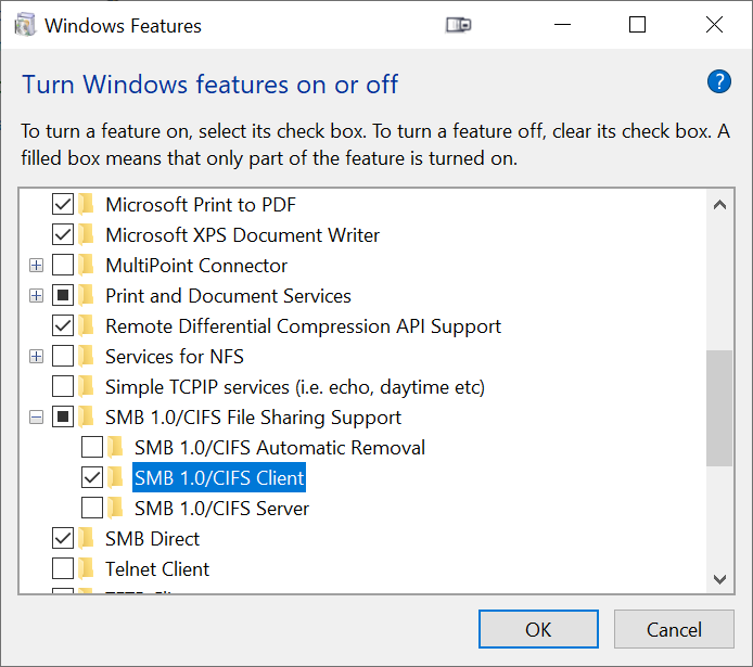

Since you're exploring setting up an Unraid server, here's something you should know, and it might even be related: Unraid uses SMB by default, and my Win10 PC's can't see it unless I re-enable SMB 1.0 support.
Control Panel > Programs > Turn Windows features on or off > SMB 1.0/CIFS File Sharing Support > SMB 1.0/CIFS Client:
Microsoft sees this as a security risk, and began turning SMBv1 off in Win10. Perhaps they've done the same to Win7 now. Apparently threats like Wannacry, Petya, NotPetya and others exploit SMBv1, so it is a security risk. You'll have to decide for yourself if the risk is worth it.

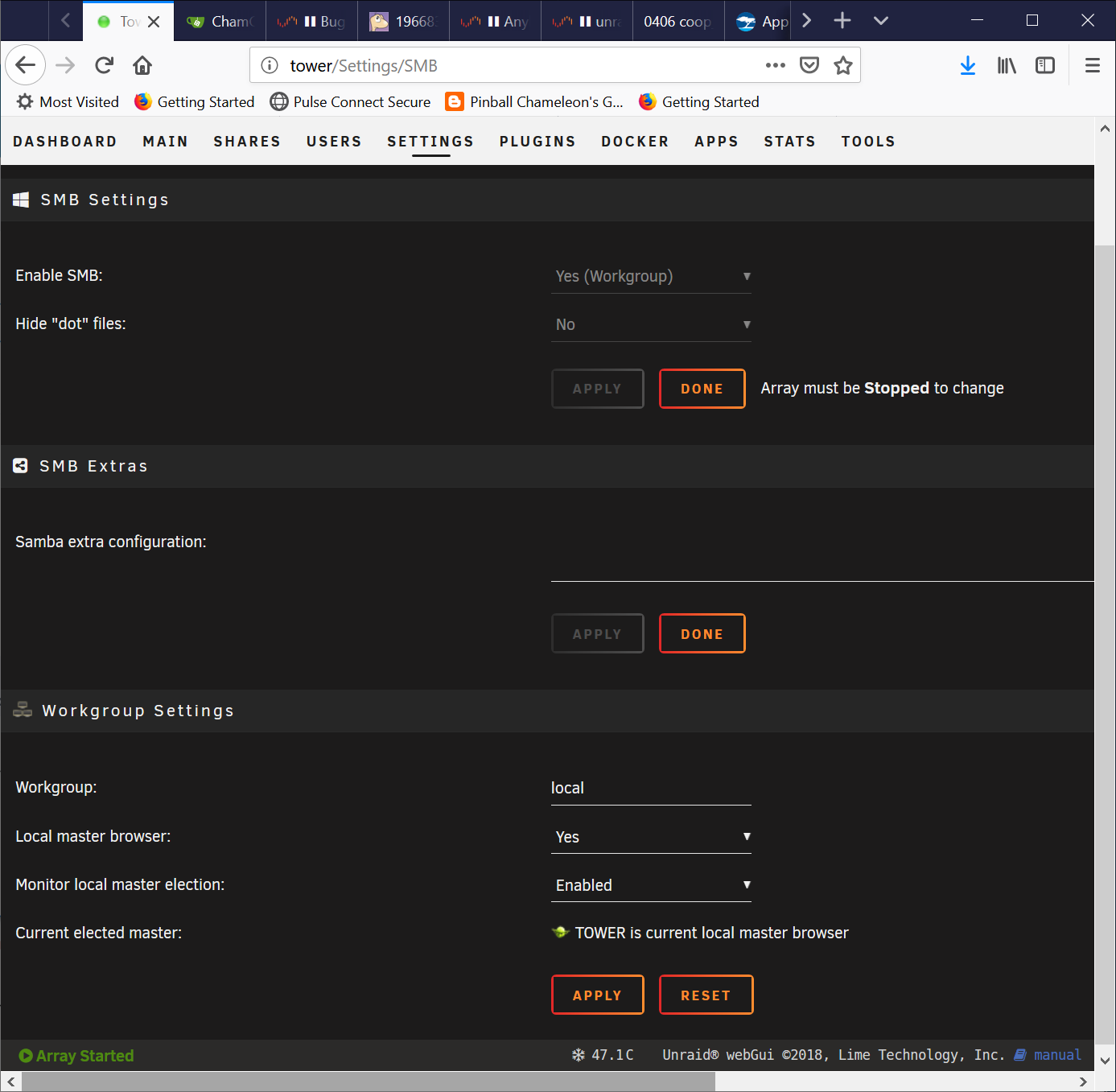

We Unraid users have a different solution at our disposal:

Pauven wrote: Thu Feb 28, 2019 1:47 pm We Unraid users have a different solution at our disposal:
Good to know. I think that I will stick with my asus router for right now.

I've been using Unraid as my Master Browser for so many years now, I never even think about it. I don't really understand exactly what the Master Browser does, all I know is that in the Unraid forums they say it is a best practice to set up an Unraid server as the Master Browser.
