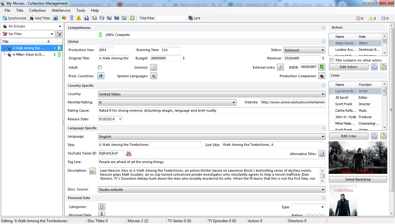

Re: Empty monitor folder causes weird situation
Kick4U,
Can you provide some screenshots of how you have this title configured in My Movies Collection Management? I'd like to set up some similar titles in my collection to test with, and I want to make sure I replicate what you have.

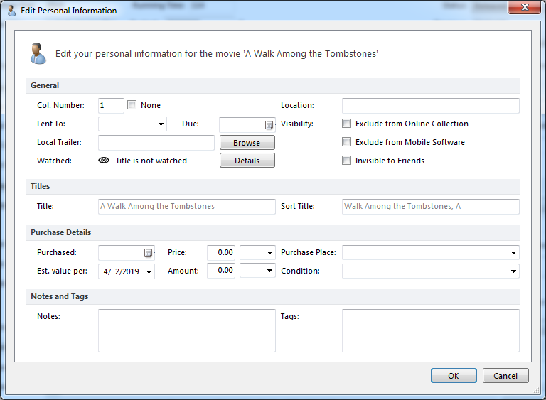

Here are the screenshots for the same film.
Thanks for the screenshots. That's about what I expected. I don't have any in my collection like this, so I'll set some up to do some testing.
