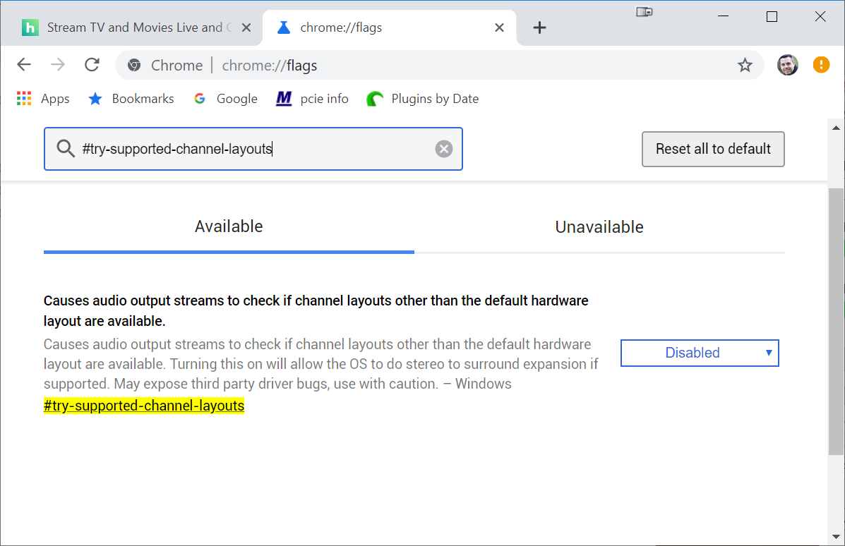

Here's a screenshot of the setting. Note that it is disabled in my screenshot, and you'll want to enable it. Google cautions you that it "may exposed third party driver bugs, use with caution."

Just FYI: This is what work for me.
In the Chrome URL enter chrome://flags
Then enable the #try-supported-channel-layouts flag, and relaunch.
