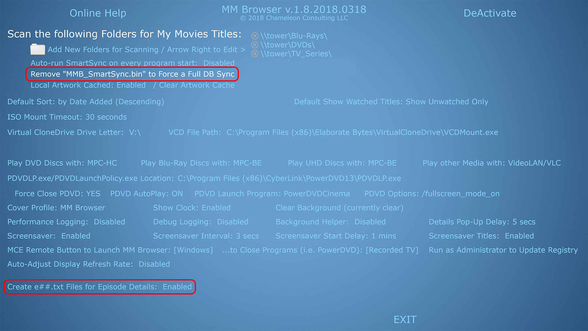

Since you've already added the Episodes to the discs in the previous section above, and My Movies has updated the mymovies.xml <title> meta-data files with the list of episodes, the next step is to enable "e##.txt" file generation in MM Browser, then run a full Sync.
On the Settings panel, at the bottom you need to set "Create e##.txt Files for Episode Details:" to Enabled and Save the change. When you first turn on this option, you will also need to select "Remove "MMB_SmartSync.bin" to Force a Full DB Sync".
Configure MM Browser to create the &quot;e##.txt&quot; files, and to perform a Full Sync.
Configure MM Browser to create the "e##.txt" files, and to perform a Full Sync.
Now run a Full Sync.
MM Browser will see the updated <title> meta-data files, which will reference episodes you just configured, and MM Browser will check to see if the "e##.txt" files exist for each episode. If they don't exist, MM Browser will create the files for you in the same folder with the ISO files.

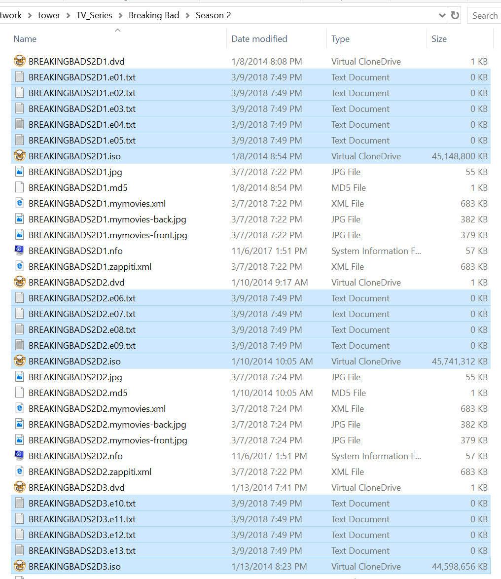

After the Sync, you can verify the success of the file creation in 2 different ways. One way is you can look inside the folder where the DVD ISO lives, where you should now see the *.e##.txt files, like this:
Verifying that the &quot;e##.txt&quot; files are created in your media folders.
Verifying that the "e##.txt" files are created in your media folders.
Notice that the episodes are linked to the correct discs, due to your hard work when you assigned the Episodes to discs earlier.

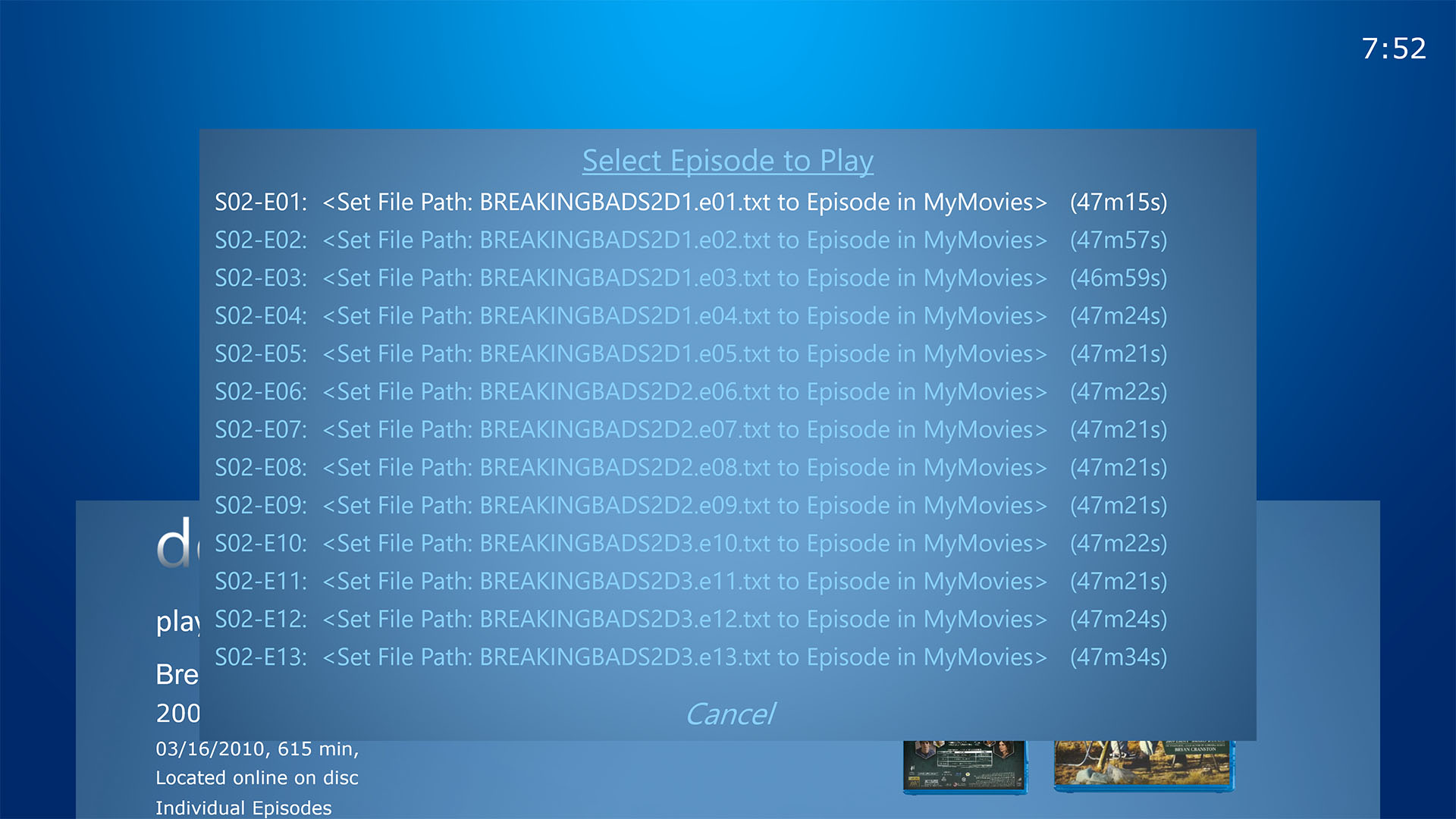

The other way to verify is you can attempt to play the Episodes in MM Browser, and instead of Episode Names, you will see instructions, like this:
If &quot;e##.txt&quot; text files are created but not assigned in My Movies, you will see additional instructions on the Select Episode panel.
If "e##.txt" text files are created but not assigned in My Movies, you will see additional instructions on the Select Episode panel.

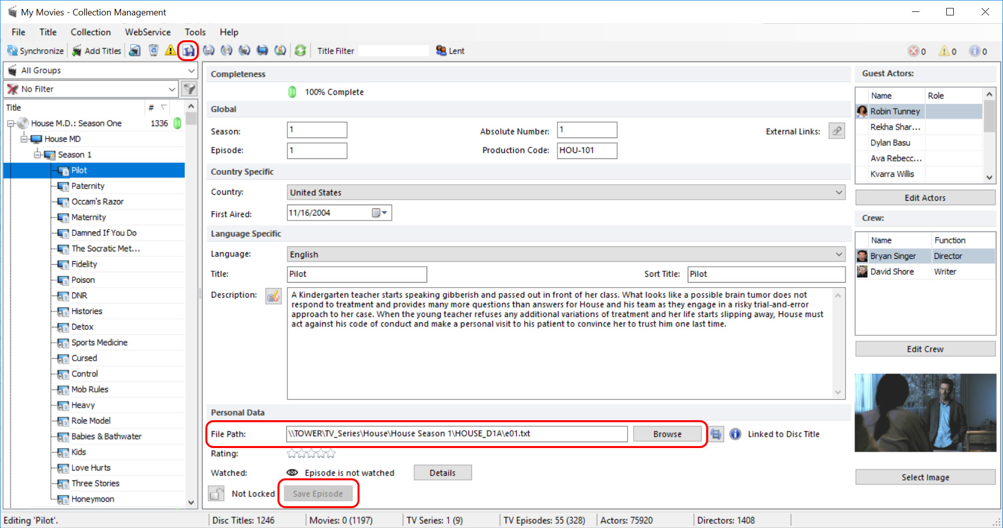

Now that you've run a Sync and created the "*.e##.txt" files, you need to assign them to Episodes. Go back to My Movies Collection Management and select your Title.
Click the plus sign to drill down to the TV Series, then again to drill down to the Season, then again to drill down to the Episodes.

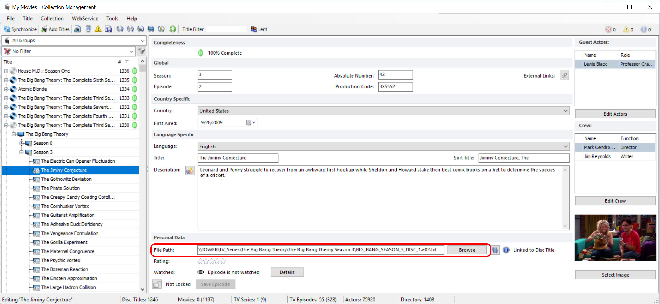

For each Episode, you will need to select it and then assign the corresponding "e##.txt" file to the "File Path". The easiest way to do this is to hit the Browse button and navigate to the correct file and select it.
Assign the &quot;e##.txt&quot; files to each Episode in My Movies.  Note:  This one is for a DVD Folder.
Assign the "e##.txt" files to each Episode in My Movies. Note: This one is for a DVD Folder.
Do the same for DVD ISOs, though note that the e##.txt file uses the ISO FileName.
