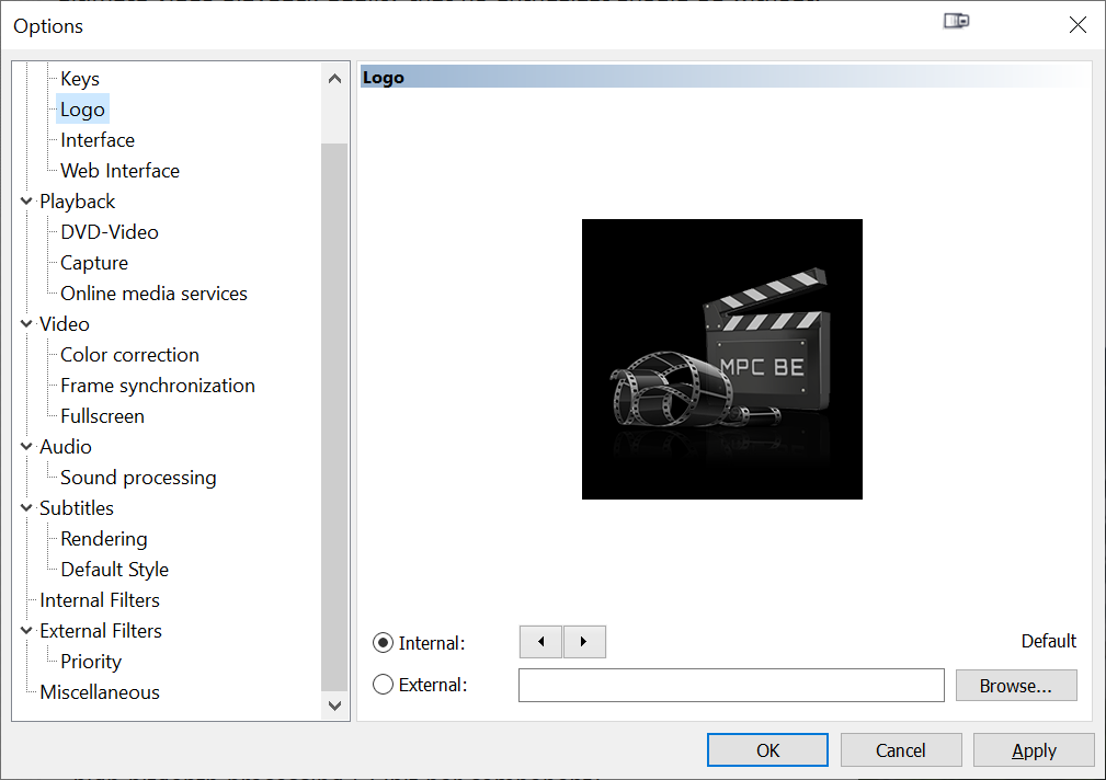

Getting rid of the ugly startup logo
No doubt if you use MPC-BE with CMC, you've noticed that the MPC-BE logo shows every time CMC calls MPC. Perhaps it wouldn't be so bad if the logo looked nicer, but I find it to be an especially ugly logo. Luckily, it is easy to disable the logo.

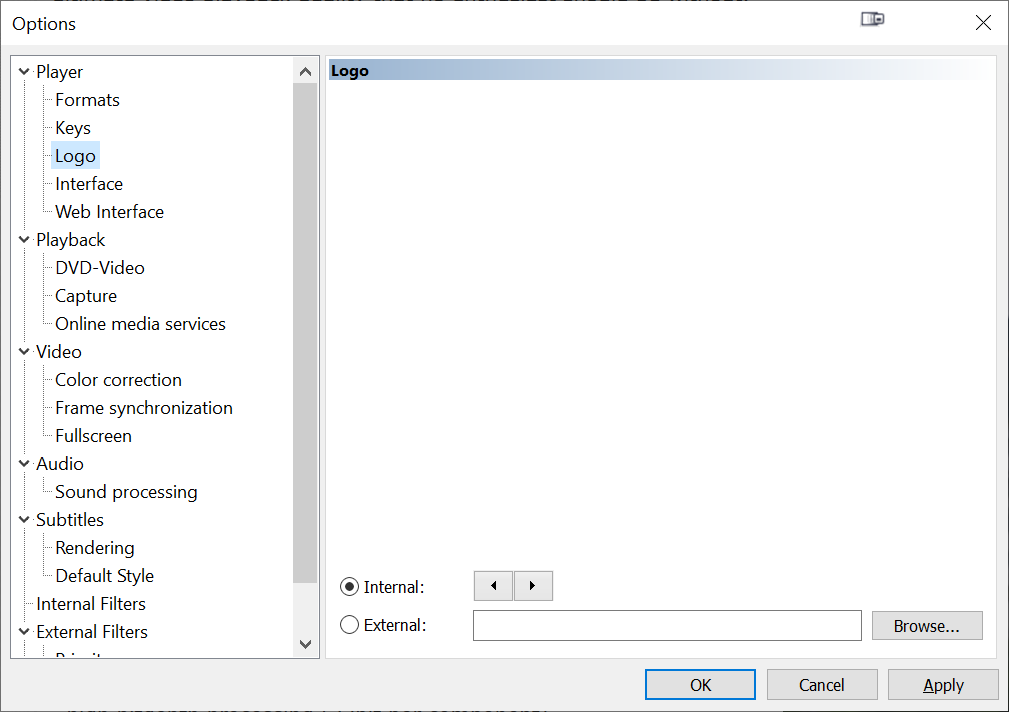

From the MPC menu, go to View > Options to open the Options window, and then select Logo in the Player section (shown above). Here you can specify your own logo, or to simply disable it press the right arrow button, and the default logo image will disappear. Press OK or Apply to save this change.

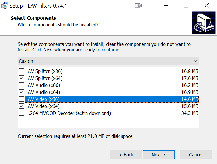

After downloading, run the installer file. You can accept the installation defaults for all settings, though if you are only running MPC-BE 64-bit version, you can uncheck the 32-bit components (x86), as shown here:
Finish accepting the defaults and complete the installation. Don't worry about configuring it at this time, that comes later.

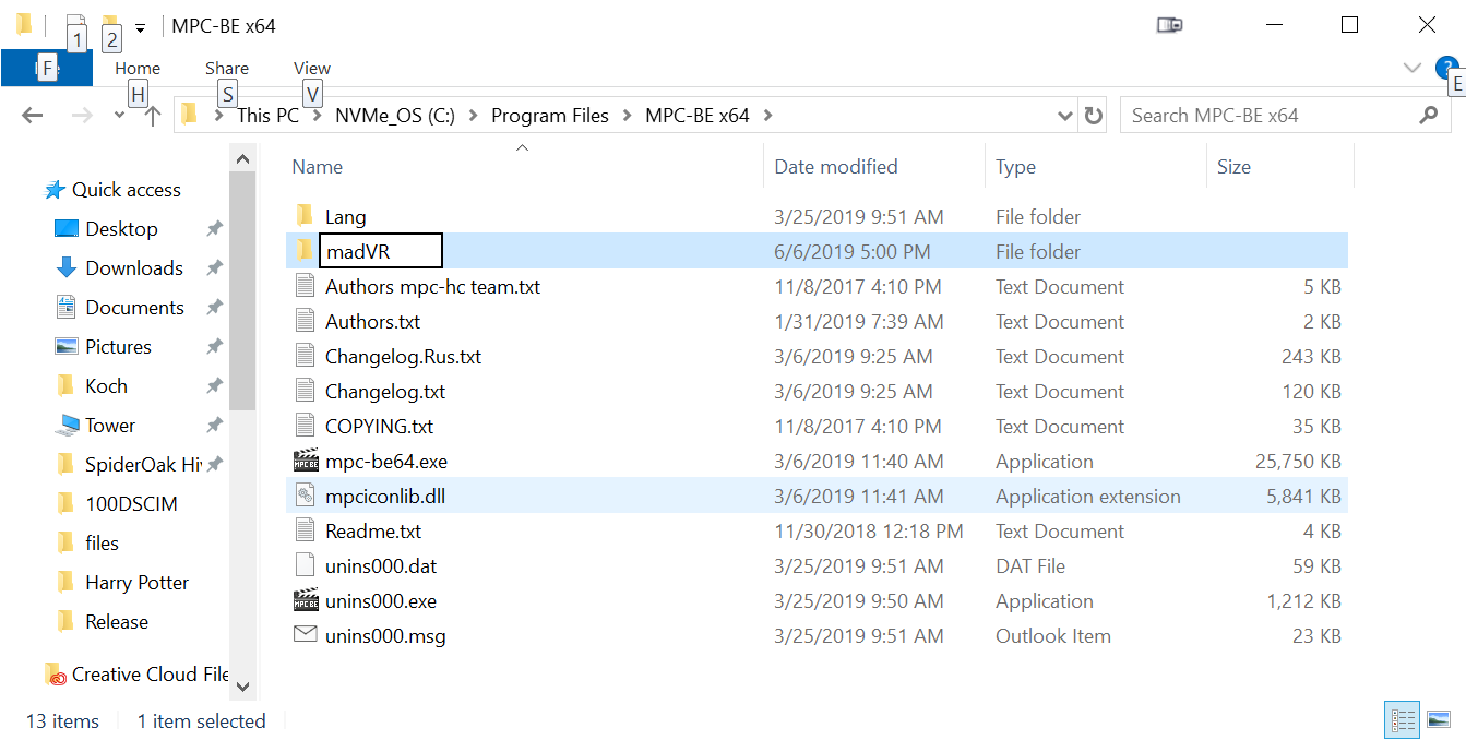

Next navigate to MPC's program folder (i.e. C:\Program Files\MPC-BE x64), and once there create a new folder named "madVR" as shown here:

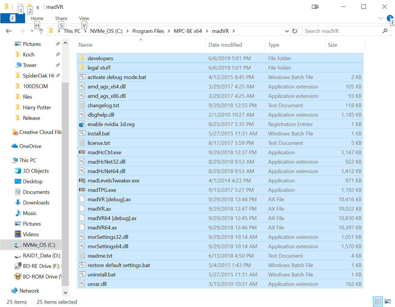

Then open the madVR zip file you downloaded, and extract the contents to the new madVR folder you created above. Note that since you are working inside of a protected path, Windows will require that you provide administrator rights to create the folder and unzip the madVR files into it.

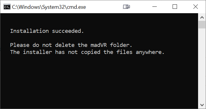

Next find the "install.bat" file among the files you just unzipped, right-click it and select 'Run as administrator'. A DOS window will appear almost immediately showing the following message if it was successful (press any key to dismiss the window):
This completes the installation of madVR.

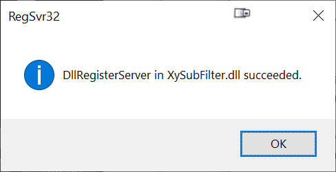

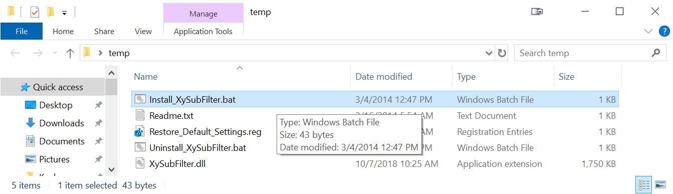

Next open the zip file and unzip the contents to a temp directory. Then right-click on "Install_XySubFilter.bat" and select 'Run as administrator'.
If installation was successful you should see the following message window:

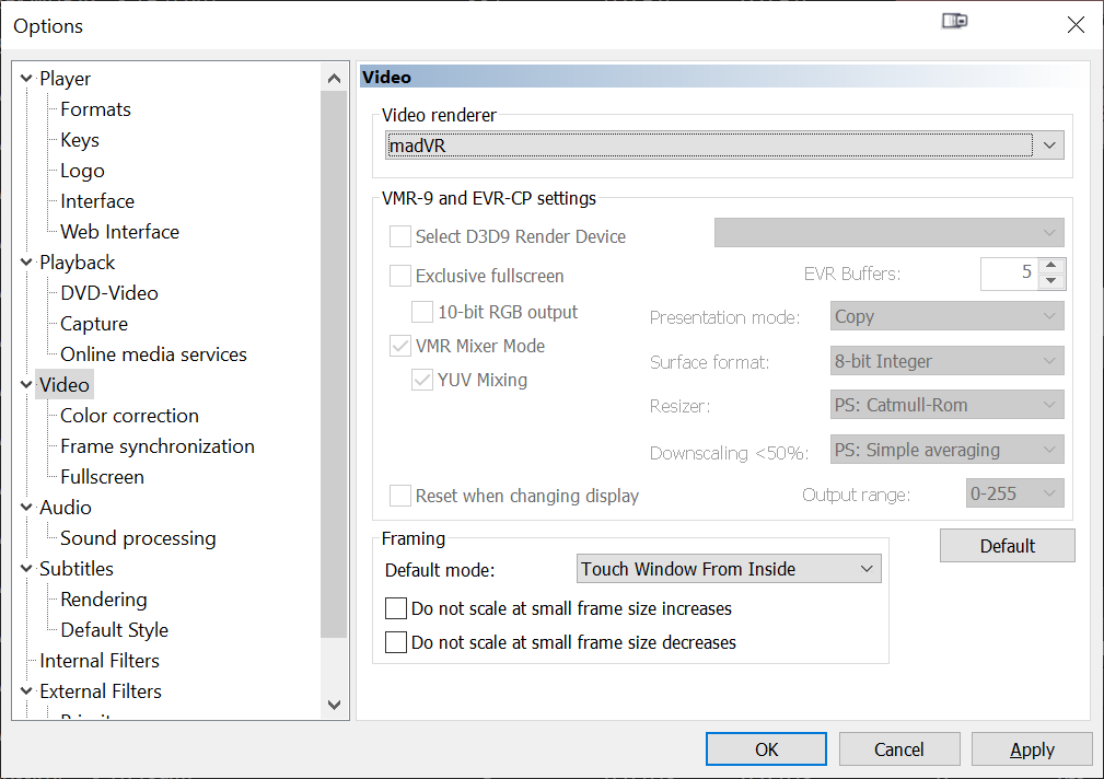

Now that everything is installed, the next step is to configure all the enhancements. Go ahead and launch MPC-BE, then select View > Options, and finally select the 'Video' heading from the list of options on the left. There change the 'Video renderer' option at the top to 'madVR', as shown here:

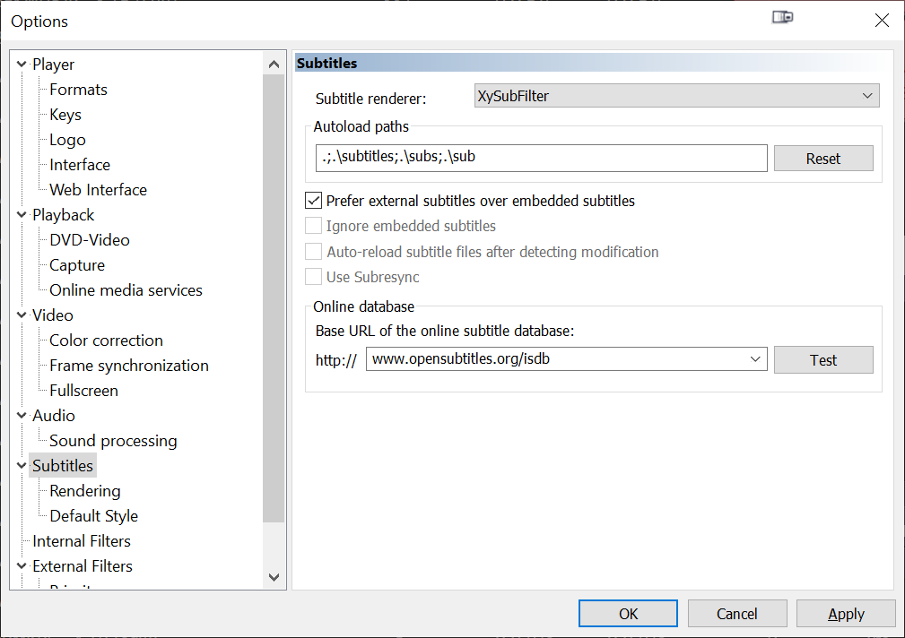

Then select the 'Subtitles' heading on the left, and change the 'Subtitle renderer' to XySubFilter, as shown here:

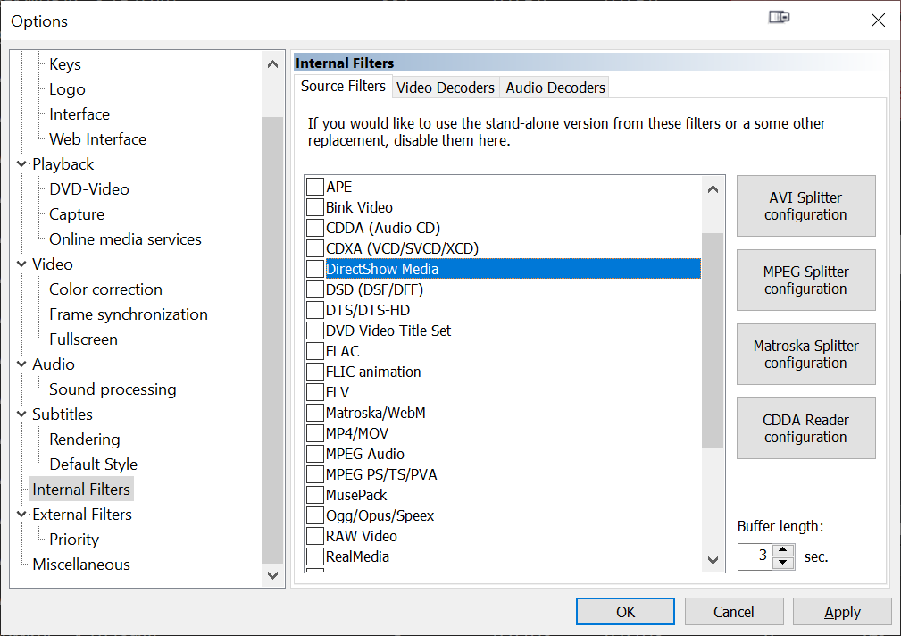

Next you'll need to disable the Internal Filters, so that the new LAV Filters / madVR can take their place. Select Internal Filters from the option list on the left. You'll need to uncheck all the filters listed on the Source Filters tab. TIP: If you right-click in the filter window, there's an option to 'Disable all filters' so you don't have to click several dozen individually.

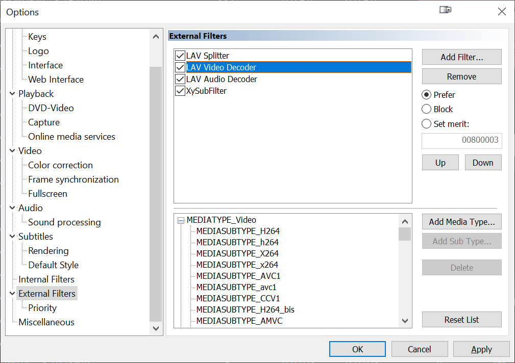

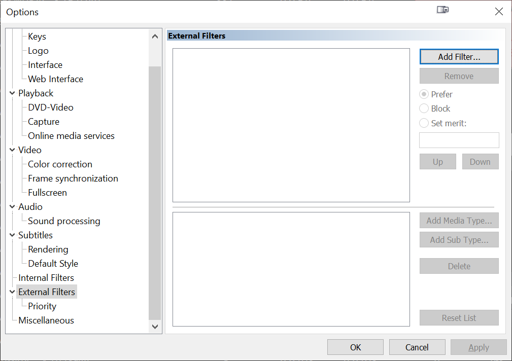

Now it is time to add the new external filters. Select 'External Filters' from the option list on the left, and then click 'Add Filter...'
Add the 'LAV Splitter', 'LAV Video Decoder', 'LAV Audio Decoder', and the 'XySubFilter'. Then using the Up/Down buttons, make sure that they are listed in the order shown here:

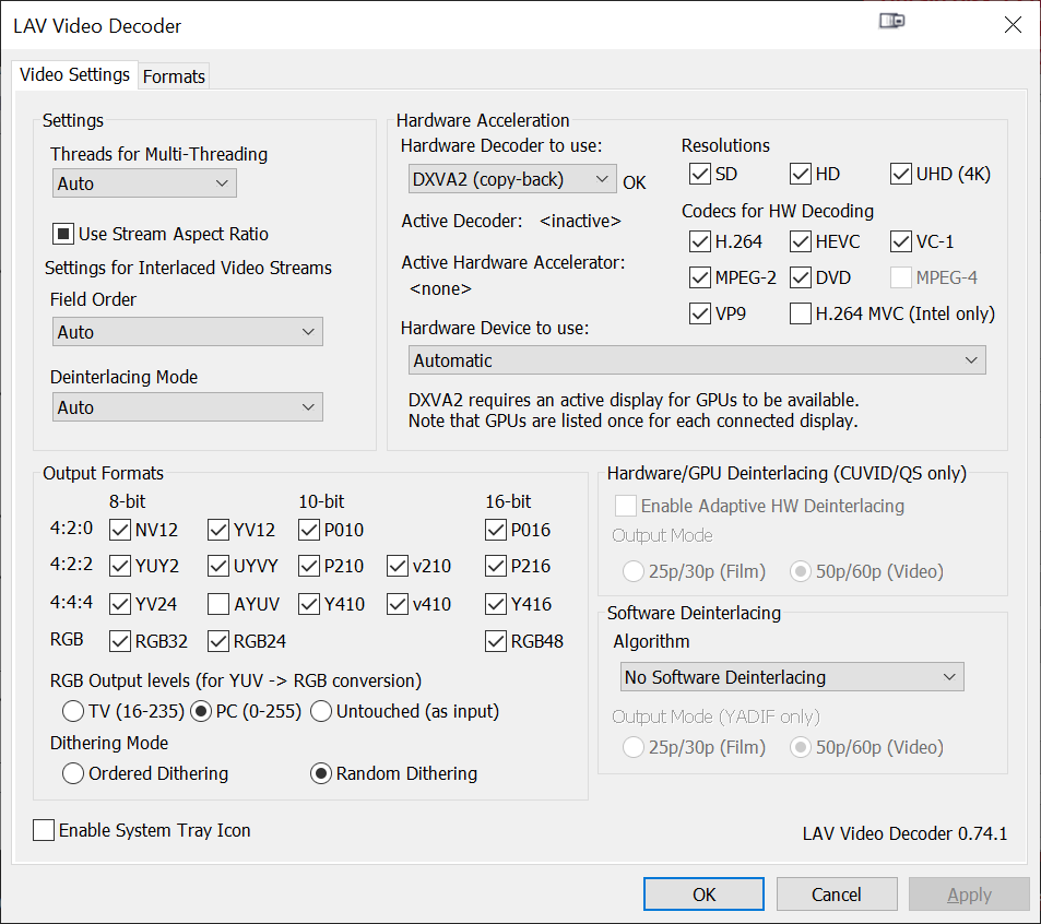

Next we need to configure the LAV Video Decoder to enable hardware acceleration. Double-click on 'LAV Video Decoder' in the list, and this will open the properties page shown below. Here you need to change the 'Hardware Decoder to use:' from 'None' to your preferred decoder ("DXVA2 (copy-back)" seems to be a good choice here):

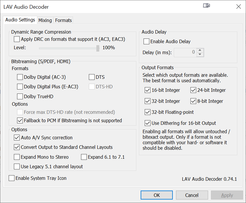

Press OK to save your Video Decoder configuration change. Next double-click on the 'LAV Audio Decoder' to configure the audio settings. Here you can configure things like Dynamic Range Compression, Bitstreaming, Output formats, Mixing, and more. Every PC and Home Theater setup is different, so I won't make any recommendations here - you need to figure out what settings work best for your system.
