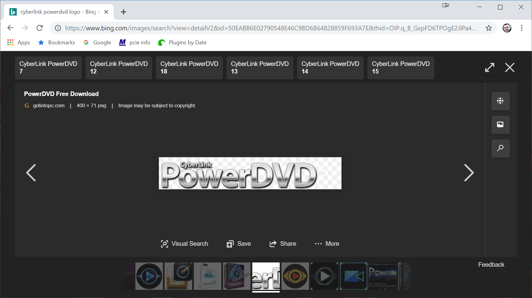

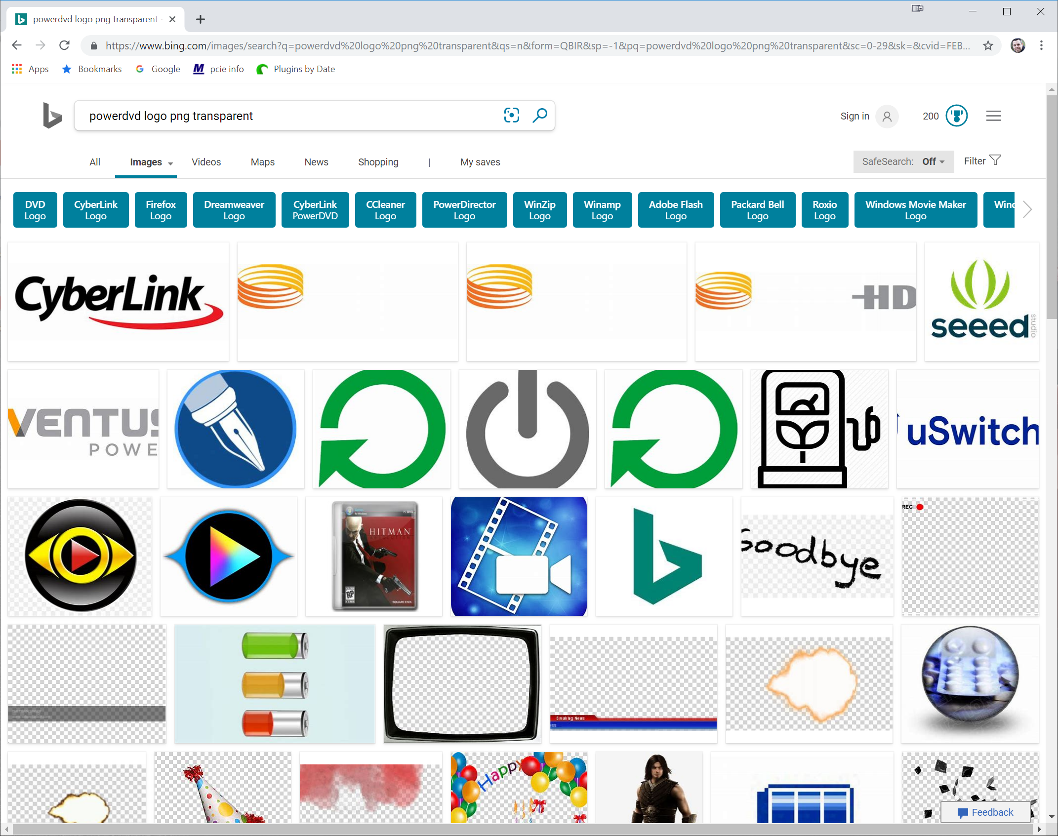

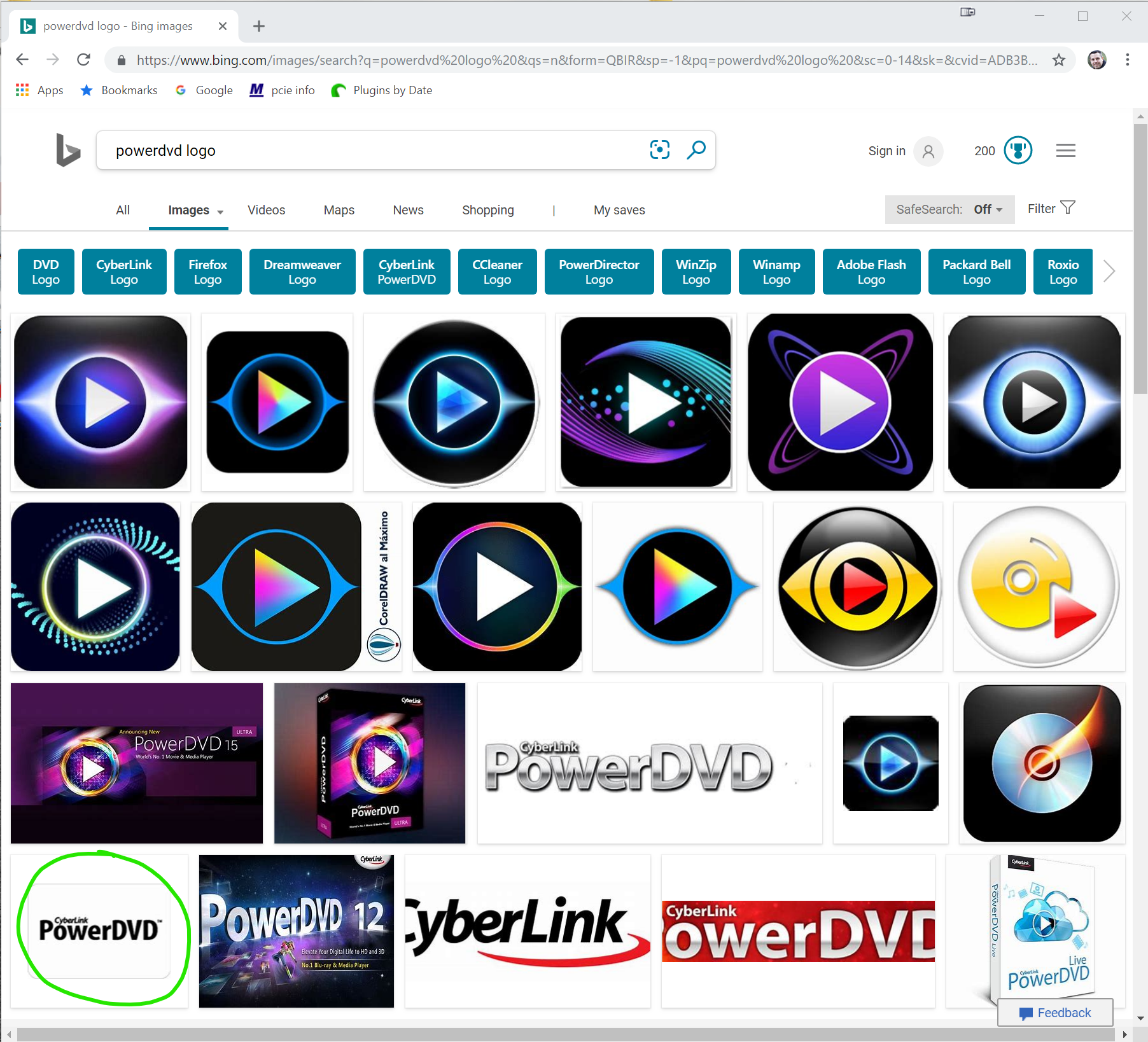

While you can use nearly any method you want for finding a good graphic, I personally like Bing's image search. For my initial search, I'll include terms like "logo", "png", and "transparent", as finding a transparent PNG file will save me some work. Often this search returns the perfect result, but this time searching for "powerdvd logo png transparent" doesn't have any good candidates, except for perhaps the CyberLink logo itself:
So I modify my search, and instead just search for "powerdvd logo", and get more results. At the top are quite a few fancy PowerDVD logos, but none of these are good candidates as they have too much design to them, and won't look good as a monochromatic logo. I need something simple, that will look good and legible in black and white. Surprisingly, the best candidate this time is an old CyberLink PowerDVD logo already in black and white, circled at the bottom left, but unfortunately the resolution is a bit low. The External Link logos for CMC need to be 256 x 256 pixels, and this logo is only 150 pixels wide.

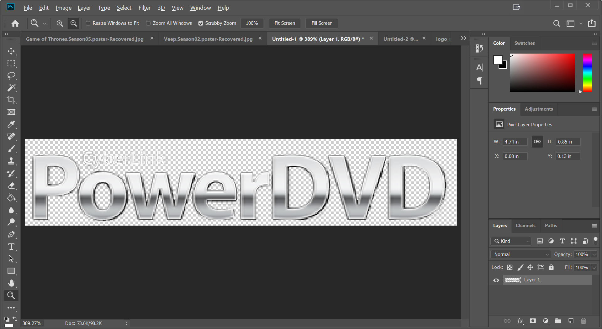

Looking around a bit more, I find a larger version of the same basic logo, but with a fanciful chrome reflection effect and drop shadow that need to be removed. More work, but the end result will look better since I'm starting with a higher resolution graphic.

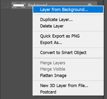

I save the image to my PC and open it in Photoshop. The first thing I need to do is remove the white background. If the image opens up as a single "Background" layer, the first step will be to convert the background to a layer. Do this by right-clicking on the Background layer and select 'Layer from Background...'. You won't be able to make the background transparent unless you do this step (and you wouldn't even have to do this step if you'd found a transparent PNG to begin with...):

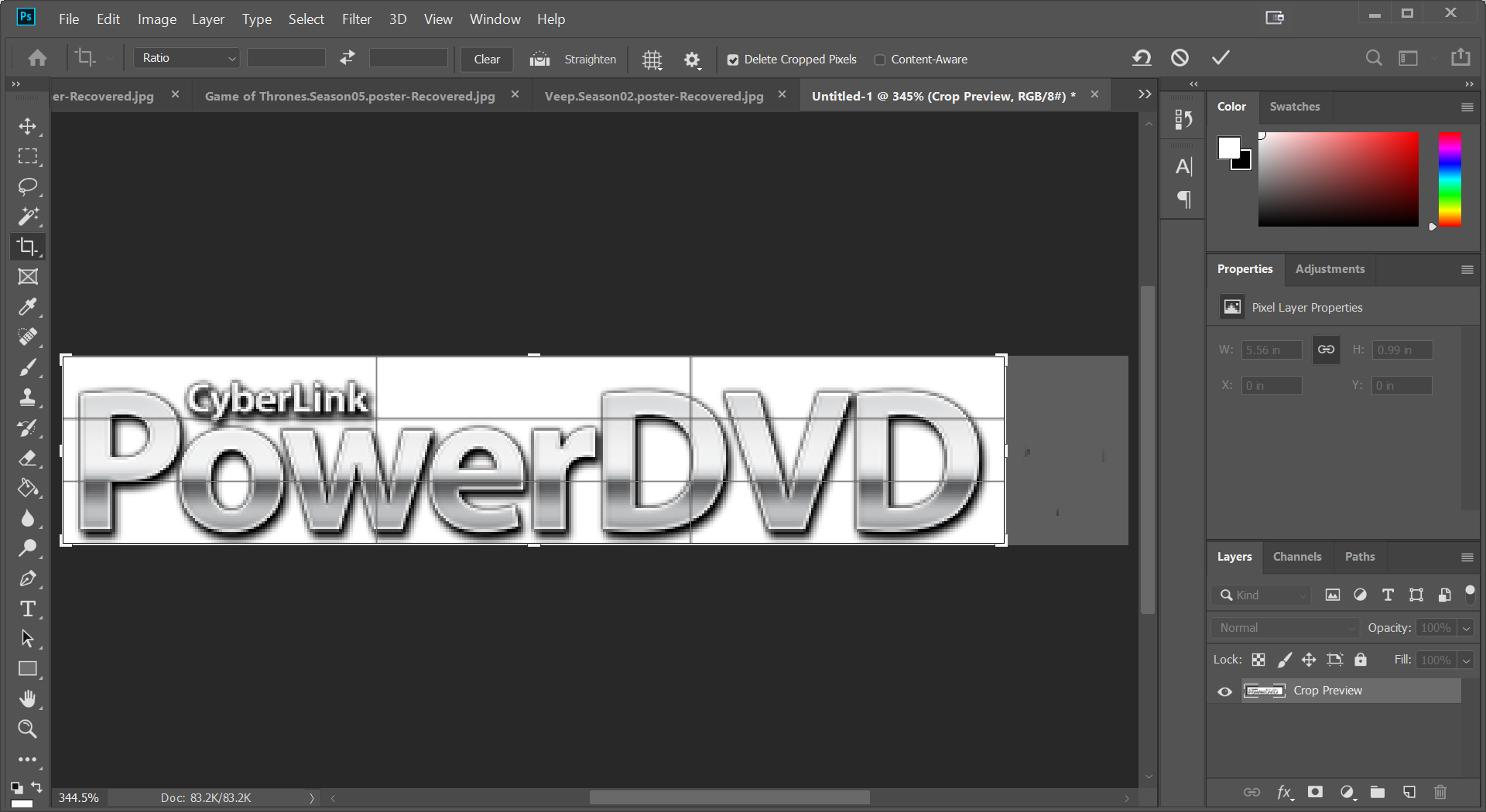

My next step is to do an initial crop just to remove some extra pixels on the right side and get rough starting point for the logo shape - in this particular logo this empty space has some garbage data in it that won't make it into the final image, so might as well remove it now. We'll do a final crop later, so this doesn't have to be perfect:

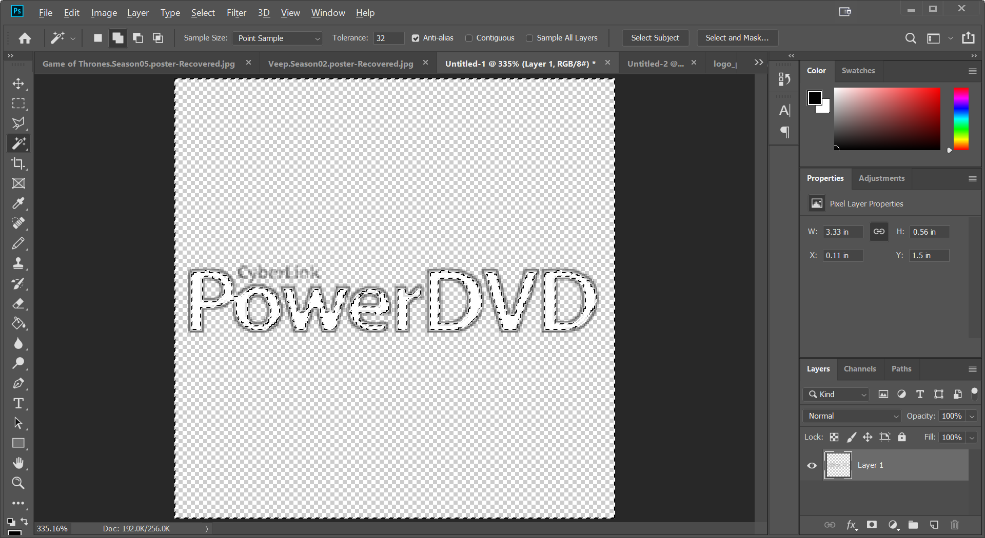

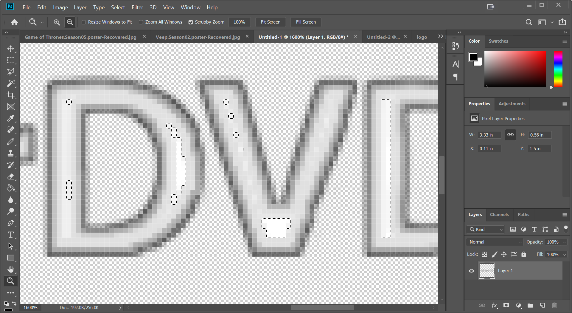

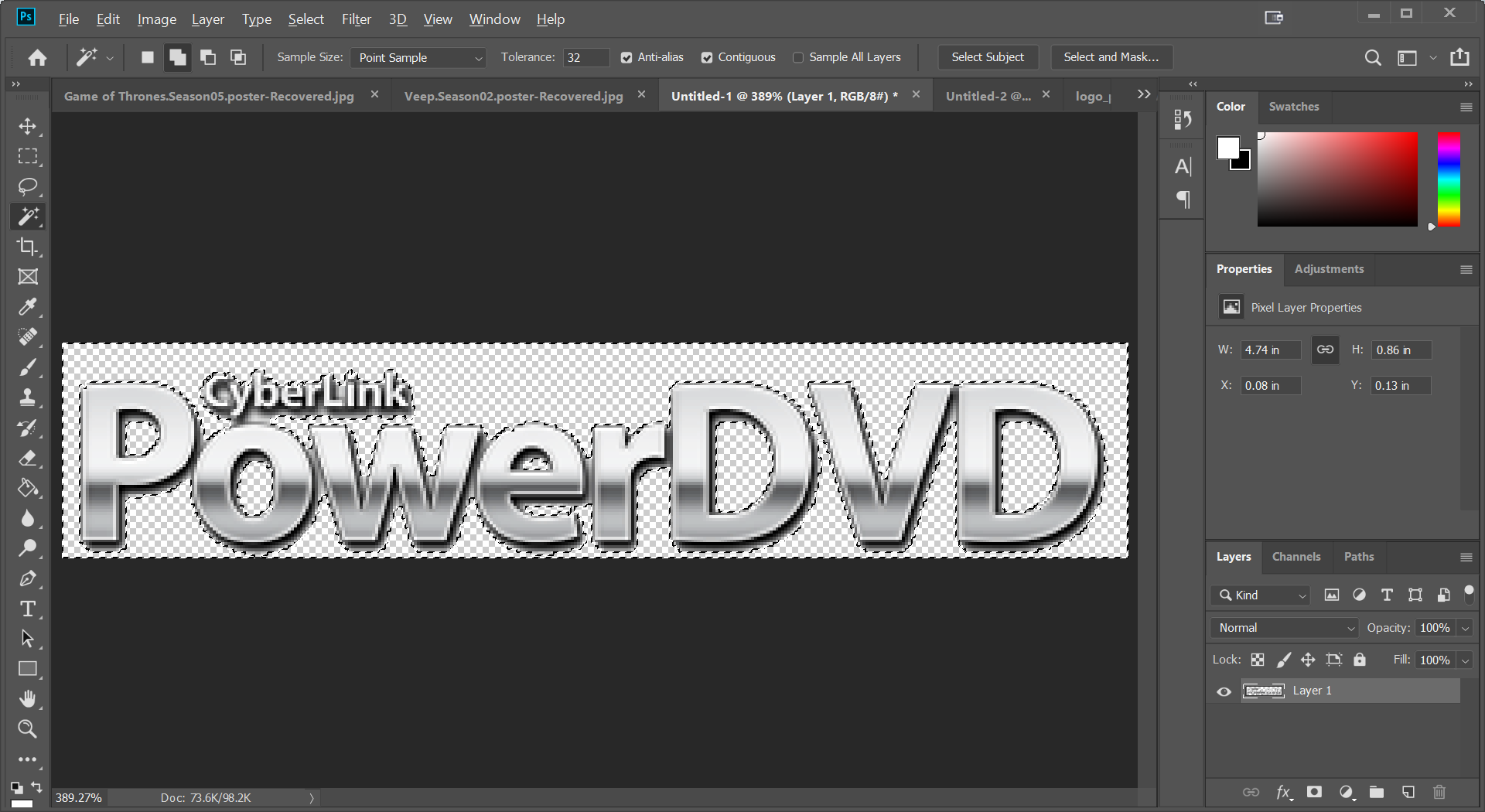

Next I use the Magic Wand selection tool. I set the options to 'Add to selection' (so I can click multiple areas separately and add to the previously selected areas), a Tolerance of 48 so that I can get some of the shadow with the white backdrop, and make sure 'Anti-alias' and 'Contiguous' are selected - having Contiguous enabled will prevent the selection from grabbing lighter parts of the logo from inside the letters. You should adjust all of these numbers for each logo as needed to get the best results. With Contiguous selected, I'll have to click the inside sections of the letters P, D, o, and e. Then I can hit Delete on the keyboard and the selected white background will be removed, replaced by a gray and white checkerboard - this lets you know the background is now transparent.

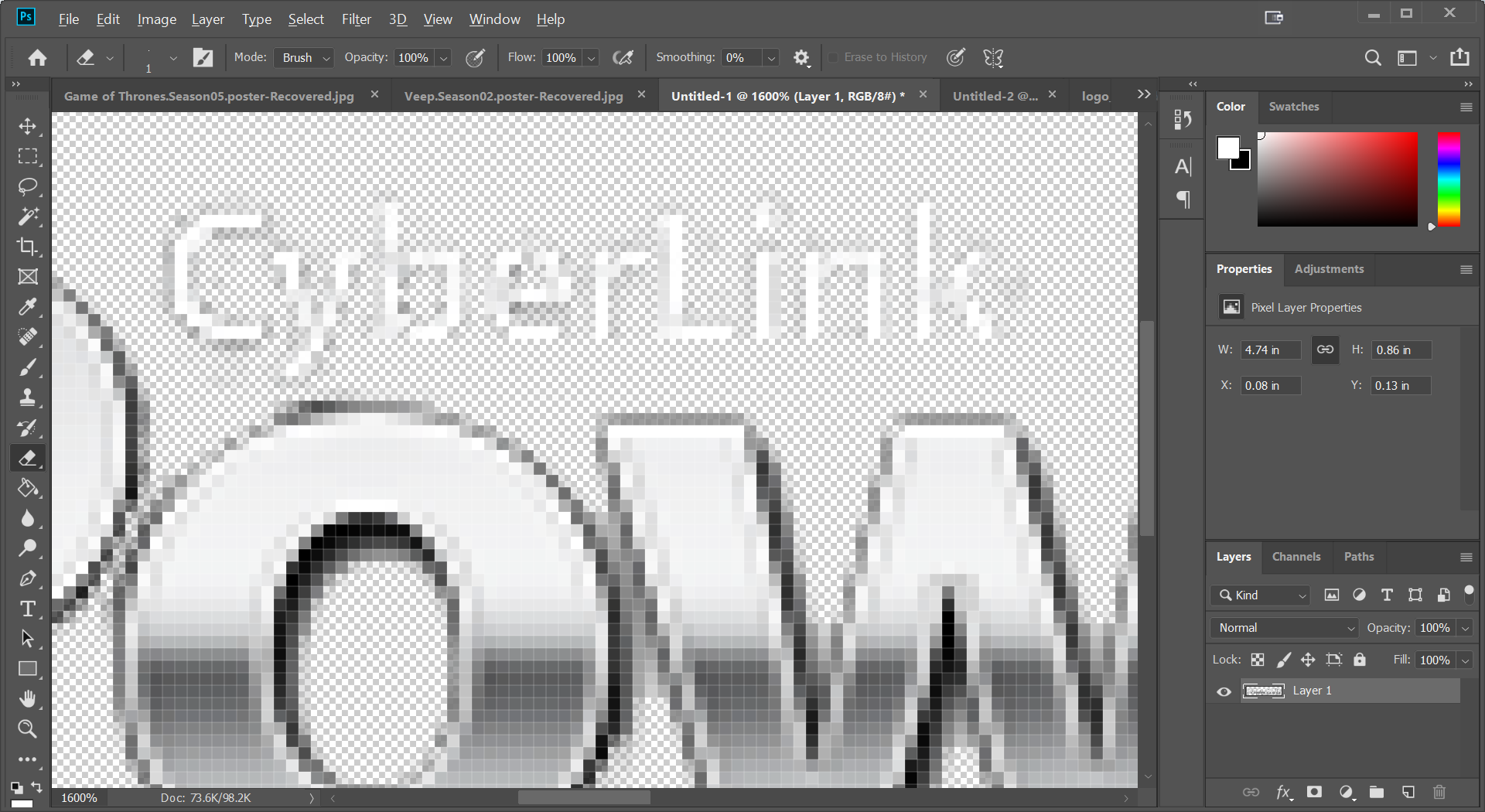

While most logos won't require this much work (TIP: Use a better logo to begin with if you can!!!), I don't like all the drop shadow on this one, as it's going to look bad once I convert this to black and white. So the next step is to select the Eraser tool and do some manual cleanup of the drop shadow areas. This takes a steady hand, but the job is made easier if you zoom in really far. Since I started with a higher resolution image, some of this detail will be lost when it is resized down to 256 x 256, so I don't need perfection here. Mainly, my goal is readability, and to have clearly separated characters without the drop shadow connecting them, otherwise this graphic will look like a big blob once converted. I pay extra attention to the small CyberLink logo to clean out the drop shadow:

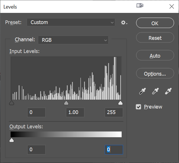

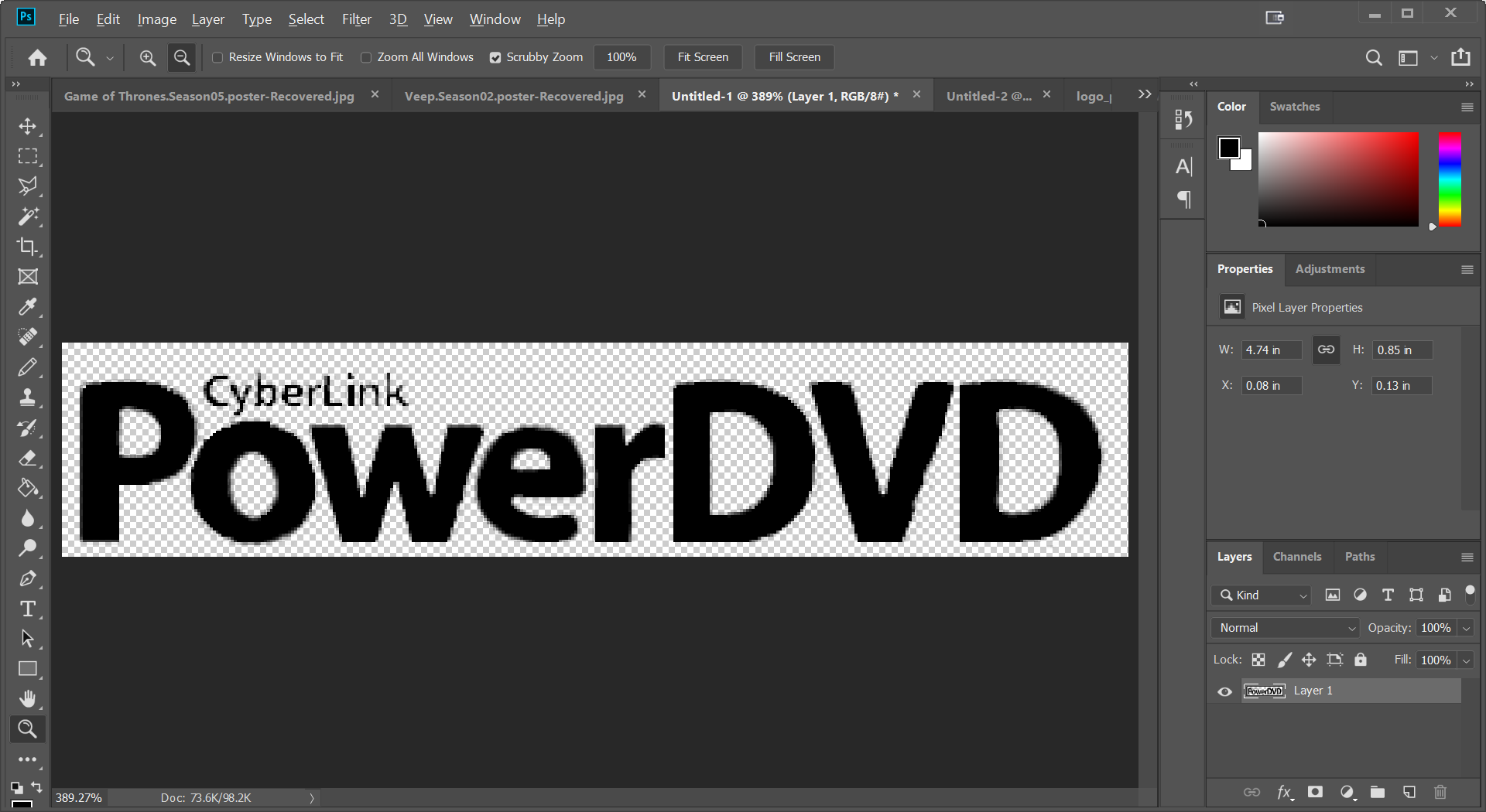

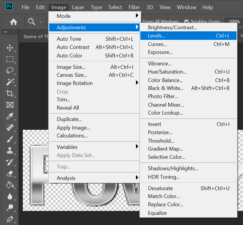

At this point, I would normally go ahead and make the logo white, but since this is an especially bad logo to work with, I'm going to do the extra step of making it black first - this makes it easier to see than white - so that I can do a bit more cleanup of the logo shape. To do this, I go to Image > Adjustments > Levels:
On the Levels panel, I set the 'Output levels' (at the bottom) both to zero:

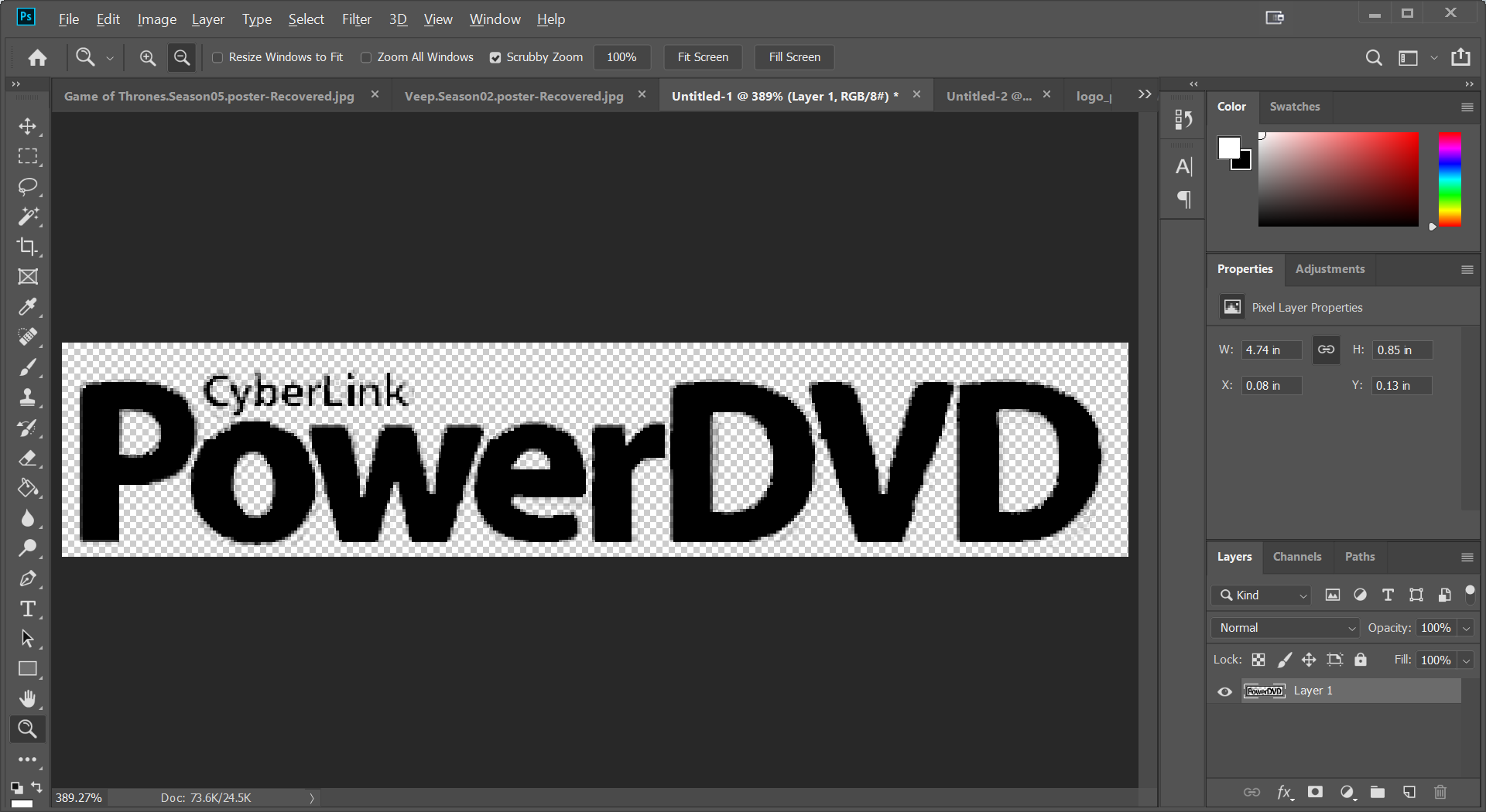

This makes the logo fully black, and I can now see some rough edges that I want to clean up.

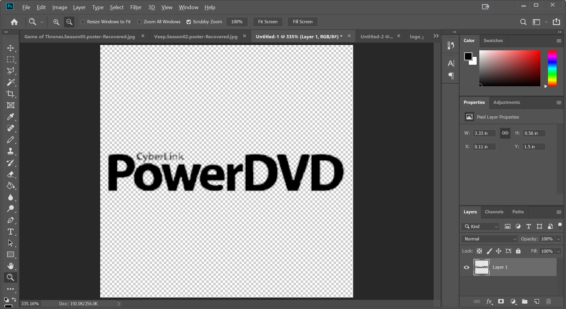

I continue to use the eraser to remove, and a pencil set to black to add, until I'm happy with the general shape:

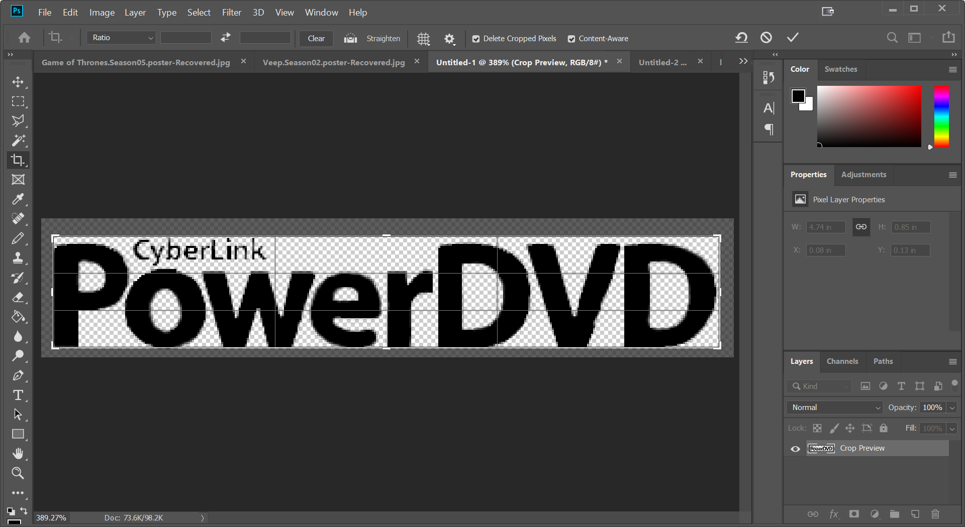

Before resizing, I will do a final crop, which will let me make sure the logo is properly centered and that I'm getting the most detail out of the image, instead of including unused background in the resizing step. I like to use the 'Content-Aware' feature of Photoshop's crop tool, which let's me snap to the edges of the logo:

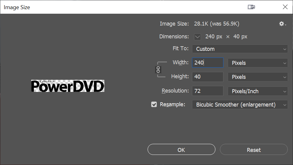

Next I resize the image to near final resolution. I don't want the logo to completely fill the 256 x 256 square - I like to leave some buffer at the edges, so instead of going straight to 256 pixels, I resize slightly smaller, to 240 pixels. I also like to use the Bicubic Smoother resampler, as I'm going for smoother not sharper:

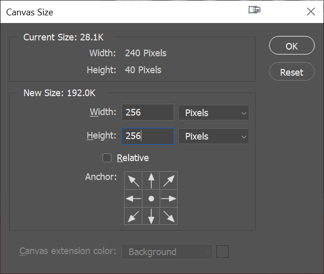

My image is now 240 x 40, smaller than my target size of 256 x 256. Instead of resizing to fit the target, I simply want to expand the background to fill up the remaining space. I go to Image > Canvas Size and set it to 256 x 256, making sure that the expansion originates from the center:
Now I have a square logo, with most of the logo being a transparent background:

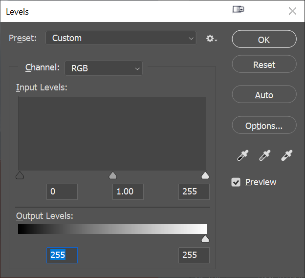

I go back to Image > Adjustments > Levels, and this time I set the Output levels both to 255, making the logo white:
As you can see, the white logo is much harder to see and work with, which is why I did the optional step of making it black above to do some more cleanup:

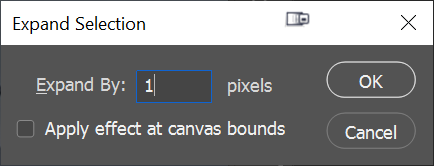

I want to expand this selection to include the edges of the logo, so I go to Select > Modify > Expand, and do an Expand by 1 pixel. This expands my selection to include all of the background, plus a 1 pixel outline of the logo edges:

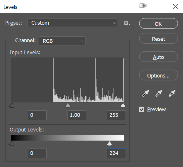

Now to darken just the edges, I go back to Image > Adjustment > Levels, and set the Output Levels to 0 and 128. Technically, this darkens the background too, but because the background is invisible, only the logo edges are darkened:
I then repeat this process of expanding the selection, and darkening what is selected. For the second pass, I'll again expand by 1 pixel (so effectively I've selected the outside 2 pixels of the logo egdges), then use the Levels to darken to 0 and 192:
Finally I make a 3rd pass, this time expanding by 2 pixels (so effectively I've selected the outside 4 pixels of the logo edges - which is now almost the entire image except for some central hotspots), and setting the Levels to 0 and 224:

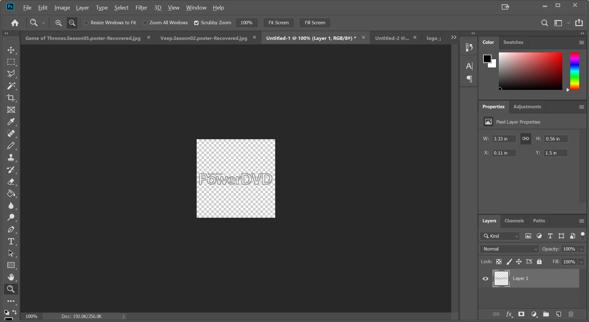

And here is the final image at 100% zoom:

And attached here is the finished PowerDVD logo:
