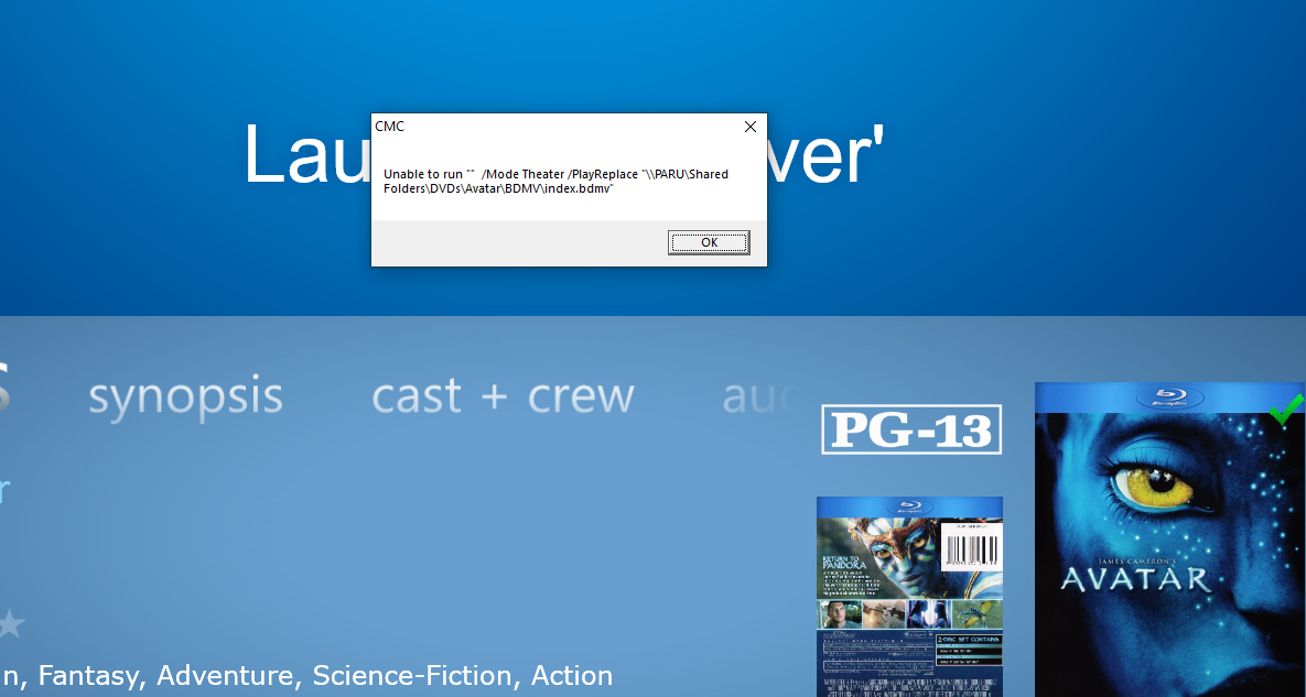

The problem that I'm having now is I can't launch jriver to play any of my blu-rays, and I'm at a loss on how to fix it. All my movies are ripped one to one as folder structures. I know that Jriver is working because I can play Blu-ray movies and dvds when I'm in theater view. I've attached a screen shot of the error that I'm getting. MPC-BE works and will launch and play a dvd although it's difficult to navigate it because come of the commands are not mapped properly to it, and I don't know how to do that. It's a little frustrating.

The problem is that CMC is not finding your JRiver installation. You can tell from the error message, which has quotes with nothing inside right after 'unable to run' - that's where the file path to the JRiver executable should be.
What's the file path to the JRiver install? And what version of JRiver do you have?

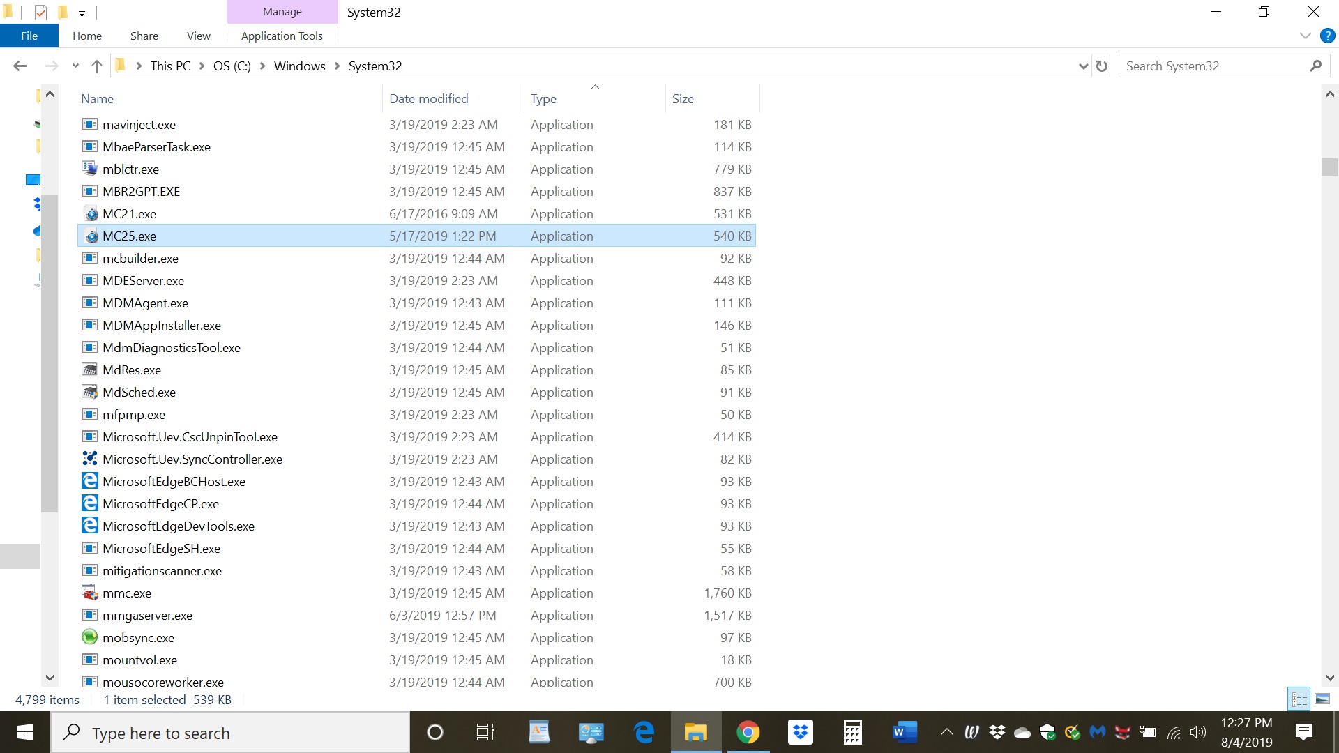

Post by Jamie » Sun Aug 04, 2019 12:35 pm
Hi TeddyBoy,
Listen to Paul. You should have an MC24.exe in C:\windows\system32. How else are you supposed to launch it anywhere on your PC? I have both MC21.exe and MC25.exe. See screenshot. I don't think 64 bit matters but I have been wrong in the past :D :D .

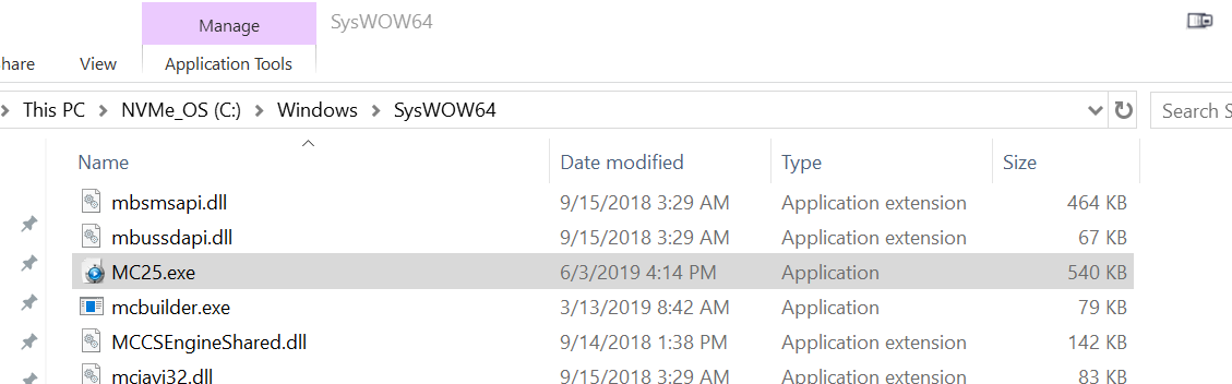

Post by Pauven » Sun Aug 04, 2019 12:41 pm
I just checked, and I have MC25.exe in both System32 and SysWOW64:
I think CMC is only looking in System32, so if you have it only in SysWOW64 that could explain why CMC is not finding it.
