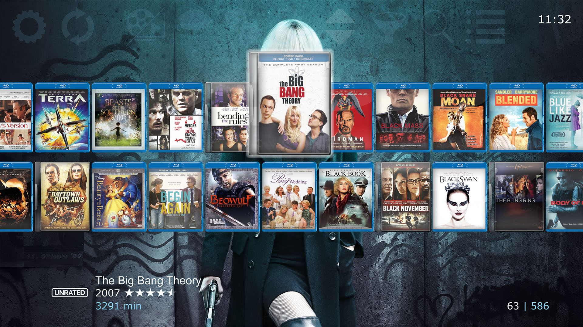

In MM Browser, TV Series are displayed inline with Movies and other content. If you are displaying all titles, you will see Movies and TV Series side by side, intermingled.
TV Series shown Inline with Movies

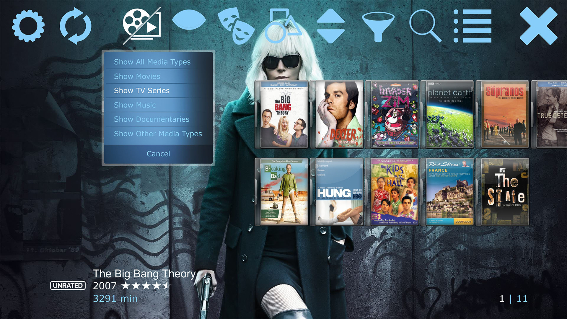

If you just want to see Movies or just want to see TV Series, the Media Type filter will allow you to do this.
Media Type Filtering on TV Series

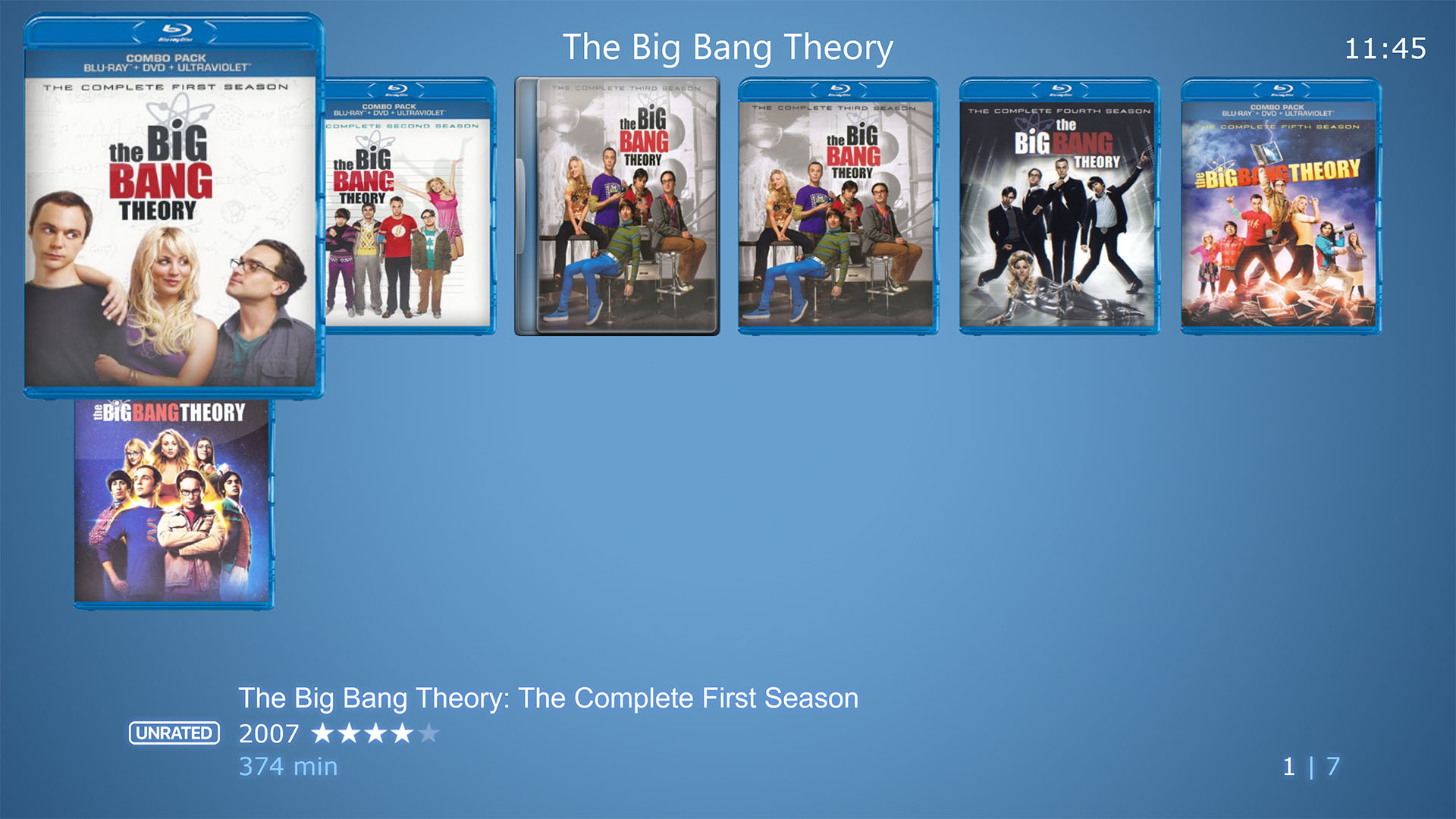

When you select a TV Series in MM Browser, it will open up like a Box Set, displaying all titles in your collection that belong to that TV Series. We call this "TV Series Grouping". This Box Set style grouping behavior is for 2 reasons:
  1. If a disc isn't correctly configured for Episodes, then you can still easily access the individual discs for the TV Series. This requires almost no setup in My Movies, so everyone can enjoy TV Series Grouping.
  2. My Movies makes it nearly impossible to export the <Series> version of the mymovies.xml file, which is required to show TV Series information the way it is presented in WMC.
TV Series are presented similar to Box Sets, showing all Titles/Discs that make up the Series

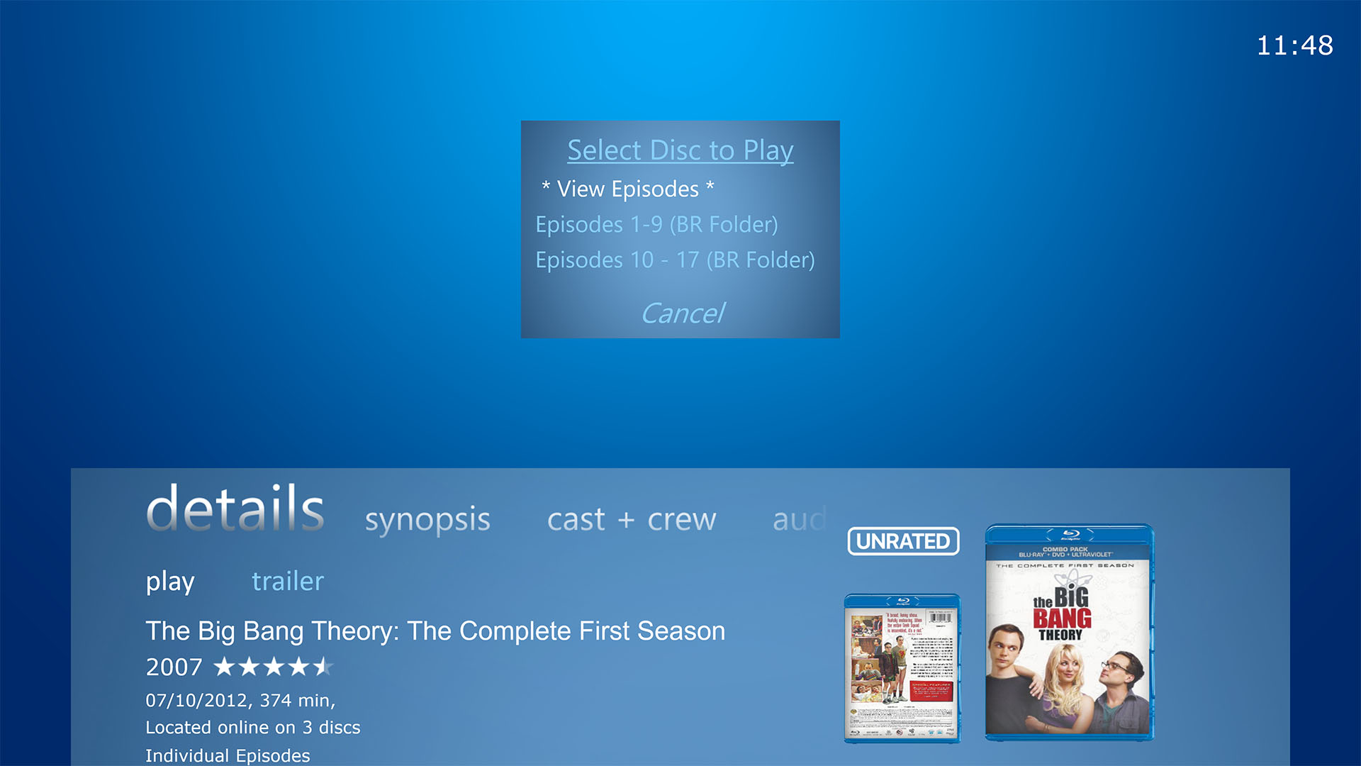

Currently in MM Browser v1.8, to display Episodes you must first Play the title just as you would a Movie. When you Play the title, you will be presented with varying options for selecting what to playback. You might see individual ISO's to mount, and/or individual Folders to play, and/or the option to View Episodes.
Select Play to bring up the Select Discs prompt, with optional View Episodes feature
The important thing to understand here is that MM Browser only displays the options according to what has been configured in My Movies. If you don't see the View Episodes option, then you have not configured Episodes correctly in My Movies. And for some Blu-ray discs, My Movies makes it nearly impossible to correct some of this data.

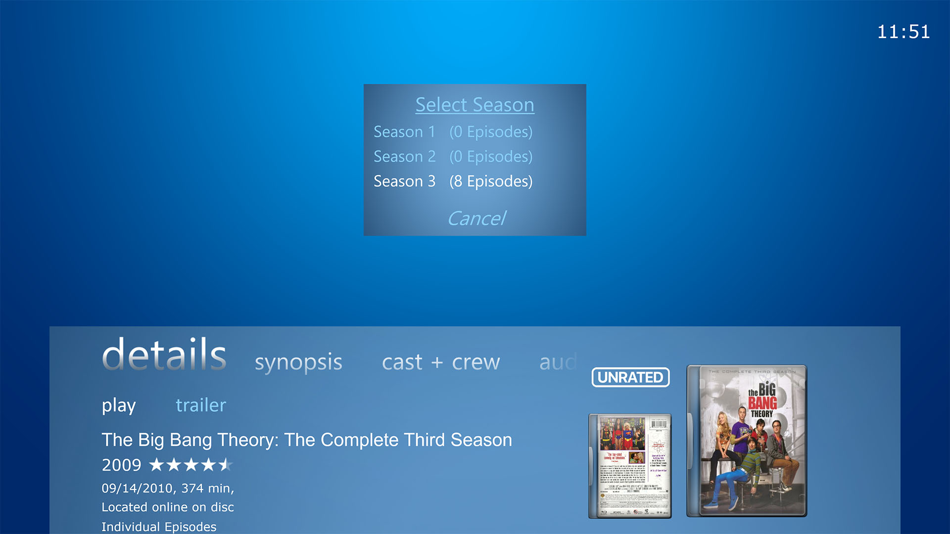

If you do have the View Episodes option, selecting it will allow you to first select the Season, then the Episode. Please note that in version 1.8, currently all prior Seasons are displayed for a given disc, even if they are not playable. For example, if you select Sopranos Season 6, you will see Seasons 1-5 also listed, though they will be empty. In the future, we will be merging the seasons from multiple discs/titles into a single listing, but for now please understand that the Seasons and the Episodes listed and playable will for for that specific Title/Disc only.
Select Season prompt, which shows prior seasons which are currently not selectable

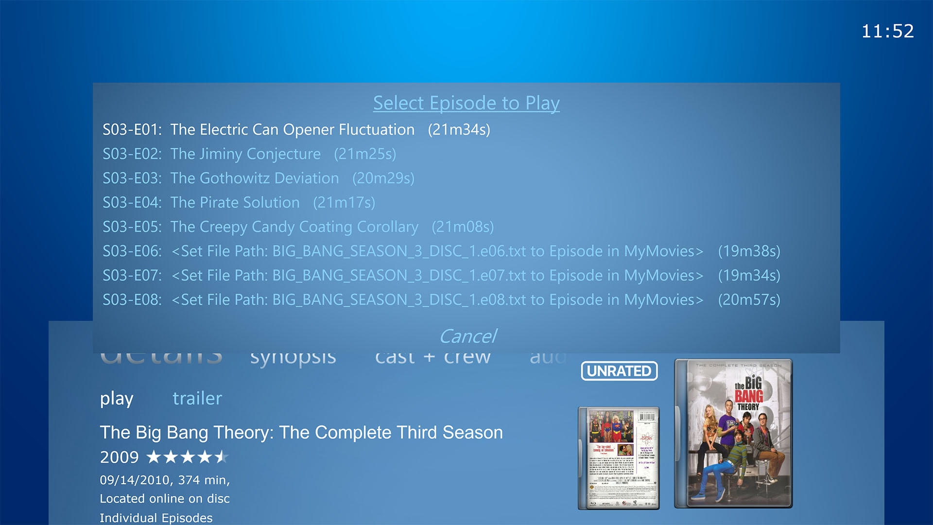

Select Episode prompt.  Note that the &lt;Set File Path... in the Episode Name indicates more My Movies configuration is required.
Select Episode prompt. Note that the <Set File Path... in the Episode Name indicates more My Movies configuration is required.
On the Episode selection screen, the episodes you are selecting from may be linked to individual encoded files (i.e. Sopranos_S1_E07.mp4), DVD Titles, or Blu-ray playlists (MPLS).

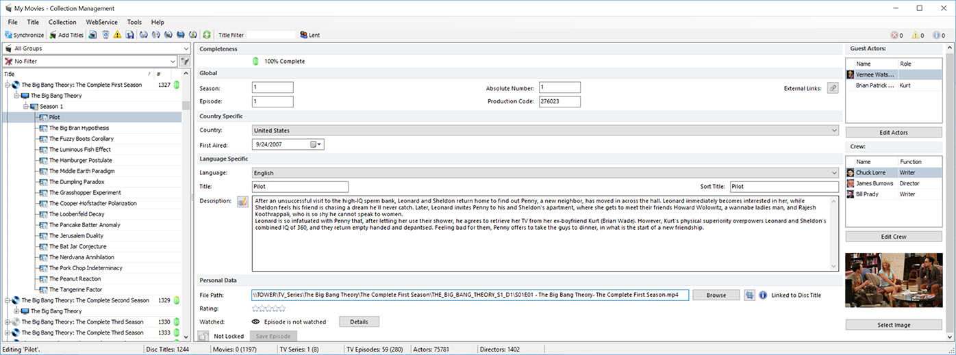

The <episode> files are only written if a playback file is assigned in the "File Path" box on the Episode, and by design this requires a single playback file per episode (i.e. Sopranos_S3_E01.mp4).
Assigning an MP4 file to an Episode's File Path in My Movies
This becomes a problem for MM Browser, as the Episode Name and other episode specific details are ONLY exported in the <episode> file, and by design My Movies only writes these for re-encoded media with an individual file per episode. That means that MM Browser's ability to playback episodes directly from DVD/Blu-ray ISO would not benefit from the various episode details that My Movies refuses to export for ISOs.
But we have found a solution!
It turns out that simply by assigning pretty much any file to the Episode's File Path box, the one requirement being that the file must actually exist, will force My Movies to export the <episode> mymovies.xml files. Built-in to MM Browser v1.8 is an automatic feature to create empty text files with specific names that can be assigned to Episodes in My Movies for just this purpose, and once My Movies generates the required <episode> files, we can have nice Episode Names and other details (work in progress) inside MM Browser.
