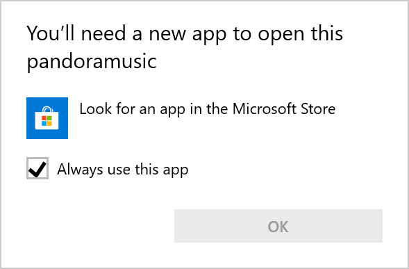

With each one you'll probably get a prompt like the following, with Windows indicating that you'll need an app and offering to search for it in the Mircrosoft Store - this means that the shortcut you tested doesn't work, so keep testing other values.

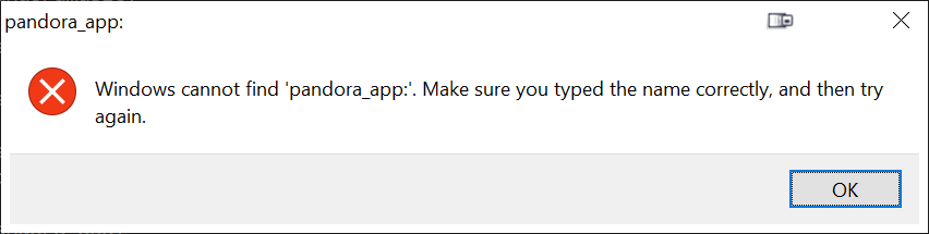

You might also get an error message like this, which also indicates the shortcut you tested doesn't work:

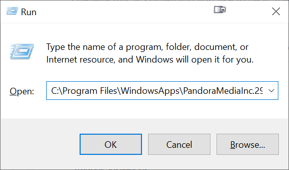

6) Copy the InstallLocation path (starting at C:\Program Files\…, highlight the path and do a CTRL+C to copy), then press WIN+R to open a run prompt, then CTRL+V to paste the filepath you just copied, then press OK:
This will open up the hidden folder. *NOTE: do NOT try to browse to that folder using Windows File Explorer starting from C:\Program Files\ as the WindowsApps folder is completely blocked from being browsable. The ONLY way to get to the hidden app folder is to use the steps above to open the target folder directly.

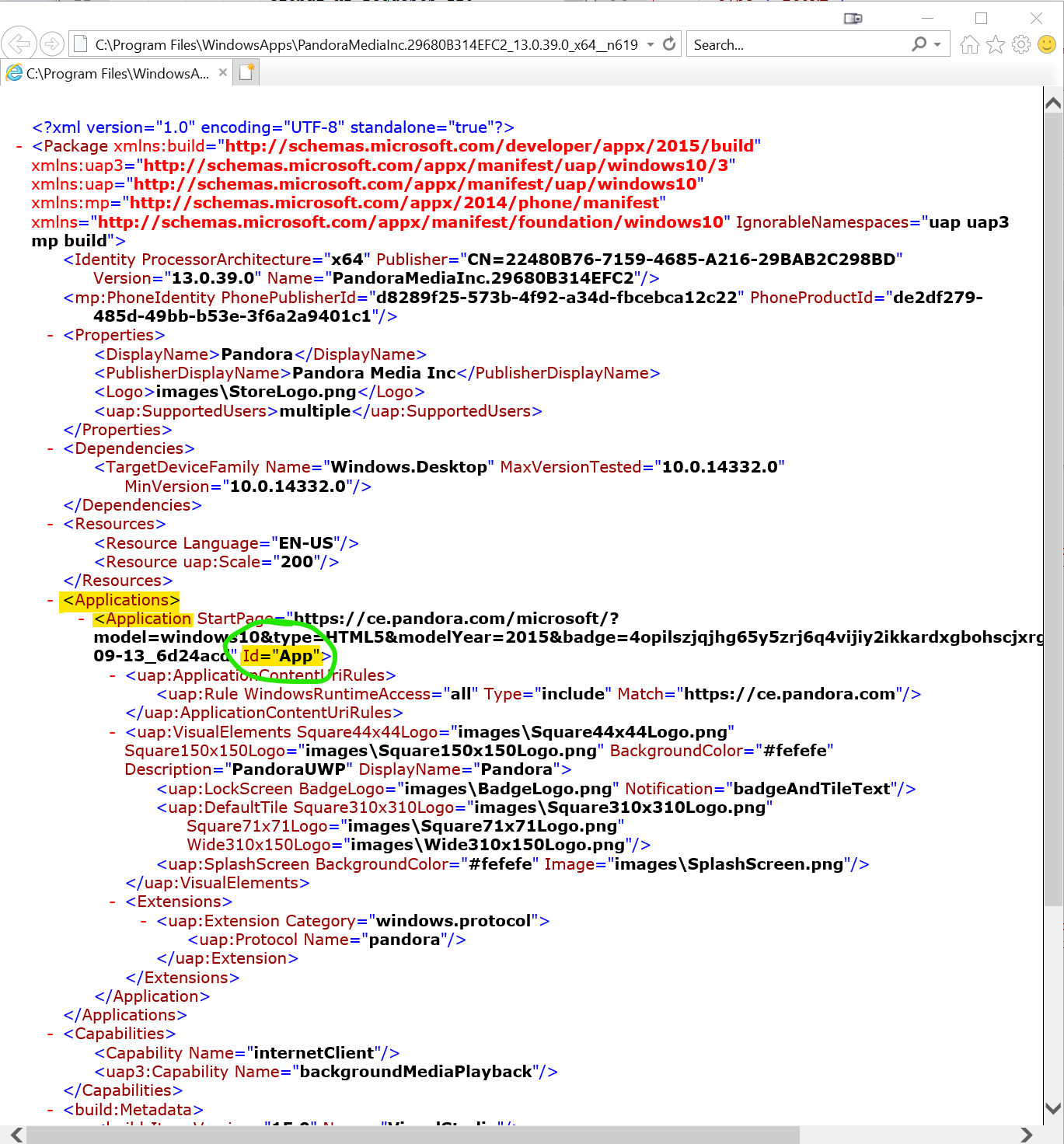

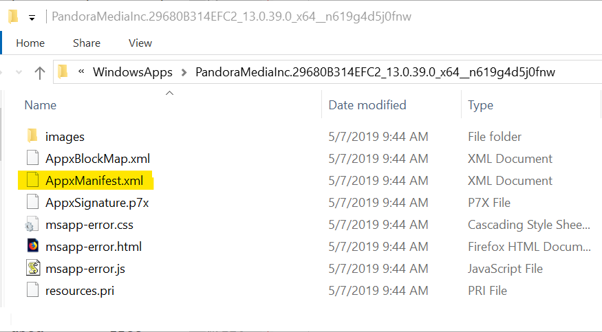

7) In this folder, open the file named AppxManifest.xml (you can typically double-click it and Windows will open it with Internet Explorer):
When you open the file you will see the manifest XML data. It may look overwhelming, but don't worry, you only need one piece of info from it, and it's easy to find. Following along in the screenshot below, first look for a tag named <Applications>, then right below it you will find another tag named <Application with a bunch of values inside of it. It may look different than the screenshot below, but regardless it should have a property named Id in it. Usually this Id value will be "App", but it can be anything. Take note of this value:
