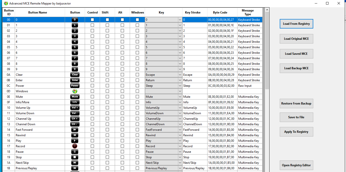

Here's what MCE Remote Key Mapper puts in. Does this help you?
mce remote key mapping for green button.png (70.73 KiB) Viewed 15231 times

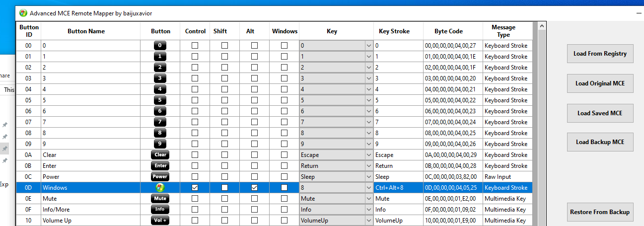

6. In MCE Mapper: Load From Registry, and provide screenshot
Debug log is attached
CMC Remote Reg with Green button enabled.png (92.31 KiB) Viewed 15217 times
