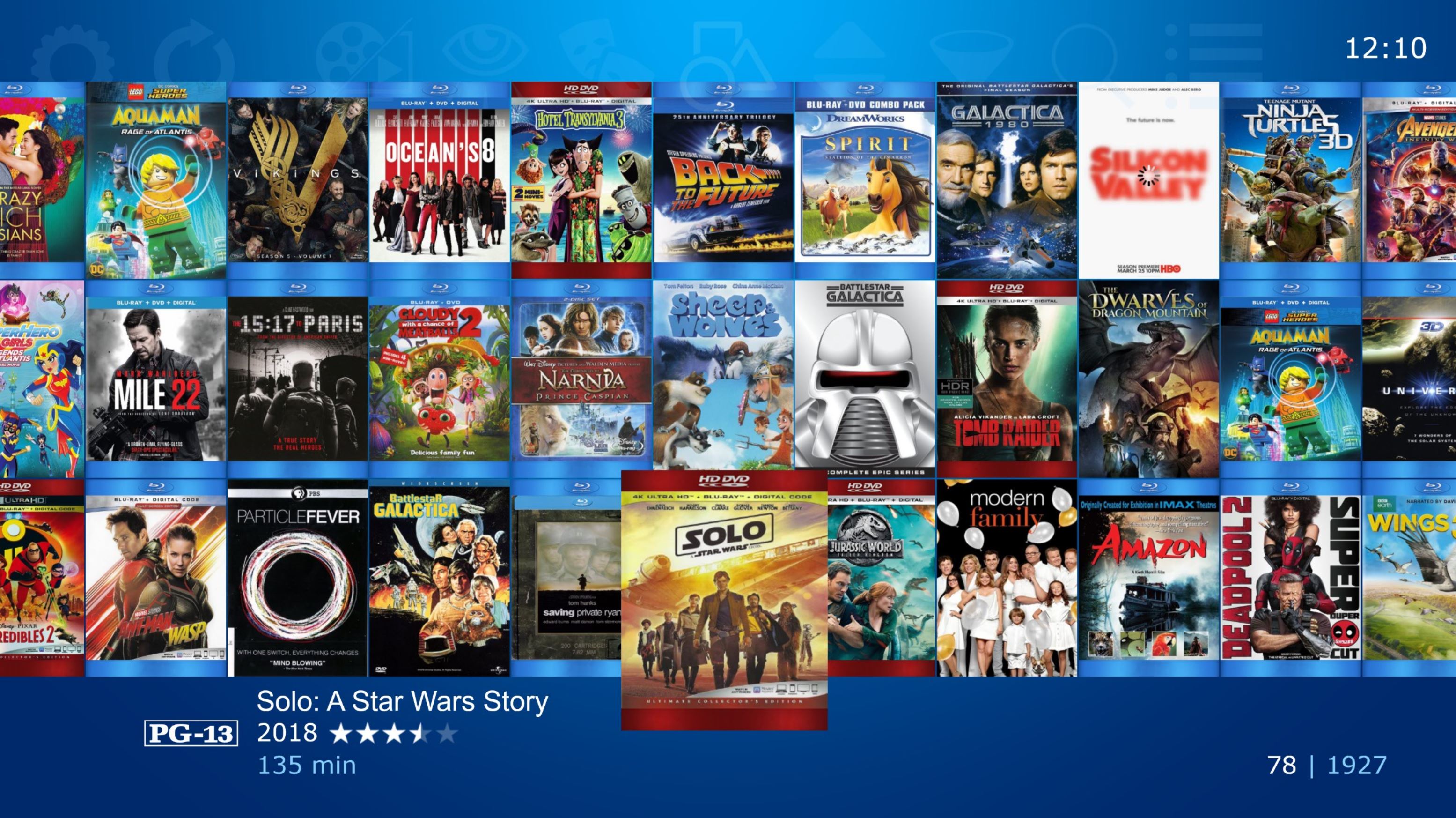

All of my 4K UHD discs are shown with the HD DVD case for some reason. I don't know the correct terminology here, so I attached some screen shots of what it looks like, and what the MyMovies title looks like. I'm running CMC 2.2 and MyMovies 5.25 on Windows 10.

This is because you are using the "My Movies" default cover profile, which (at least in 5.24) did not include any graphics for UHD 4K discs, so I programmed CMC to default to using the HD DVD for UHD 4K to make it easier to see them versus Blu-ray (when the 4K UHD graphics are missing).

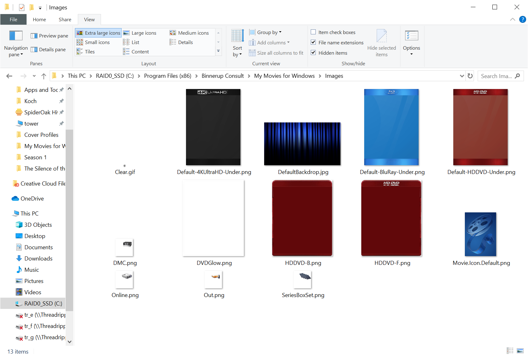

EDIT: I just double-checked and I was mistaken, Binnerup does include the 4K graphics with 5.24:
Can you still try using the CMC cover profile mentioned below to see if it "fixes" this display issue for you? I can do some digging on my end to see what is going on.

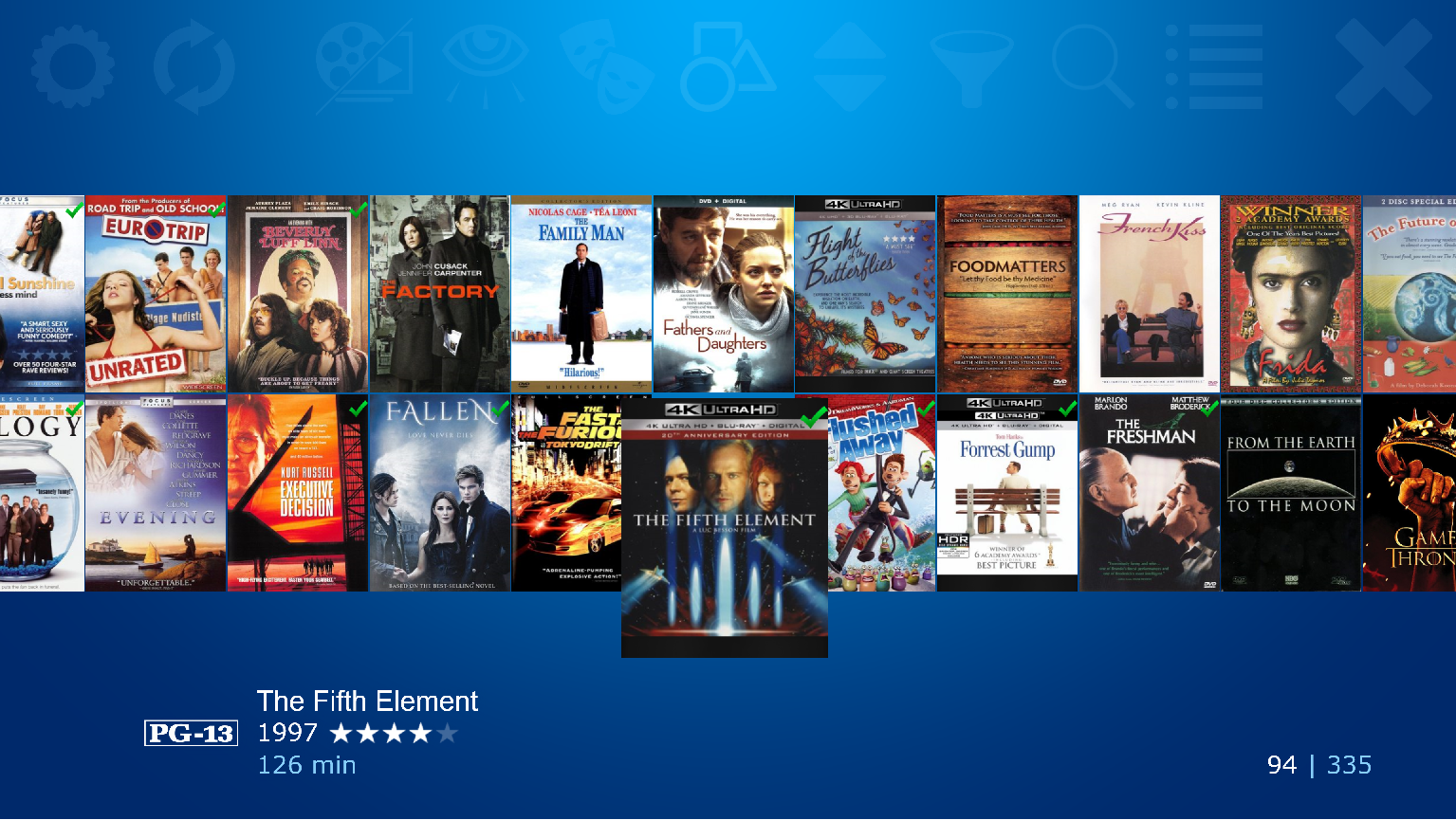

I was able to recreate this issue, and traced the root cause to a small bug in CMC when using the My Movies default Cover Profile. The code was skipping the step that defines the 4K Ultra HD cover set, so even though the 4K images existed and were even being loaded, the CMC logic was reverting to using the HDDVD images.
Here is an example of it now showing correctly:
I'm amazed that this issue wasn't discovered before, as this code has been the same since CMC v1.0. I've just fixed it for the next version of CMC. My goal is to have the next version out by Halloween (October 31), which is CMC's 2-year anniversary.
