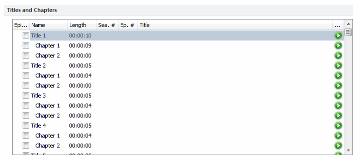

Thanks.... I am obviously doing something wrong as I can't get it to work. I will start with I do not have the physical disks. I have been burning movies for years and years and there are over 1200 of them and all in M2TS format.
What is interesting if if I just delete the disks within the title and then add new disks and then go to Edit Chapter or Episodes to see if it is right it says "Before you can edit chapters or episodes for the disc, you must read the disc id for it.
If I delete the title and recreate it, when I add the disk it pulls down all of the episodes. I can then go in and see the episodes but the MPLS data is missing. The just deleting the disk and re adding them doesn't seem to pull down the episodes for me.
When I do a sync I get pages and pages of the missing MPLS messages. As I sift through them they are all TV Series. Is this only an issue with TV Series?

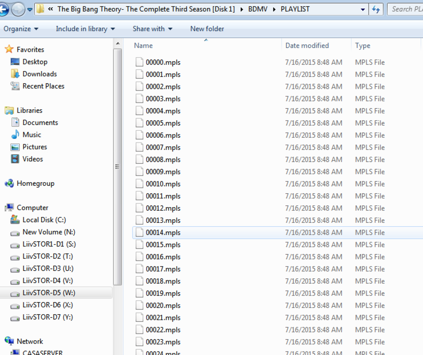

Thanks for all the responses, this has been very helpful. When the movies are created they are in a directory structure (see below). I downloaded Virtual Clonedrive but having a hard time getting it to work with the M2TS structure.
It is a shame it can't read it from the directory as they are right there. I thought we were on to something with Virtual CloneDrive but I am starting to think it won't work with this directory structure.
As it is only TV series it is impacting I think I will have to punt. It does generate pages and pages of errors when I sync but I think I can live with that. My entire collection (something like 1200) is in this format so switching formats is not really an option.

Hi Kevin, I definitely remember you, and yes you were customer #3, right after Jamie. Your username seemed familiar but I hadn't quite connected all the dots yet. Glad you like the progress, thanks! Not sure if you've discovered CME yet, but if you haven't, definitely give it a try. It elevates CMC to the next level.
Sorry, I didn't realize that you had ripped to Blu-ray Folder format (though had I realized who you were, I probably would have - I think I added DVD/Blu-ray Folder support for you!).
You don't have to switch formats - I keep all my TV Series in DVD/Blu-ray Folder format which allows them to play back episodes instantly and I don't have to wait on ISO mounting. But according to the My Movies requirements, you would have to re-insert the original disc to get My Movies Collection Management to re-read the disc structure and restore the MPLS #'s.
You may want to check out Yubsoft ImgDrive, which lists among the many features the ability to "Mount a folder as DVD/BD". Note that I have never used this software so this is not an endorsement, merely a head's up: https://www.yubsoft.com/imgdrive/

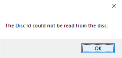

I may go ahead and give it a try. My season 5 of The Big Bang Theory got corrupted by automatic updates that blew away the MPLS values. I had already stored this season away in the basement a year ago, and I don't want to find and rip open boxes searching for it. I'd been searching for a tool to mount folders as ISO's, and so far hadn't found anything until a few minutes ago when I stumbled onto ImgDrive.
[UPDATE] I tried it and it didn't work for me. First I tried the portable version, which doesn't have the Mount Folder as DVD/BR option. I then installed the full "Installer" version, and was able to successfully mount my TBBT Season 5 Disc 1 folder, and browsing to the virtual drive letter looked promising. When I attempted to read the Disc ID from the virtual drive, and My Movies failed, saying "The Disc Id could not be read from the disc.".
Shucks. I thought I finally had a solution.
