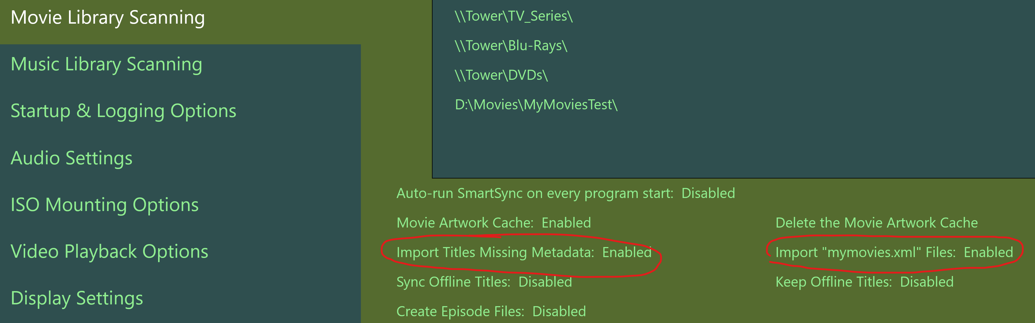

Beginning with CMC v3.2, the import of 'mymovies.xml' files is disabled by default, and all users are expected to use CME to create metadata.
Along the same lines, the import of titles missing metadata is also disabled by default, so you will only see titles that have CME metadata.
These changes mean that with CMC v3.2, when new users run a Sync they will not import any titles if they are not using CME to create their metadata, which hopefully will get the user to realize they've missed a step. At that point, the user has the option of either using CME (ideal) or going into the settings and re-enabling import of mymovies.xml files and/or titles missing metadata.
If you are already using CME, this change will likely be transparent to you - except for new titles not showing up if you've forgotten to run CME to export them. If you are not using CME, or haven't used it for all of your titles, you may find that those titles disappear with v3.2 when you run a Sync.
If you are not using CME and need the legacy functionality, you can change this behavior in the Settings > Movie Library Scanning, as shown here. Enabling both of these options restores the behavior of previous versions:

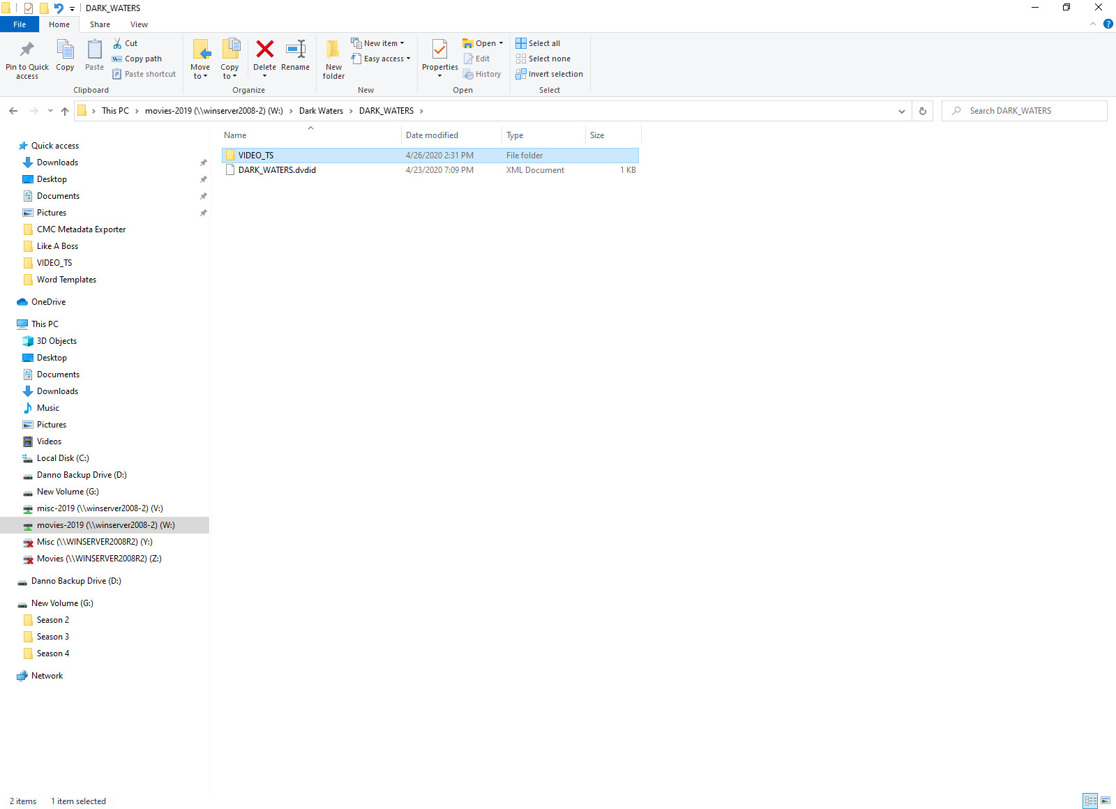

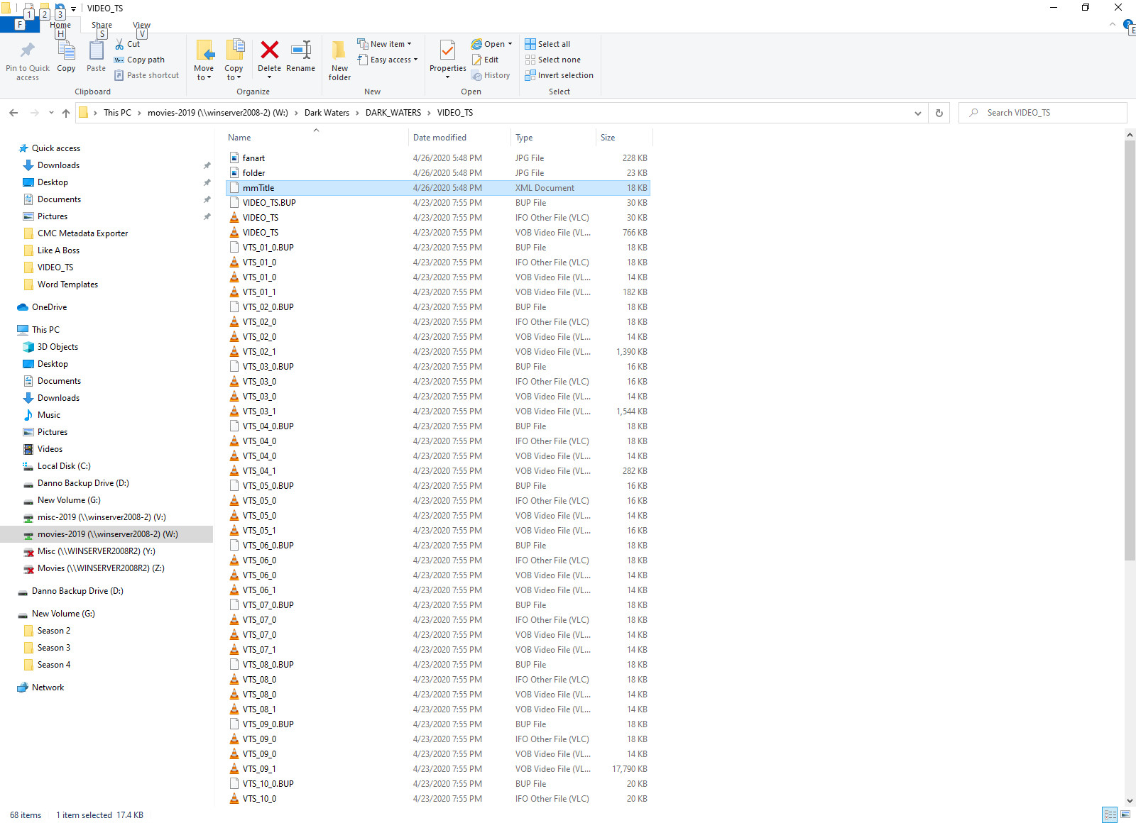

Running in to a problem...presumably with CMC Mediadata Exporter. (Using My Movies 5.25.) I have recently added to my collection a couple of DVD's. I am running the exporter, but when doing a sync within CMC, they are not being picked up. (Blu Ray copies seem to be working fine with the exporter and sync.) One of them happens to be a three disk set. The other is a single disk.
Attached are screenshots of the folders under the main title for DVD movie "Dark Waters".
I have run both the full sync and smartsysnc after opening CMC. These new disks are not being picked up.
Were there any other changes made in the exporter when you updated it recently?

No other changes.
CMC will not look inside of a VIDEO_TS folder. You have set the path incorrectly in My Movies. Set the path to ...\DARK_WATERS, not ...\DARK_WATERS\VIDEO_TS.
