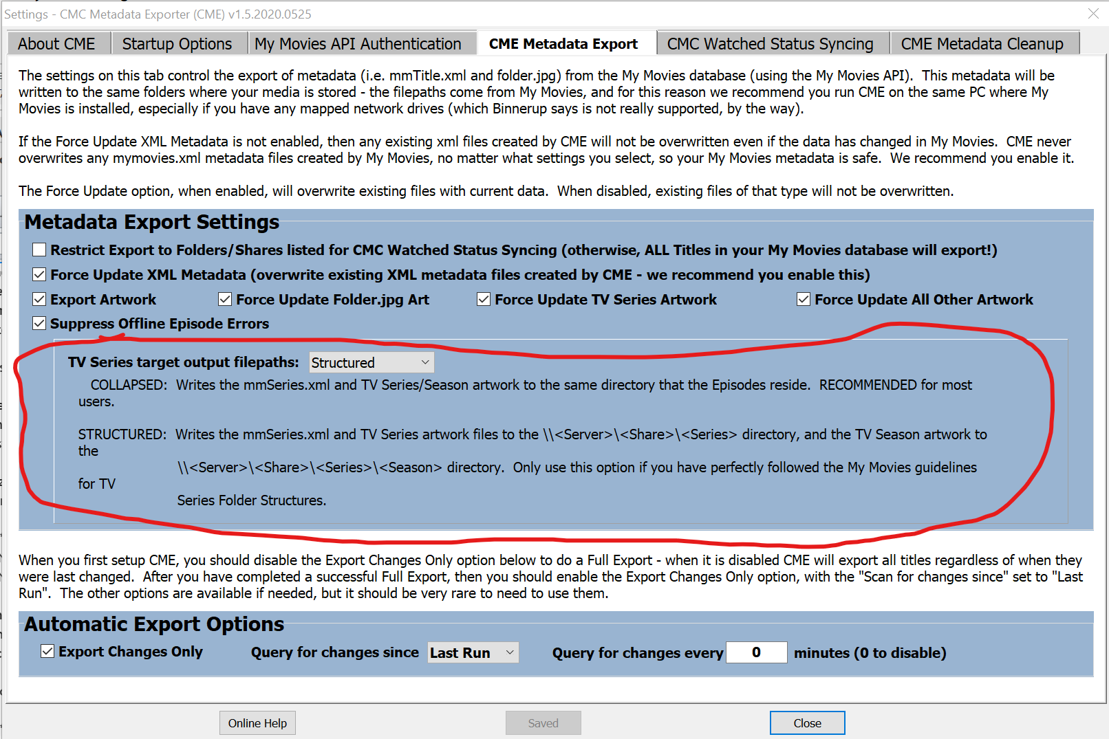

When the Structured option is set, then mmSeries.xml will be written to:
  • \\<NAS Server>\TV\<TV Series Name>\<TV Series Name>.mmSeries.xml
Now, if you haven't followed the folder structure guidelines perfectly, CME won't know that, and will end up writing files in the wrong location. For example, if you used this:
  • \\<NAS Server>\TV\<TV Series Name>\<Episodes>
then CME will do this:
  • \\<NAS Server>\TV\<TV Series Name>.mmSeries.xml
placing the mmSeries.xml in the root TV folder, which is not what we want. So the first step is to look in your root TV folder for these new mmSeries.xml metadata files (and associated jpg files). If they are being written there, then you have two options. Either correct your folder structure (both in the file system and in My Movies Colleciton Management), which can be a daunting amount of work, or change from "Structured" to "Collapsed" in CME, which will have CME write the mmSeries.xml files in the same folder with the episodes, circumventing this structure problem.
Note that CMC doesn't really care if the mmSeries.xml file is found in the episode folder or the grandparent TV Series folder, it's cool with either. But having it written to the wrong place might mean CMC could miss finding it. Which brings me to the next topic.

Based upon what I am seeing, it looks like you are using the "Collapsed" output option in CME, as all the metadata is being written in the same folders with the episodes. That's great, and eliminates any of the concerns I wrote about in the previous section.
