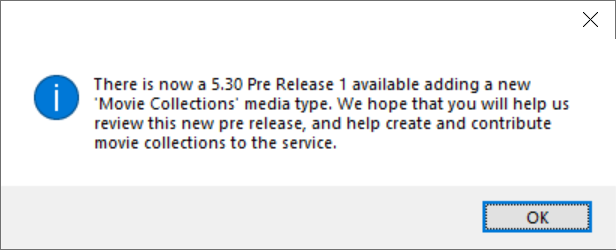

I just got this pop-up in My Movies Collection Management (I'm still running 5.24):
I thought we were still on 5.26 RC....

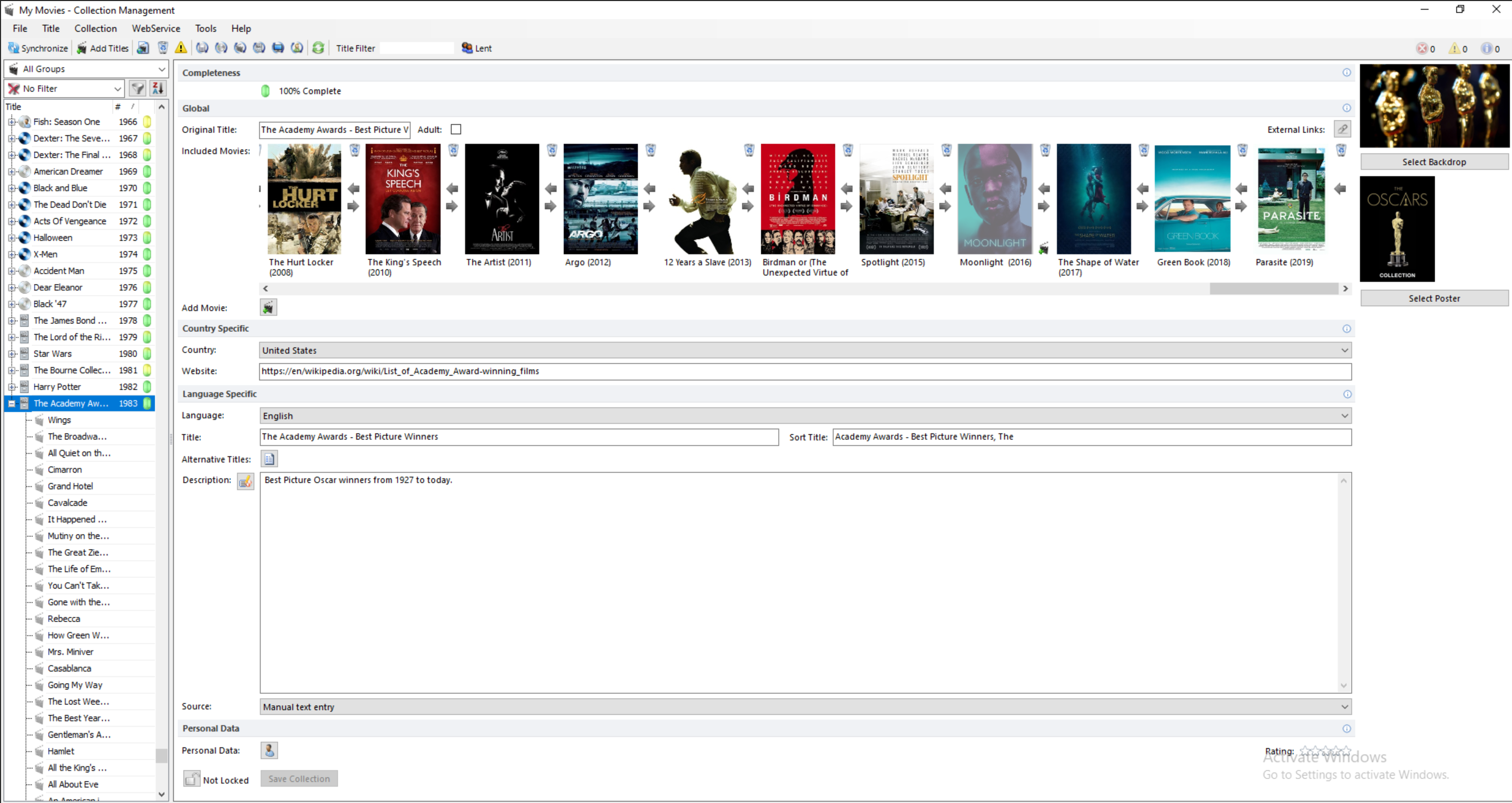

For those curious how Movie Collections work, here's a screenshot. I was able to add all 93 Best Picture Oscar Winners to a collection, even including titles I don't own. Titles I'm missing are greyed out.
On the left of the screenshot in the treeview you can see a few other Movie Collections:
  • The James Bond Collection (has everything except No Time to Die, which hasn't been added to My Movies yet.
  • The Lord of the Rings
  • Star Wars
  • The Bourne Collection
  • Harry Potter
As you can see, these make a great replacement for both fake Box Sets and custom Categories... well, almost. As of right now, you can only include Movies in a Movie Collection. I asked Brian to consider letting us add TV Series to them too, since you have popular collections like Star Trek that is both TV and movies.
I think my "The Academy Awards - Best Picture Winners" collection is perhaps the best example of the potential of this new feature, especially since you can contribute it for other users to use and maintain, and you can add movies you don't yet have to them.
