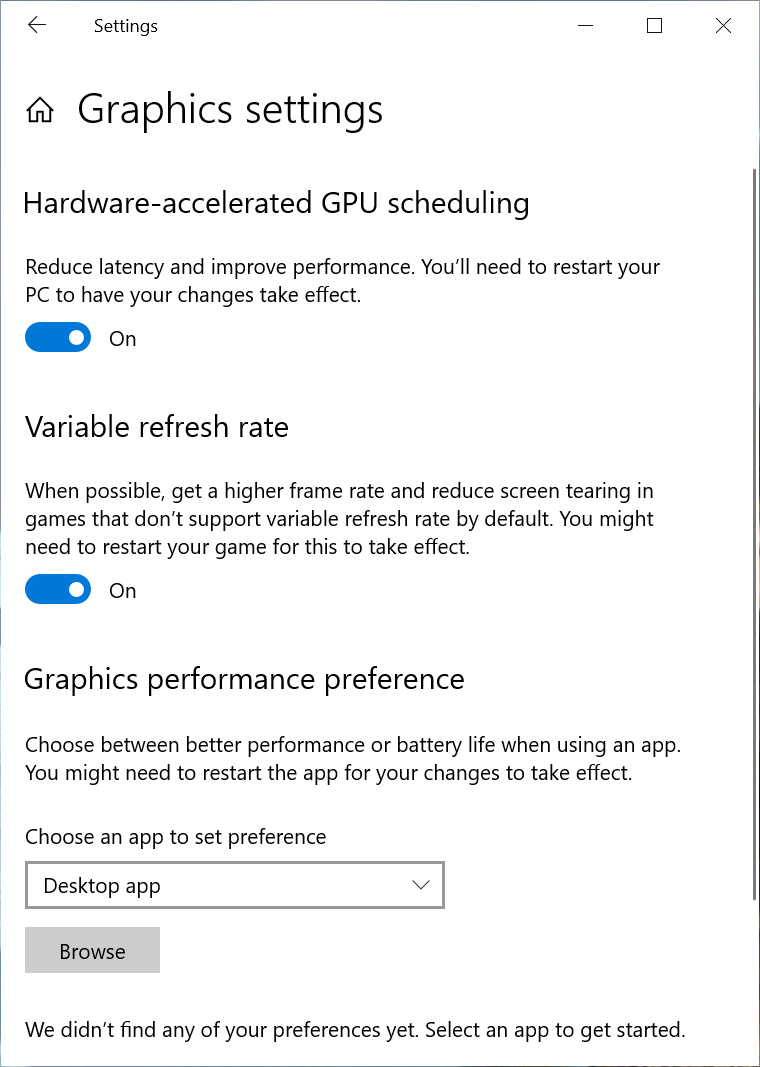

The good news is that I did fix it on my PC. In my graphics settings I enabled the new Win10 2004 options for "Hardware-accelerated GPU scheduling" and "Variable refresh rate", and now I'm back to smooth scrolling. I'm a bit baffled as to why this worked, as these are enhancements that shouldn't be required for an app like CMC - in fact the hardware-accelerated GPU scheduling is brand new and should almost be considered beta functionality. Perhaps there were recent Win10 updates and nVidia driver changes also at play.
I might do some more testing if time allows, to see if only one or the other setting made the difference. It might also be related to having FreeSync enabled on my monitors combined to having it disabled in Windows that was the problem.

I checked my graphic settings, and they still were set to the new values that I thought had resolved the issue.
Most likely a reboot that I did after applying the settings had helped.
