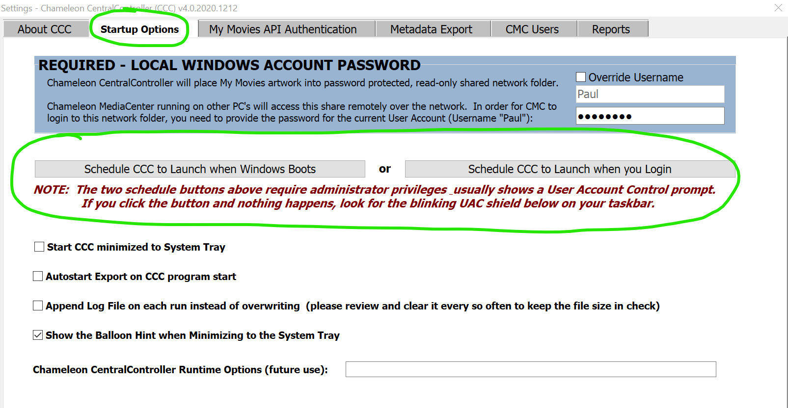

In CCC go to Settings > Startup Options
Click "Schedule CCC to Launch when Windows Boots", enter your current Windows User Account password, then find the UAC prompt and "Allow" CCC Admin rights to create the scheduled task.

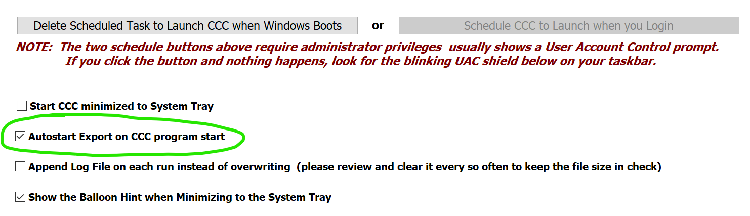

Enable the option to "Autostart Export on CCC program start", then Save.

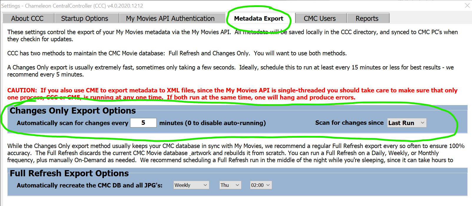

The Auto-Export Jobs will check the My Movies API for changed data at set intervals. By default, the scanning interval is set to 5 minutes, and it will be scanning for changes since the "Last Run". These parameters are set on the "Metadata Export" tab, though we DO NOT recommend changing them - these default values are the best values for most users.
We have found that scanning more frequently than every 5 minutes has a tendency to overwhelm the My Movies API - especially if you are actively making collection changes in My Movies Collection Management - and this can cause hangs in all app (My Movies Collection Management, CCC, and CMC if it is syncing to CCC).
And do not change "Last Run" to another option unless you have a special need to export changes from a different timeframe (extremely rare).

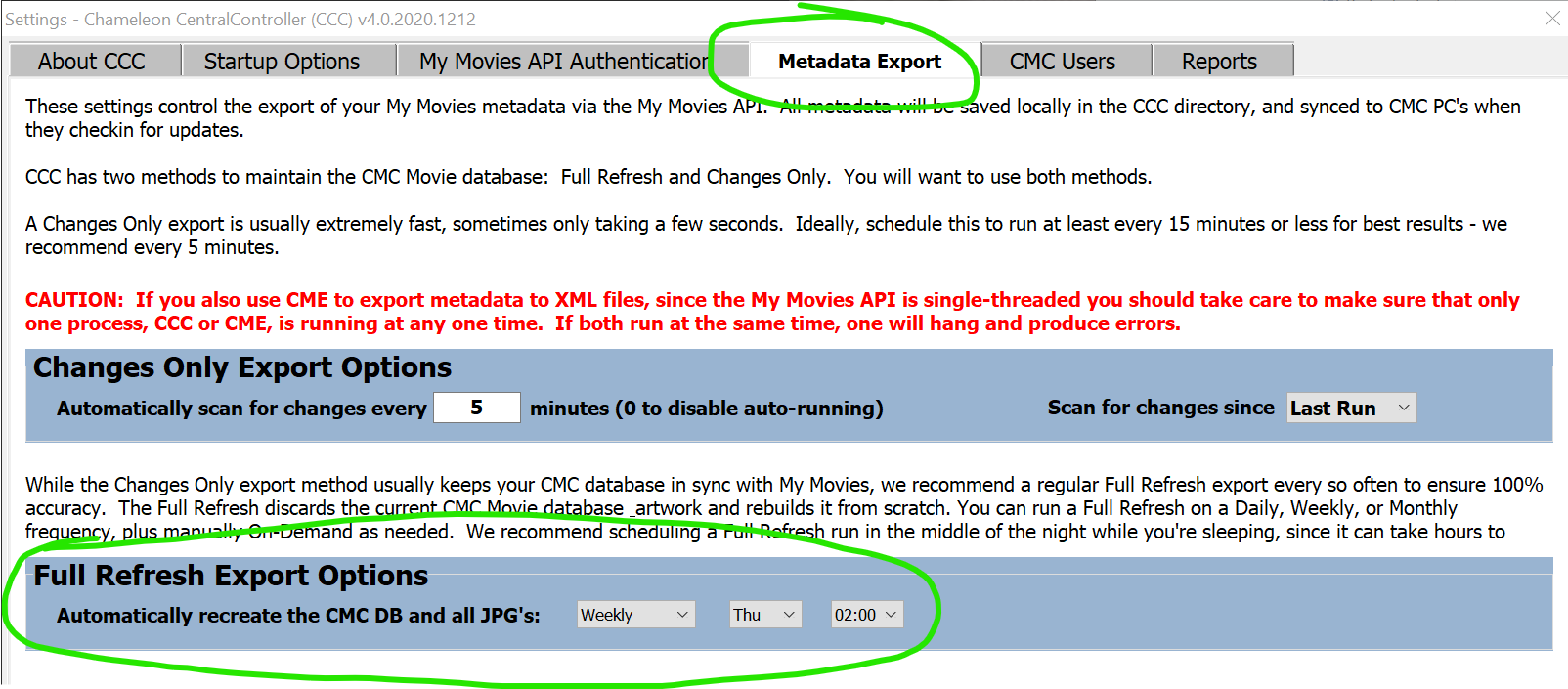

Automatic Full Export Scheduling
While the Changes Only logic used by the Auto-Export Jobs is really good, it's not perfect. Due to limitations in the My Movies API, sometimes changes go unreported. And sometimes a change is processed, but CCC makes a mistake in how the change alters the previous data.
For this reason, CCC has been designed to run automatic Full Exports at regular intervals. This ensures that your exported data in CMC is always an accurate representation of your My Movies collection.
For now, we are recommending a Full Export once a week, though we may refine this recommendation in the future after we've had more user feedback on the Changes-Only accuracy. For this reason, we have scheduled a Full Export to run automatically on Thursdays at 2am. This day and time were chosen so that processing occurs in the middle of the night when you are probably asleep, and is ready to use before you get to the weekend, a popular time for watching movies.
If this day and time does not suit your preference, you can easily change the schedule on the "Metadata Export" tab:
Keep in mind that CMC cannot sync to CCC while CCC is processing a Full Export. For this reason, try to schedule the Full Export to run at a time of day when you will not be using CMC. Of course, CMC will still operate in the "Offline" mode if CCC is busy performing a Full Export, so don't stress about this too much.
If your My Movies collection is fairly static, meaning you rarely make changes, a weekly Full Refresh may not be needed. You can change the schedule to Monthly if that suits you better, or completely disable it in the schedule options and run it manually using the "Run Full Export Now" button only when needed.
At the other end of the spectrum, while you can schedule the Full Export to run daily, we don't think this is needed, and since it exports Gigabytes of fresh artwork data each time, a daily Full Export may shorten the lifespan of your data drive.

Open CCC's Settings and select the "Startup Options" tab. Below the blue "Local Windows Account Password" box are two buttons that will add a Windows Scheduled Task to auto-launch CCC:
The button on the left will auto-start CCC when the PC boots up, even if you have not yet logged in. This is very similar to how the My Movies service is always running when the PC boots up. We HIGHLY RECOMMEND you use this option! When you click this button, you will be prompted for the password for your current Windows account - this is required in order to schedule the task to launch CCC, as it will be launching using your current account. If for some reason, this is not the account you want CCC to run-as, you need to log out and log back in as the appropriate user.
The button on the right will auto-start CCC, but only if you log into the PC first. We don't recommend this, because if you forget to log into the PC after it is restarted, then CCC will not be running, and CMC will fail to sync.
Regardless of which button you click, you will have to respond to the User Account Control (UAC) prompt to allow admin rights for CCC to add the scheduled task.

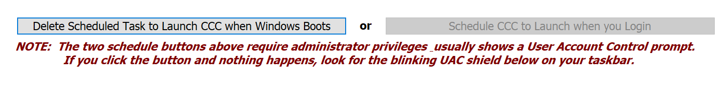

If the task was successfully created, the text on the button will change to indicate that it will delete the scheduled task, and the alternate button will be greyed out - CCC only allows you to configure one method or the other, but not both:
Now that CCC is scheduled to Auto-Start on Boot (or Login), that addresses Requirements # 1 and 3 that we listed above. But we still need to start the "Auto-Export Jobs" automatically.

On the same settings tab beneath the task scheduling buttons are several options. The second option, "Autostart Export on CCC program start" needs to be checked. This way, when the scheduled task you configured above starts CCC, then CCC will self-click that "Start Auto-Export Jobs" button for you, beginning the 5-minute scans for changes.
Click Save and you are done!
