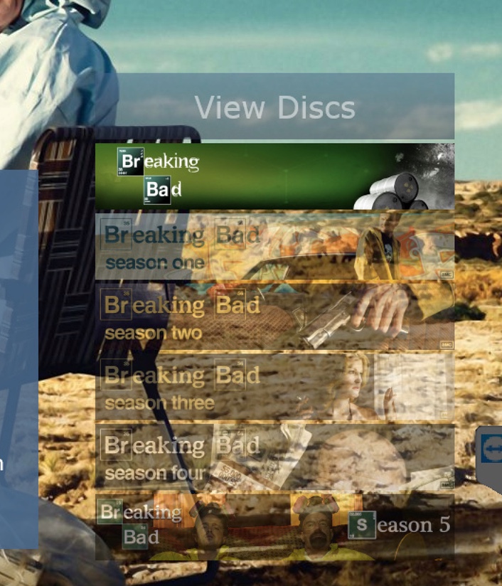

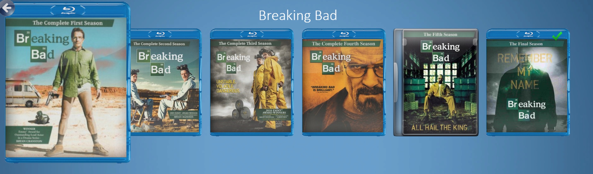

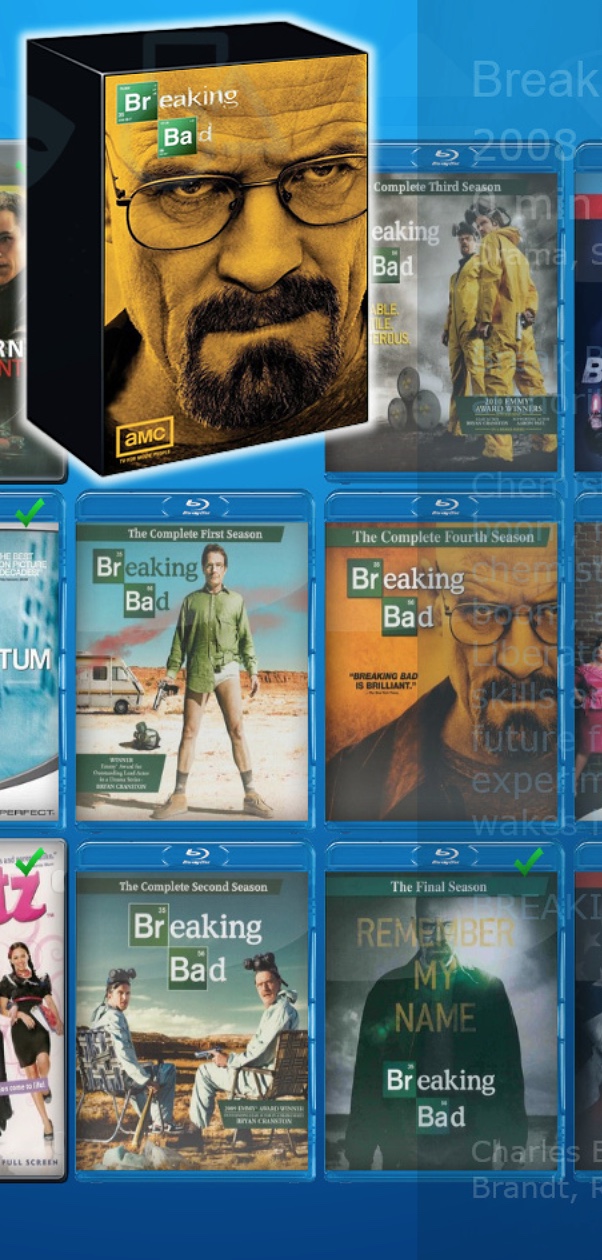

I have migrated to Version 4.0 and have CCC running on the MyMovie Server and CMC running on the Movie Client. On the client when I go through the movies I have situation like the following with Breaking Bad.
I have a "Box" that has the 6 Breaking Bad DVD's in it (see screen shots below). I also have 5 of the 6 Breaking Bad DVD's on the main screen. When I go into the Breaking Bad "Box" the following is listed on the first screen and then if I do "View" discs all 6 are listed there.
The image above is when I click on "View Discs"
What I am trying to figure out is what controls which ones are in the "Box" and on the main screen. Ideally I would like to have just the "Box" on the main screen and all the DVD's listed in it.
I am guessing something in My Movies but nothing is jumping out at me. The TV Series Box is Blue on all of them.
I actually have similar problems with anything that is in this format but I am guessing if I can figure it out for this one the rest will be a similar solution.

Thanks Kevin. That was just as I expected.
I recently added a feature to CCC that if a TV Series did not have episodes mapped, then it would override the Media Type from TV Series to Other. I did this because I had a single season TV Series, Dynasties, that wasn't showing in CMC. I realized it was because the episodes were not mapped, so only the disc title was exporting, and the Series & Episode info were not exporting (and couldn't export, because that data didn't exist in My Movies).
In CMC, Disc Titles that belong to a Series automatically nest inside the TV Series. But if the Series doesn't export, then the discs disappear because the Series is missing. The Disc Title data is in CMC, but there's no way to get to it without the Series.
My solution was to change the Media Type to Other, which disables the nesting behavior.
What I hadn't considered was what happens when you have a hybrid scenario, like what you have for Breaking Bad. You have 6 Disc Titles for Breaking Bad (two copies of Season 5, one Blu-ray the other DVD). 5 of the 6 are missing the mappings, so they override to Media Type Other. This would have been perfect, except your other copy of Season 5 is mapped! Because that one Disc Title is mapped, you get the Series data exported.
So you end up with this weird hybrid, where the 5 discs that were missing episode mappings were overridden to Other so they display on the main cover rows, but they also show inside the TV Series group because they belong to that series. And you see the Series box set because that 1 season 5 Disc Title had episode mappings and the Series data to export.
