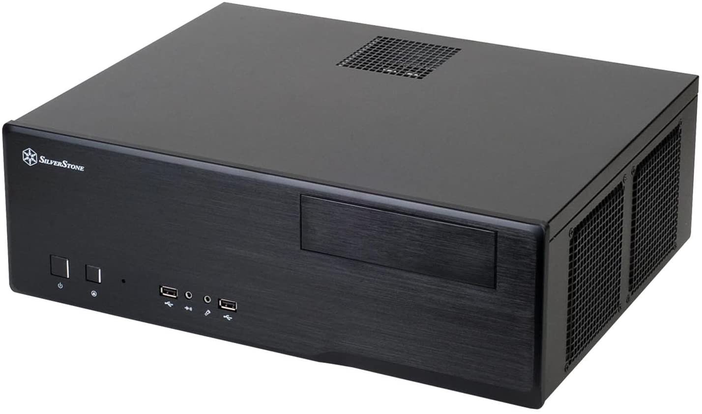

I got my case today. A SilverStone Technology SST-GD05B-3.0-USA USB3.0 Aluminum/Steel Micro ATX HTPC Computer Case with 2 USB 3.0 Front Ports. It came from China but only took a week to deliver. Amazon is the company I purchased it from. It cost me $145 and I waited a month to see whether the price would come down but none of the companies I queried reduced the price.
Re: What would make a good UHD HTPC
Very nice Jamie. My very first case was a Arisetec Kanam case that I bought from digital connection back in early 2006. You can’t get them anymore.
My second case was a silverstone case similar to yours that I bought from Newegg. I think you bought a nice case. I’ve had so my different htpc cases over the years I’ve lost count!Mechanical Engineer, Solidworks junkie, Reef aquariums, sci-fi, weight training, orchids, Ferns, Kaiju, model kit building, balboa park, scripps aquarium
