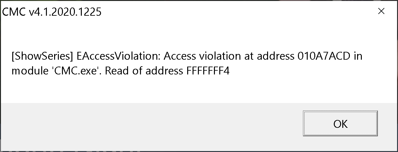

Every time I try to play an episode from "Sports Night" CMC kicks out an eaccess violation. It only happens with the Sports Night series, nothing else. How do I troubleshoot this?

It does not create a log file. The error happens instantly when trying to start the series, the series splash screen opens, the series data is completely incorrect, and CMC throws the error. The screen shot seems to be too large to upload, it's 3MB after shrinking. Is there an email I can send it to?

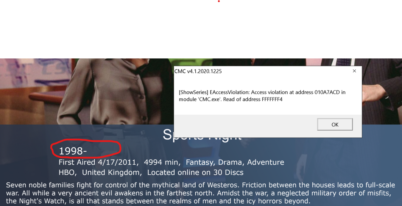

Hey dvoncannon, I got your email. Thanks for sending the screenshot and info.
Here's a crop of the snapshot you sent:
You mentioned that it was odd that the series data was wrong for SportsNight, and you were spot on! Everything after the "1998-" was for another series, Game of Thrones. But 1998 is wrong for Game of Thrones, this is the correct starting year for SportsNight. It's also odd that the value after the dash is missing, it looks like the 2nd date caused the access violation.
I checked my code, looking at the portion that creates the "1998-????" year range, and that function looks like the problem. I'm not quite sure why it failed, but I just rewrote that function to be able to properly handle bad data, and I'm hopeful this will fix the issue. That fix will be in v4.2, which I am hoping to release before the end of the month.

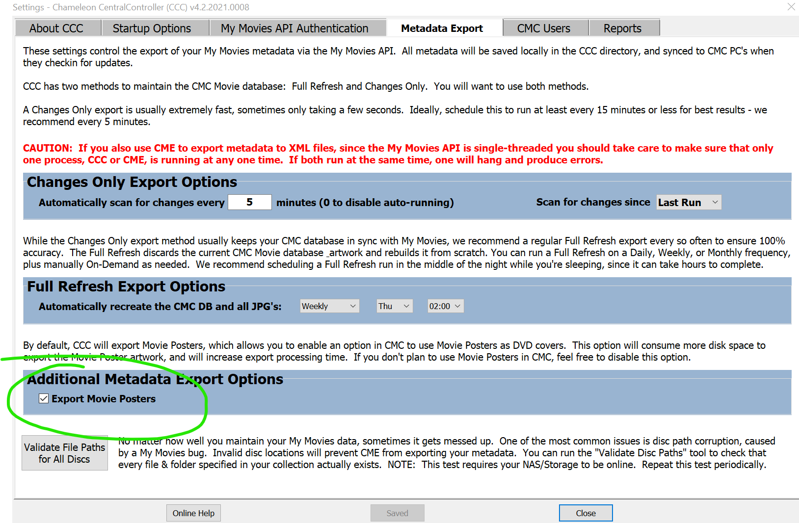

By the way, I just added a new feature for CCC v4.2 to disable the export of Movie Posters:
In my attempt to keep CCC configuration as simple as possible, I had omitted this option. I figured it was simpler to just have it enabled for everyone.
But after you reported a 24 hour export time, I figured this could help you further reduce the export time by skipping the export of Movie Posters. You should disable this in v4.2, unless for some reason you want this feature.
I know there were a few users excited about using Movie Posters as DVD Covers, myself included, but after using it I ended up disappointed with the result - the poster size doesn't always scale well to fit inside DVD/Blu-ray covers - so I won't be using this myself. So by turning this off I will further reduce my export time and save disk space too.
