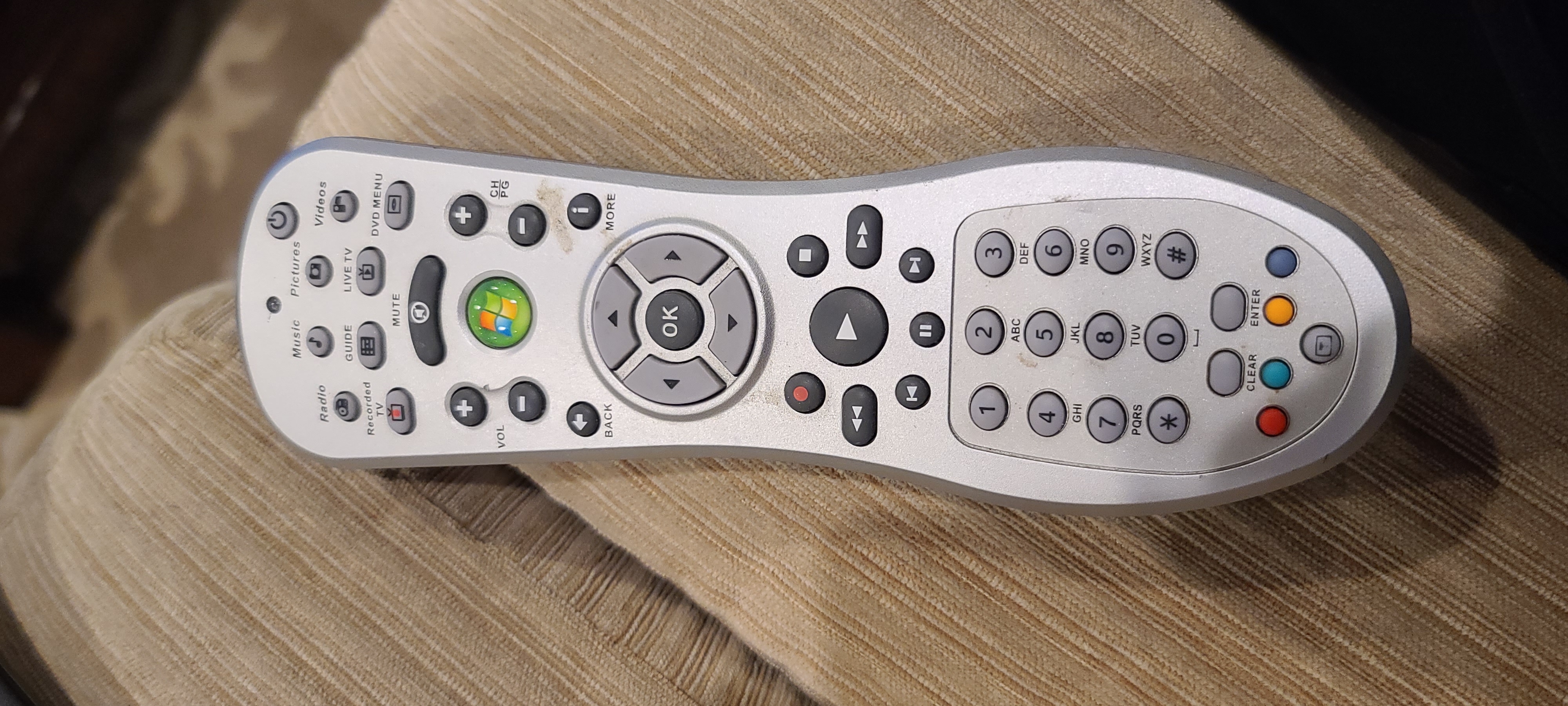

See first attachment a for picture of my MCE remote. The product label on back says it is a Model VRC 1100, Vista MCE Remote Control.
The basic buttons work fine, but when trying to map the red button to the close window command, it never seems to work.
I have started CMD in admin mode, changed the setting in CMC to the red button, and verified that the registry is ok.
The red button does a 'few' things when mapped, like stopping a Powerdvd movie and returning to the Powerdvd home page, but
it doesn't do much else. It does not emulate the alt-F4 keystroke, although the3 alt-F4 keystroke does work from my keyboard.

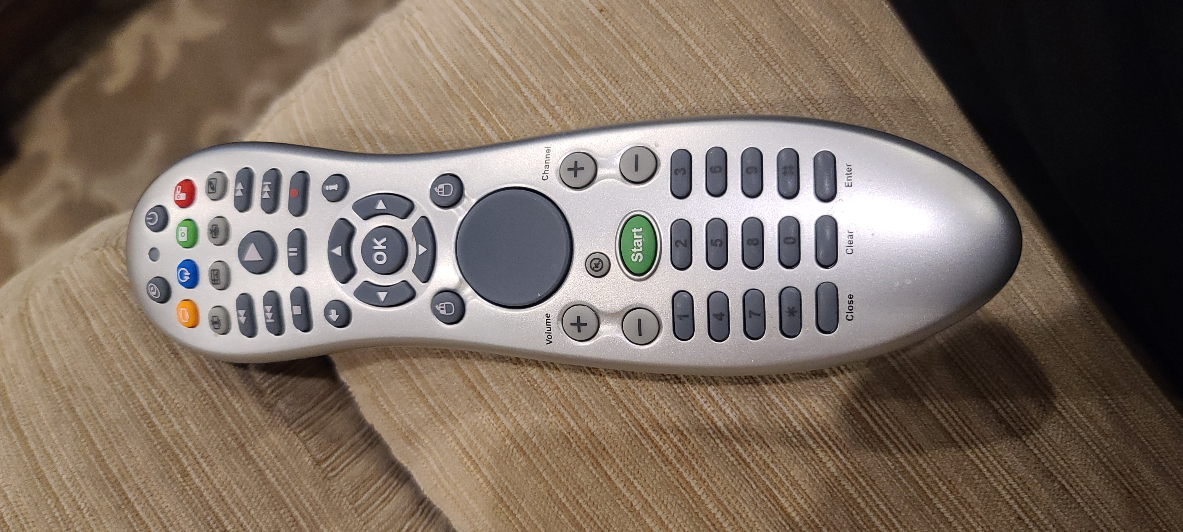

I also have another remote, see the second attachment for a picture of this remote.
It is a model HA-IR01SV(TSHA-IR1) remote but no longer have the usb ir receiver for it. It shows RC6 IR on the
product label and doesn't work with the usb ir receiver that works with the MCE remote mentioned above.
Is there a way to get one of these working (would need to purchase a usb ir receiver for the second one)? If not, what is
a recommended MCE remote for use with CMC?

Looking at the pictures, I have a guess. That first remote's red button is not actually "The Red Button", but rather "My Videos". Yes, they colored it red, but the icon on the button suggests it is the Videos button, as you can see the same icon on the 2nd remote.
Based on this, I would say that your 1st remote does not have the 4 colored buttons, sorry.
One option would be to configure the Recorded TV button to do the close action (it's the grey button on the left, just below the yellow button), or the Record button (the red circle). That should get it working for you.
To fix your other remote you would have to pick up an RC6 compatible receiver, as you mentioned. There are many options here, some external USB devices and some internal solutions too.
As far as remotes go, I would recommend sticking with RC6 compatible MCE remotes. This includes Logitech programmable remotes. These are what I use around here, so they get the most development and testing. Additionally, CMC v5 has new capabilities for configuring remotes, but we recently discovered that the new capabilities only worked with RC6 compatible remotes, so I don't think it will work with your 1st remote.
I used to think that all MCE remotes were RC6 compatible, but it's only been in the past few weeks that I've truly realized that this is not true. Your first remote is a good example of this: while it is essentially an MCE remote, it is not RC6 compatible. This is probably because it has that really nice trackpad and mouse buttons - sweet but definitely not RC6.
