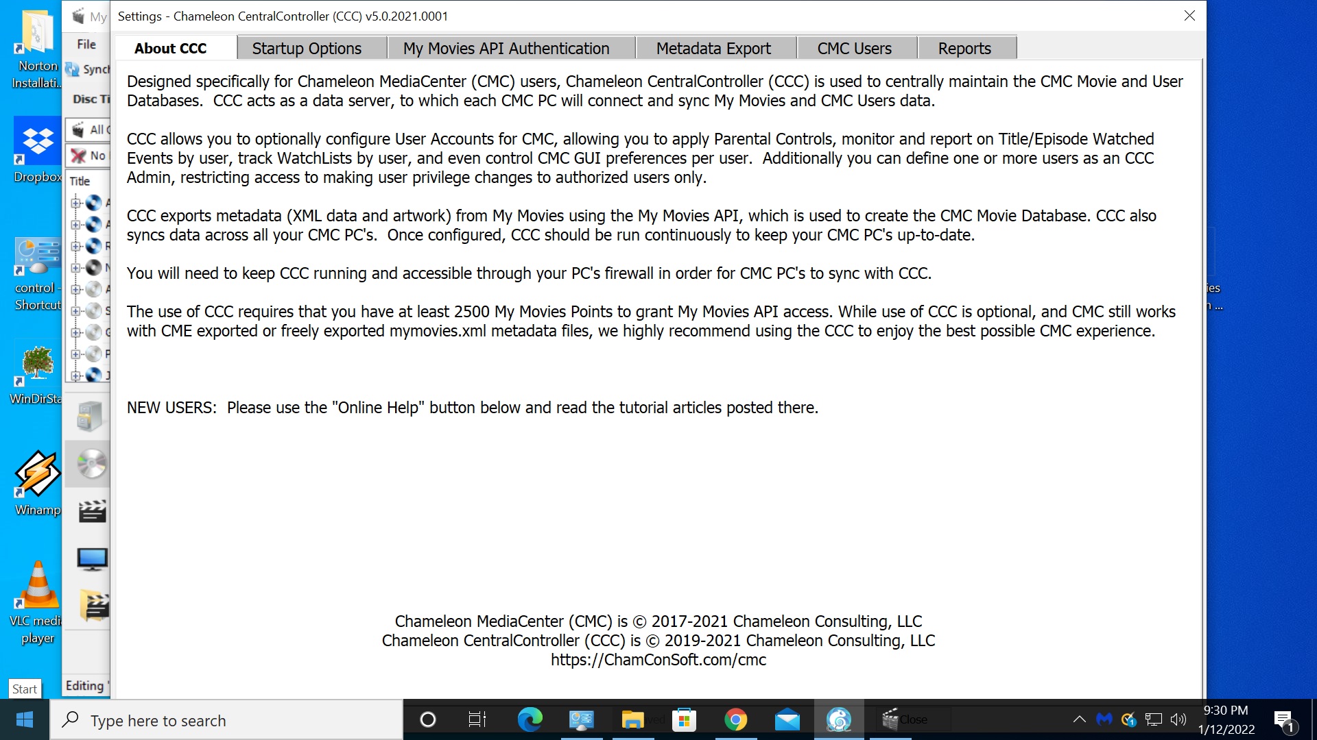

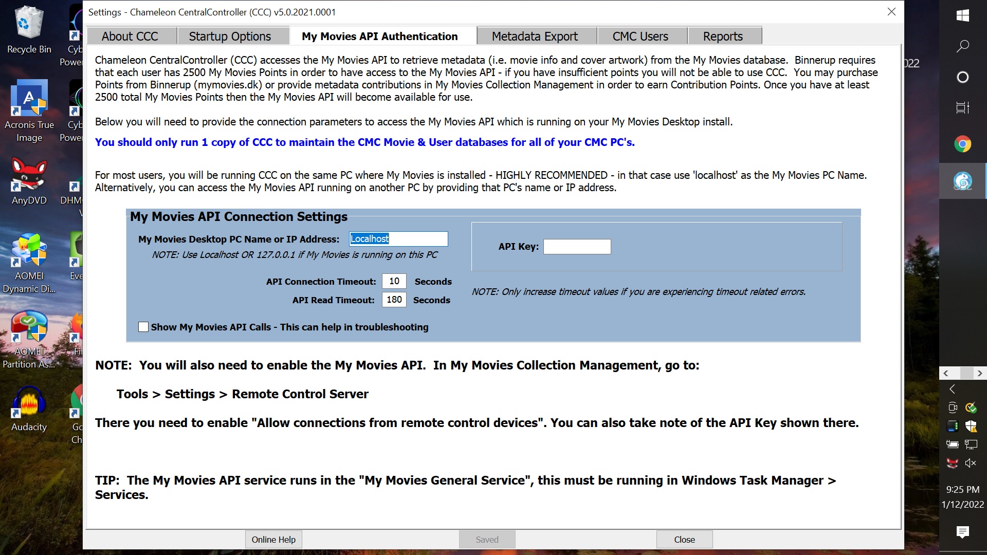

Now that I am in remote desktop the CCC settings save button gets hidden by the taskbar. I unlocked the taskbar, but the taskbar is still on top when I open the ccc settings window. I have to move the taskbar to the right. Save the ccc settings and then move the taskbar to the bottom again.
I wonder if you can set the ccc settings screen to always be? on top, or at least change the ccc screen from maximize to restore down so that there is scroll bar? See screenshots.

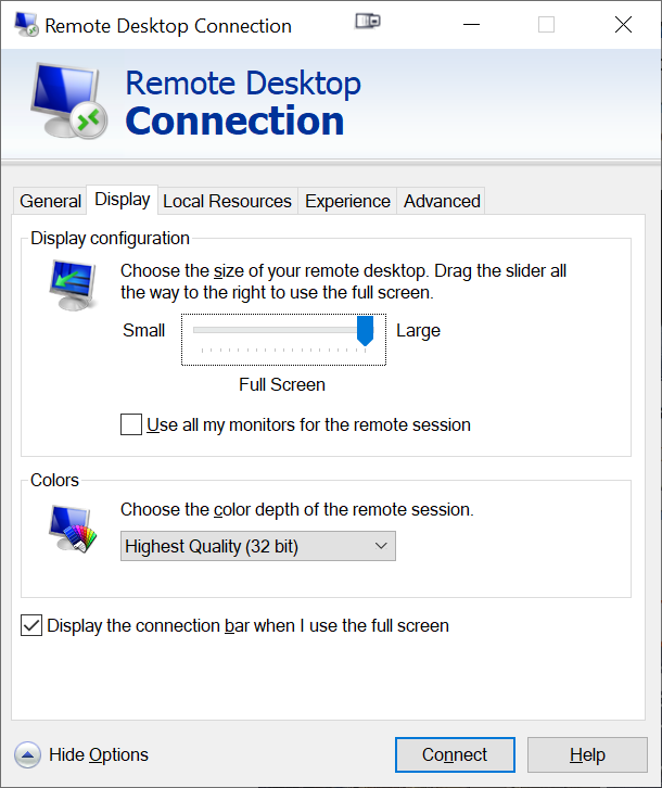

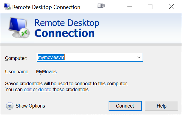

Open Remote Desktop connection panel, then click Show Options at the bottom left.
From there go to the Display tab, and use the slider to adjust the resolution. I thought there was a way to make the resolution higher than your local display but now it seems to max out at your display's resolution (at least on my PC).
If you're in Windowed mode, then you should have the normal window control icons in the top right, just click the middle full screen option. When you're in full-screen mode, there's usually a blue control bar in the top center of the window.

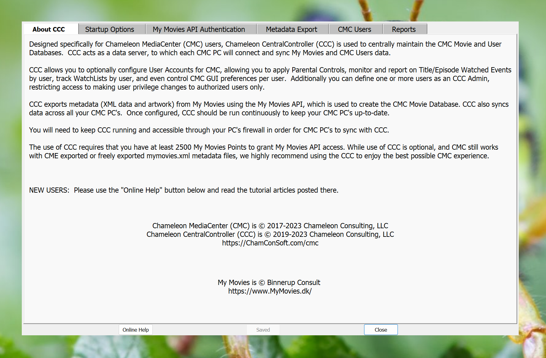

I made a tweak in CCC v7, turning off the top titlebar on the Settings screen. This made the entire Settings window 38 pixels shorter, so the bottom buttons should clear the task bar now.
The downside to this approach is that the window management buttons (minimize/maximize, close) are now gone, but they really weren't needed. Also gone is the ability to reposition the window - I'm a little more concerned about that, but hopefully that won't be a big deal either.
Also, in addition to the workarounds I provided earlier, something else to consider is display scaling. The settings window is only 682 pixels high (it was 720 pixels before), so even on a low 1024 x 768 display, it should easily fit.
But that's only if Windows scaling is set to 100%. If it is set higher, i.e. 150%, than that old 720 height became 1080 (probably why you had issues), and the new 682 height becomes 1043. So keep in mind that you may need to adjust the display scaling on the remote desktop, it's independent of your local desktop's display scaling.
I made the same tweak to CME as well, since it has basically the same settings window.
Please check this out in the Release Candidate that's coming out shortly. I'm a little worried that the settings window is centered vertically, so the extra 38 pixels are split top and bottom, and without the window being movable this could be a bigger issue.
