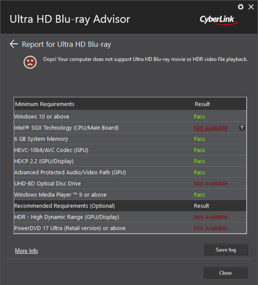

PowerDVD 21 refused to play any 4K discs, indicating my PC was not compliant. To troubleshoot, I used CyberLink's Ultra HD Blu-ray Advisor (sad that such a tool is a necessity), which confirmed the issues with SGX and the friendly drive. I already had a theory on why SGX wasn't working, so I decided to troubleshoot this first.
Screenshot UHD BR Advisor.png (163.43 KiB) Viewed 30388 times
Both my CPU and motherboard support SGX, and I had it enabled in BIOS. Why, then, did the CyberLink UHD Blu-ray Advisor say it wasn't available?

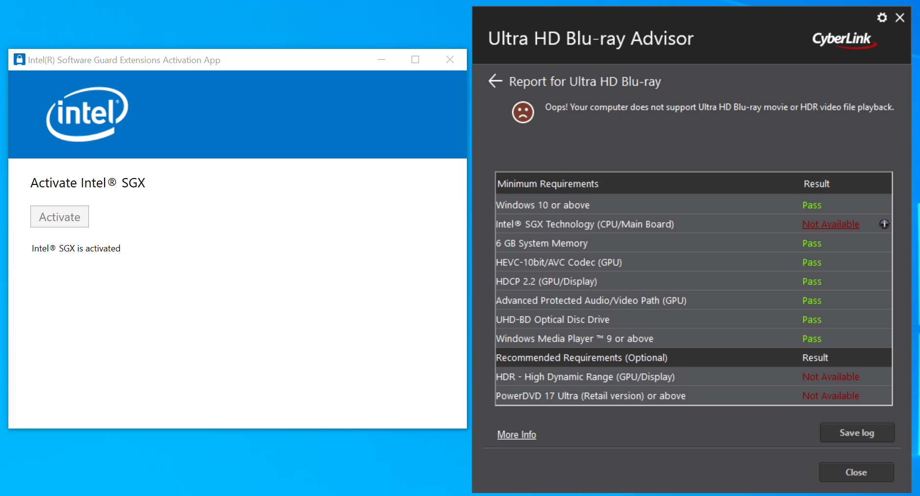

I decided the next step was to focus on just SGX, outside of the boundaries of PowerDVD. My first Google query returned a recommendation to run the Intel SGX Activator, a software app available in the Microsoft Windows Store. I had no idea this tool existed, nor about any requirement to run it to enable SGX. I figured that since it was baked into the CPU+BIOS, it should just work. I never would have imagined a need to activate it in Windows. Regardless, I ran the tool, and sure enough I had to go through a couple steps to activate SGX.
Even with SGX now active, CyberLink's Advisor tool still reported it was unavailable. But one thing that bothered me about the Advisor is that it kept complaining that I wasn't running PowerDVD 17 - which is technically true as I'm running PowerDVD 21. How old is this app?!
Screenshot SGX Activator 2.png (231.53 KiB) Viewed 30388 times
On a hunch, I ran PowerDVD 21 again, in my new configuration, and for the first time I was able to play my UHD 4K copy of No Time to Die, yay! There were still plenty of warnings that I didn't have HDR, but otherwise, I was quite happy to have this working.
Because the Advisor still incorrectly reports SGX as not available, I'm not clear which steps above fixed the issue, though likely it was both installing an official UHD drive and activating SGX.

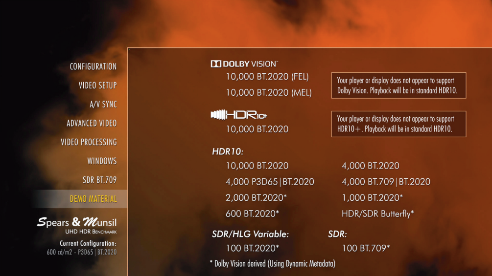

So far I've only read a few lines of the instructions, and only did a very quick calibration, but the Spears & Musil UHD HDR Benchmark disc has proven quite helpful. One of the interesting things I read in the documentation is that they consider projectors to be EDR (Enhanced Dynamic Range) and not HDR, because they just don't have the same dynamic range capabilities as a good LCD or even OLED TV. I think EDR is a really good description.
I mainly used the calibration disc to tweak brightness, contrast, color and tint. Interestingly, the adjusted brightness ended up at -5, versus the +20 I was using when trying to watch Ghostbusters: Afterlife. And contrast ended up at -25, instead of the -2 I had it at before. In general, this made the dark scenes much darker, and I was worried it would make watching G:A impossible. Note that I've since read more of the instructions and I've set the brightness and contrast incorrectly, but it's still more correct now than before.
I then watched the demo HDR content on the disc, which was really interesting. Regardless of which mode you play the demo material, it is the same clip over and over, so you can compare the exact same scenes presented in different modes. They have the HDR available in different peak brightness's, from a high of 10k cd/m2, 4k, 2k, 1k, and 600.
10k was definitely too hot for my projector, and in bright scenes all of the detail was just blown out. 4k was a smidge better, and 2k was almost watchable. 1k looked really good, and so did 600. My projector's at least capable of 600, possibly 1k, tough to pick between the two. Some of the footage was absolutely amazing, and for the first time I'm super stoked about this projector now that I've seen what it can do.
Interestingly, there was also a "SDR/HLG Variable 100 BT.2020" test, and as soon as I saw it I recognized the exact same issues as the first time I watched Ghostbusters: Afterlife in HDR. The colors were all crushed and lifeless, and the image was dark and hard to see. I don't yet understand what this means, but my HTPC+Projector does not like this mode, not one bit.
Curious how the new calibration would affect the movie, I played a couple scenes of Ghostbusters: Afterlife again. One of the first scenes in the G:A movie is of a completely invisible ghost walking across a dirt field in the middle of the night. Dark brown dirt, dim lighting, and all you can see are the footprints as the ghost walks across the field. This was easy to see in SDR. The first time I watched this in HDR, I couldn't see anything, so I knew the settings were off. But this time, after calibration, I could actually see the footprints again. Not quite as clearly as in SDR, but still very visible. I watched a few more scenes, and I no longer felt like I was seeing the same weird, crushed colors as I saw the first time.

I did another round of calibration last night. I started out calibrating on SDR. I initially did this with HDR still enabled in Windows, and the projector still said the signal was HDR, even though I was using the SDR test patterns. This felt like a mistake, so I disabled HDR in Windows then did the SDR test patterns.
I noticed that I was seeing significant clipping/crushing in both black level and whites. Essentially, I was only seeing 16-239, instead of 0-255, when using the SDR patterns. I've had this problem before in years past, but until now all my HTPC's have been AMD GPU based. I know how to fix this on AMD, but Nvidia is new territory for me.
I went into the Nvidia settings and found that with the 4:4:4 color space, "limited" was the only option. I changed back to RGB and was then able to select "full" for 0-255, but this didn't seem to change anything on the test disc. I then found separate Nvidia settings for Video options, and I set that to full range too. This did have an effect, as I was then able to see a black/gray checkerboard in the test pattern, but this seems like Nvidia replacing sub-16 values with a checkerboard pattern, so I wasn't able to actually see those values from the test disc - really disappointing.
Anyway, I completed the SDR calibration using the Limited 16-239 range, then switched back to HDR and did those calibration steps. One thing I noticed is that the projector seems to be storing the calibration separately for each mode, so the HDR settings are independent of the SDR settings. I guess this is nice, each one gets perfectly calibrated individually. But the HDR mode blocked me from adjusting color and tint, which seemed really odd. I know I adjusted these values recently, and I thought I did that in HDR mode, so I'm not sure why I was getting blocked this time. Now that I think about it, it's probably because I set the HDR color temp to "Cinematic/Film", I'd probably have to select a User profile to be able to adjust color and tint.
This time through, I paid attention to calibrating Gamma, making sure it was 2.4. I think this has made a nice improvement, as I'm seeing more shadow detail. Need to go back and rewatch a few Ghostbusters: Afterlife scenes to be sure.
